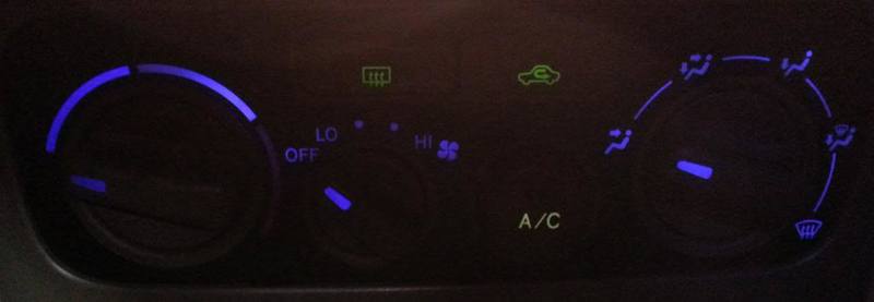

I recently changed my bulbs in my car's HVAC dash to LEDs. I wanted a blue color and it looks really good and exactly what I wanted. The only problem is that there are three buttons that are lit separately from the new LEDs by green bulbs, which I want to be blue as well, but I cannot simply change those bulbs (they are hard-wired in, not a plug-in-play bulb socket). Since I cannot change the bulb, my idea was to add a translucent color paper to the little "window" that displays the color on the button, but I don't know what color(s) to use. Basically, in other words, what color paper can I use to make green light turn to blue?
To make matters more complicated, the temperature select button has a blue, white and red selector. They are all "supplied" with light from the new blue LED. Obviously the blue works, but the rest is all blue, which means I have one long blue strip, rather than three segmented colors. I would like to do the same thing with the color paper to get to white and red. I'm thinking for the white, I can add green and red paper together to make the white (the three primary colors together)? What about the red?
Can any of this be done, or is there another way of going about it?
Here is a picture of my dash for reference. I can add more pics if necessary. You can see the two green color buttons and the one yellowish-green button as well as the temp. select, which is trying to be blue, white and red, but is mostly blue.
I appreciate the help, thanks!

If the bulbs are not green, and the color is provided by the filter, then changing the filter may be an option. If they are green LEDs then a filter over the green will just make it a dimmer green or not show at all.
Note - even hardwired lights can be swapped out - you just need a soldering iron.
There is no filter currently, only a clear "window" where the light shines through. The LED itself is green on these buttons. So I cannot add a filter to the "window" to change the color? It will only dim the bulb?

The left side and right side of the controls each has its own separate bulb. From the factory, each side had one white bulb with a green "bulb cover" to make the light on the button look greenish-white (similar to the green that I am trying to change now).
I had an idea: what if I go back to pure white LEDs and then add the color paper where I want, in the color I want (since white is all colors, the filter will show the color I want in that spot). This will work at least for the red, white and blue temp. selector. Still doesn't fix the green buttons.
A green light only emits light in the green part of the spectrum.
A blue filter only allows through light in the blue part of the spectrum.
Since a green lamp produces no blue light the result of a green bulb and a blue filter is black.
In practice a green lamp will produce some blue light but not much or it would look bluey-green without a filter.
So, basically the only way I can get the color I want without changing the blue bulbs would be to add a bulb of a specific color to the area where I want it.
Thanks for the help, now to go back to the drawing board!
...what if I go back to pure white LEDs and then add the color paper where I want, in the color I want (since white is all colors, the filter will show the color I want in that spot). This will work at least for the red, white and blue temp. selector. Still doesn't fix the green buttons.
That would be your most practical way forward ... the only practical way to change the color of the green lights is to replace them.
