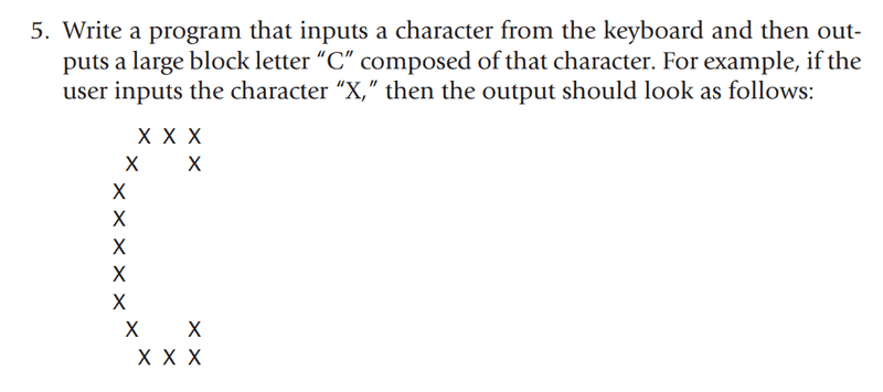

I want to make a program that takes strings as input. eg: physicsforums. And writes that using x'es.
example c of physicsforums should look like this.
I've written the program for this.

But I want to generalize? Any guidance available?

IMO, generalization is the wrong way to go. The example letter, 'C', in the problem displays a large version of this letter in a 9 row by 5 column grid of 'X' characters and spaces.
Instead of using a complicated if statement, I would use 9 x 5 two-D arrays consisting of 1s and 0s, one for each letter. Given an input character, I would have the program look up the appropriate array in the data section and then use a nested for loop to print 'X' wherever the array contains 1, and a space where there is a 0.
A program like what I've described will have a very short code section, but a large section of data for the arrays, possibly an array of 9 by 5 arrays.
For starters, write a program that will print a large-form A, B, or C. You'll need to do a fair amount of work by hand using some graph paper to see how to fill in an array for each letter. You could do the same thing for the Nepali alphabet, but you might need to use larger array (10 x 10?) because the Nepali letters seem to have more curlicues than the Roman letters used in the English alphabet.
Or use 9x5 arrays of characters, each position containing an 'X' or a ' ' (blank space).
If I were doing this myself, I'd use a std::vector of std::strings, each string containing a row of the 9x5 matrix. I stopped using C-style arrays in C++ probably 25 years ago.
