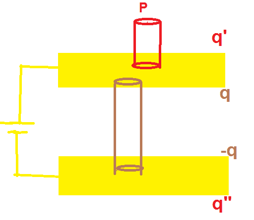

Choose the correct options.
Each plate of a parallel plate capacitor has a charge Q on it. The capacitor is now connected to a battery. Now,
a) the facing surfaces of the capacitor have equal and opposite charges.
b) the two plates of the capacitor have equal and opposite charges.
c)the battery supplies equal and opposite charges to the two plates.
d) the outer surface of the plates have equal charges.
Gauss's law: $$\oint \vec E\cdot d\vec A= \frac{ q_{en}} {\epsilon_0}$$
a) if I take a Gaussian cylindrical surface whose circular area are present in the meat of the two plates of the capacitor, then the electric flux through this Gaussian surface is zero ( as the electric field inside the meatof the capacitor is zero and between the capacitors, electric field is perpendicular to the cylindrical surface).
So, charge enclosed by the Gaussian surface is zero.Hence the two facing surface of the capacitor have equal and opposite charges.
b) each plate of the conductor is equipotential. Hence the surface charge density on the inner surface is equal to that on the outer surface. Hence the two plates of the capacitor have equal and opposite charges.
c) to hold b) true the battery has to provide unqual and opposite charges to the two plates.
d) the outer surface charges of the plates have to be opposite.

Taking the brown cylindrical surface as the Gaussian surface and applying the Gauss's law and considering the fact that electric field inside the material of conductor is 0 gives that surface charge densities on the facing surfaces are equal and opposite. Hence, the charges on the facing surfaces are q and -q.
Now, for outer surface, Electric field at P is calculated first using the Gaussian surface and applying Gauss's law and then, due to all the charged surfaces individually and then the two expressions are equated. $$ \frac {q'}{A\epsilon_0} = \frac {q'}{2A\epsilon_0} +\frac {q}{2A\epsilon_0} +\frac {-q}{2A\epsilon_0} +\frac {q"}{2A\epsilon_0} $$ $$q' =q" $$
Hence, the inner surface charges of both plates are equal and opposite and the outer surface charges of both plates are equal and same.
The battery doesn't supply the charges. It creates the potential difference across the plates. As a result, electrons of plate at higher potential move towards plate at lower potential creating inner surface charge q and -q.
Now, the conservation of charge gives, $$ q' +q -q+q' = 2Q \Rightarrow q' =Q$$
Hence, the correct options are a, c and d.

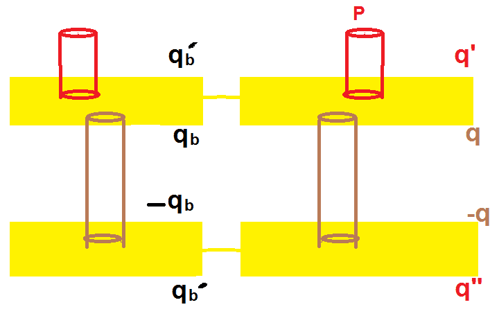

I agree with your answers, but it is not clear that ##q'=Q##.
If we think of the battery as a charged capacitor, it would acquire some of the Q on each side, and now be carrying a net charge.

Let's say that the battery capacitor has capacitance Cb, initial charge Qb, and potential difference Vb and the capacitor has charge Q on each plate.
After the connection and coming to equilibrium, the system has the charge configuration given in the figure and potential difference V'b.
Calculations similar to those in post #9 show that outer surface charges on the plates of battery are same.
Now, $$ q_b = C_b V'_b ~~\text{and}~~q = CV'_b$$ $$\Rightarrow q = \frac {q_b C}{C_b} ~~\text{and} ~~q_b = \frac{Q_B}{1+\frac C {C_B}}$$
So, after the connection, potential difference and facing surface charges of each plate changes.
The charge Q, too, redistributes on the outer surface of all plates as the connecting plates of the battery and capacitor are equipotential. Could you help me in finding the distribution?
On the other hand, an ideal battery is supposed to maintain the potential difference. Here, the potential difference changes. So, the capacitor battery is not an ideal battery.
