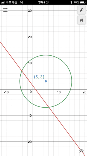

The line "4x + 3y -4=0 " divides the circumference of circle centred at (5,3) in ratio 1:2.whats the equation of the circle
2πr
Distance of a line from point
Radius of general circle
I tried finding the distance of the centre from the chord.
Then i made a relation between radius and common factor of the ratio between the two circumfernce divisions
And now I am stuck :(

If you assume the central angle of the triangle made by the two points which the line and the circle and the center as alpha , the area of it will be:
Then you can use the conditions mentioned to calculate the area of this triangle,then calculate
the radius by the equation above.

The graph given by @Young physicist in post (#4) is not necessarily to scale, but ifs clear that when you consider the x and y intercepts of the given line, the radius of the circle needs to be much greater than 2 to have any points in common with the given line.
Just giving a general concept:wink:
This diagram is pretty much on the mark. I would print it out and then draw the line from centre of circle to (calculated) midpoint of the chord. Mark the angles you can obtain from the circumference ratio and the rest should be simple trig!

Okay so here's what i did.
So first i calculated Arc Length
Now the ratio of circumference is 1:2.
Let the common factor be x
S = r θ where θ is central angle of the minor arc
x =r ×θ...
X/θ = r (1)
Lets look at major arc
2X = r ×(2π-θ)
2X= (X/θ)(2π-θ)
2θ=2π-θ
3θ=2π
θ =2π/3
Converting to degrees we get (2 ×180)/3=120°
(Not 60 as i previously screwed up in calculations)
Likes YoungPhysicist
Now let's look at the distance tween cente and the line
This is given by | (ax + by + k)÷(root of (a2 +b2|
Where a b and k are constants in the equation of line and x and y are coardinates of the point
And" | | "represent modulus
With that we get
| (4 ×5 + 3×3 -4) ÷ 5| = 5(not 1 as i previosly did)
If we look at that triangle and use angle sum prop
We get Φ +Φ +120 = 180
Φ=30
Hence now we can finaly find radius
By using sin 30 =opposite side÷hypotenuese
(1/2) =(5/r)
r =10
With this we can use the formula for radius
g2 + f2 +c = 10
Where -g and -h are coord nates of centre
25 +9 +c =10
c= -24
And now that we have all unknows the equation of general circle
x2 +y2 + 2gx +2fy +c =0
Hold on i made an error
The formula for radius is g2 + f2 -c = 10
Hence r = -24
Anyway so equation of circle is
x2 +y2 -10x -6y -24 =0

I checked the answer given and its not matching
We r suposed to get
x^2 +y^2 -10x -6y -66 =0
Navin said:
We r suposed to get
Any ideas ?

That's good !
Also, the distance from (5,3) to the line 4x + 3y − 4 = 0 is indeed 5, as you found.

That looks O.K., unless I'm missing something.
Also ##\ \displaystyle \cos\left(\frac{\theta}{2}\right) = \frac{5}{R} \ ## should work, for θ = 120°.

I would use the following for the formula of a circle, radius R and centered at point ( h, k ) :
## \displaystyle (x-h)^2 + (y-k)^2 = R^2 ##​
To get the equation in the form you want, expand the those squared terms and simplify.

After looking at this again, shouldn't this be radius squared?
## (-g)^2 + (-h)^2+c = R^2 \,,\ ## where g and h are coordinates of the centre and R is the radius. In your case, R = 10 .

It will be
100 -24-9
=100-33
=66
...yep so the value of c is 66
Hence the circle will be
Yay ! FINALY !
