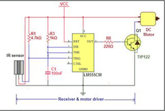

Hi everyone,
I am a complete beginner when it comes to circuit analysis that involves anything more than a few resistors and capacitors. Currently, I am working on a project that requires the transmission and reception of IR signals to control a motor. I know the requirements for the motor I must use and the amount of voltage I am able to work with. My question is, will the voltage have any effect on the frequency output of the 555 timers? In addition, I'm having trouble selecting the correct transistor to provide the right amount of power to the DC motor. Any help is much appreciated!
Here is the picture for the schematic that I am working off of:
I am fairly comfortable with how the 555 time operates in astable and monostable configurations. I'm just having difficulty calculating numbers.
it shouldn't do so unless the PSU cannot supply the voltage and more specifically the required current so that the Vcc rail voltage doesn't sag when the motor is running under load ... I would also be adding some bypass capacitors on that Vcc rail so that the 555 doesn't get spike noise from the motor
it needs to be able to handle the current that the motor you choose requires ... you have given no info on thatDave
Try to avoid controlling the Vcc power terminal of an LM555. One improvement to the transmitter circuit would be to gate the second LM555 with it's RST input rather than the Vcc power supply terminal. When an LM555 switches it takes a short but high current spike from the supply and so needs a bypass capacitor on Vcc. That upsets the internal voltage divider and comparators. If the Vcc is hanging off another LM555 then you cannot use a bypass capacitor on Vcc of the second LM555.
You might also use the open collector Discharge output from the first LM555 with a pull-up resistor to Reset on the second LM555. Those changes will give better regulation of output frequency.

Also, I'm working with a 4.5 V power source and will use a potentiometer to control the frequency/pwm.
@Baluncore
I'll look into those other methods as well. I'm still getting use to 555 timers and the different modes of operation that they have. Thanks for the suggestions!

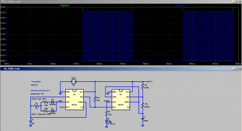

You could download a free copy of LTspice from; http://www.linear.com/designtools/software/
Here is an LTspice model of an example IR transmitter with the example output shown.
I left out the bypass capacitors but changed the gate method.
All the attached files are text files inside, but need a txt extension to attach to this post.
You will need to remove the .txt extensions from the attached files to use them.
The .asc and .plt files go in your working directory.
The .sub and .sym files for an idealised NE555 need to go in the installed library directories.

Wow, I can't explain how much this helps out! Being able to see the pwm signals being modulated is extremely informative. If I want to experiment with different bypass capacitors would I get rid of the gate and place in varying capacitors. I ask because currently I do not see any noise.

To simulate supply noise I would add some resistance and inductance to the Vcc1 voltage source. There are no big circuit currents with the gating circuit I used in the example. The NE555 model I used is idealised, so it is simple and computes fast. I would test the real circuit rather than load a more realistic model of the NE555.

R4A and R4B make the 10k pot. The “.param pot 50” is the 50% position. Edit that “50” to test other duty cycles. The two {equations} are the resistance values that make the two sides of the potentiometer.
They are drawn next to each other since they are used as variable resistors in this circuit. The diodes make sure that current only flows through one side of the pot at the time. If it was a voltage divider I would have drawn them end-on in series,, more like a typical potentiometer.

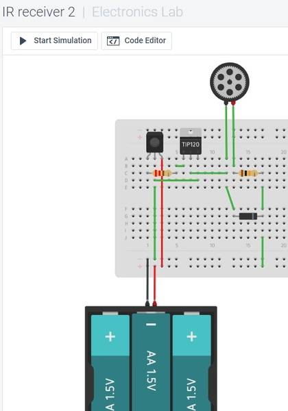

1)
So I decided to visually wire up the schematic on a breadboard so that wiring up a prototype is easier.
Here's what I have so far:
https://circuits.io/circuits/3383536-ir-transmitter
One question that I have is in the wiring of the potentiometer. I'm pretty sure the wiper should be in series with the 1k resistor but I don't know if the other two pins are connected correctly. The led does light up when I run the simulation, but I just want to double check my work.

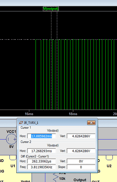

For the lt spice simulation I'm getting interesting values for the frequencies. After probing and measuring, I am getting a value of 3.8 kHz for the output square wave. Is there a correct way to go about measuring the frequency of pwm in lt spice? Thanks
The pot, 1k0 and diodes on the breadboard look OK to me.
The first cycle of a burst produced by an NE555 often has a stretched first cycle because the capacitor must be charged from zero to 2/3Vcc, rather than 1/3Vcc to 2/3Vcc. So avoid the first cycle, measure the period of a later cycle.
First zoom in on a couple of later cycles of the signal. You could do that with the mouse on the plot window, or by specifying the transient analysis simulation time and the time to start recording data.
Select two cursors for the trace. Place cursor 1 on a rising edge, then cursor two on the next rising edge. Read the Freq. If rising edges are irregular, try falling edges.
Or measure over ten cycles to average the period, remember to multiply the frequency, or divide the period, by ten.
Perhaps I am not using the correct method or not placing the cursors at the right location. However, my values always end up being around 3.8 kHz. The readings are even less if I try measuring more cycles.

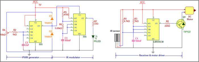

Baluncore said:
I suspect it would be best to use a re-triggerable monostable configuration.
Can you please attach a clearer circuit of the proposed IR receiver to your next post.
As you mentioned, the 555 timer is configured in the monostable mode. The purpose is to demodulate the input signal to it's original pwm duty cycle wave form. From what I understand the low pulses generated by the IR sensor are the trigger for the 555 timer. The output is configured to be slower than the input pulses thus changing the 38 kHz frequency back to original pwm.
How would an opto-isolator work in place of this? Thanks!

I am not sure why you have trouble, but 3.75kHz is about right. Try displaying a shorter period of time by editing the .TRAN script to show only a very short time with two positive edges.
Yes, changes it back to the PWM envelope of the signal. But your monostable is not retriggerable.
Attached is a “retriggerable monostable” version using the NE555. It fills in the gaps between the gated carrier pulses and so prevents gaps of drive to the motor. I think you will see those gaps if you modify my model back to your circuit by removing the PNP transistor.

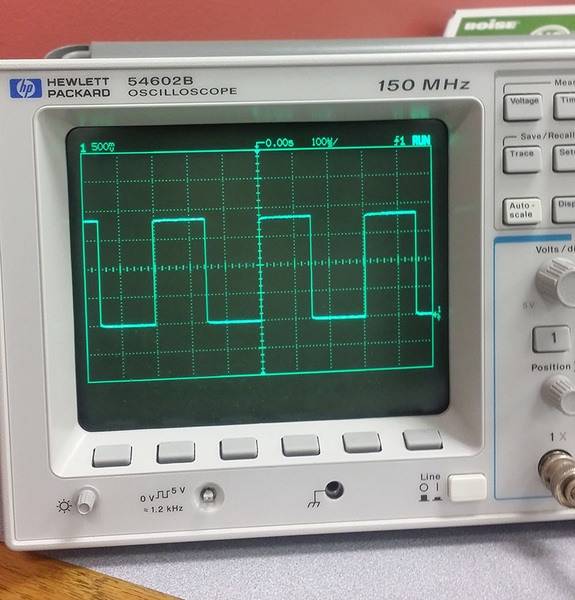

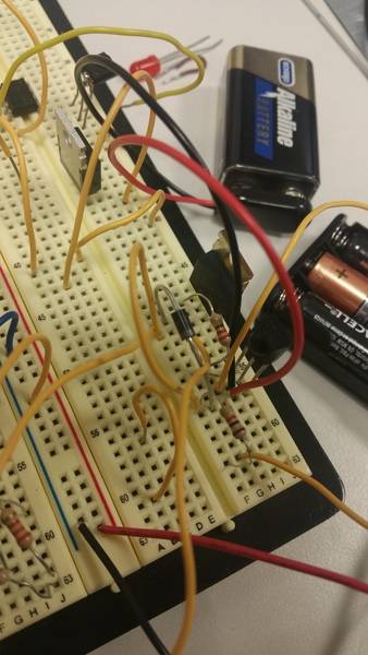

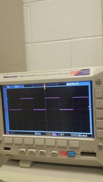

Also, here's an update of progress. I managed to breadboard the circuit and gain access to an oscilloscope.
Here's some results:
After some calculating the cycles vs time period the frequency was found to be about 3.3 kHz. It does make sense that the frrequency is not 3.75 kHz as shown in the simulation because I had to use different resistances (R1= 330 ohms & R2=2.2 kilo ohms). However, it also deviates from the theoretical frequency of an astable timer. The calculated output frequency should be 3.05 kHz. Is there any explanations for this difference?

I have changed the motor drive to a logic level MOSFET because it is more efficient than the darlington which wastes 30%, 1.5 volts of the 5V available. I used the IRFH6200 because it is in the standard LTspice library, I would use something cheaper in reality.
Baluncore said:
To change from 3.78kHz to 37.8kHz, try simply changing Ct from 100nF to 10nF
This is actually one of the things I tried while I was in the lab. I forgot to take a picture but I measured cycles that ended up giving me around 45k0 Hz. That was using a 10nF capacitor and 330 ohms for R1 and 2.2 kilo ohms for R2. Based on my calculations I should be getting around 30 kHz instead. I know there is some error in reading exact values from the oscilloscope, but is there another reason that could cause this discrepancy?

The Nchan MOSFET in my circuit has a 10R series gate resistor to prevent parasitic oscillation.
I trimmed the carrier frequency closer to 38 kHz. Use .TRAN 0 12m3 12m to see ten cycles for frequency measurement.
I removed pullup resistor from DIS of U1 and now take gate signal from OUT of U1, to RST of U2.

When I opened the schematics you sent before it said that I didn't have the darlington transistor. However, I have all the components for the updated schematic you sent. You mentioned before that the darlington wasted 30% voltage. Could you explain to me why this is the case? Also, how would you go about determining which mosfet would be a good fit as a cheap alternative?
A MOSFET can now have a very low resistance when switched on, often 0.1R or less. That will drop very little voltage so there is more for the motor. This is especially true for low supply voltages. A darlington pair must drop at least one Vbe, base emitter voltage, say about 0.8V when on, so only 4.2V of the 5V supply remain for the motor.
See; https://en.wikipedia.org/wiki/Darlington_transistor
And; https://en.wikipedia.org/wiki/Darlington_transistor#Disadvantages
The complementary darlington, or Sziklai pair, overcomes some of the loss by overlapping the Vbe, so only Vsat remains.
The specification of the motor switch MOSFET and flyback diode will depend on motor specification and selecting a MOSFET with Vgs(on), if possible, to work directly with the output voltage from the IR RX module.
Once you know your needs, the best way to select a MOSFET is with the selection filters available on some suppliers sites. Then sort by price.
Try this; http://au.element14.com/mosfet-transistors-lt-600v

Based on some results from an oscilloscope, it seems that the transmitter is working. from the first 555 timer I am getting a square wave with a pwm that is controlled by the potentiometer. Furthermore, the second 555 timer is outputting a square wave at around 38 kHz which is perfect. However, after using a test led I found that the light is constant. The led does not pulse when the potentiometer is turned.
Should I be able to see this pulsation?
Thanks
Can you please remind us, which circuit you have built ? A post number or filename would help.
If you have a dual channel CRO you could look at, and synchronise to, the PWM envelope from the first NE555. Then with the second channel, look at the transmit LED. You should see many rectangular pulses filling the PWM envelope.

I am still working off the same schematics as before. Thus, the IR_TX_RX_8 model you sent is a good representation. I have some video of the circuit and the LED which I'll try to upload.

Alright, I finally got a chance to upload some videos of the circuit in action!
I can't tell why I'm not getting the correct output for my second 555 timer. I have double checked my wiring and everything seems fine.
As shown by the videos the first 555 timer works perfectly, but the second one is not receiving the envelop signal. Instead it's outputting just a constant frequency
  • #32
Sorry, but I don't have the bandwidth to watch videos over my internet radio link, and I do not know how to download your embedded video files to my system once. Maybe if they were attached as files or I had the link I could do it.
So you reported that the output, pin 3 of U2 is a continuous 38kHz rectangular wave.
That means pin 4 of U2 being held high.
1. Check the signal on the variable duty-cycle output, pin 3 of U1. Does in vary with pot position? Or is it always high?
2. Check the signal on pin 4 of U2. Is it the same variable duty-cycle envelope? If not, why not.

Hey, so just a quick update. I realized the problem with my circuit and why the envelope was not working. I was mixing the old schematic with the new one and I had a few wires in the wrong place. I believe I have fixed it and am now seeing the envelope, which is awesome. Now I just have to fine tune the frequency and test the sensor out.

Update
Since last post, I've made progress in sending the IR signal to my sensor. I am getting a visible PWM square wave that corresponds to the position of the potentiometer. However, I have not been able to drive the motor with my current setup. The schematic that I am using is a simplified version of the "IR_TX_RX_8" circuit. Here is a picture of what it looks like:
I removed the 555 inverter along with the extra transistor because I noticed that the output of the IR was already correct
Probing the signal of the IR sensor on an oscilloscope produced this square wave:
I tried to use this signal to drive the motor as such but I have had no luck.
Any ideas of why this circuit would not work?
