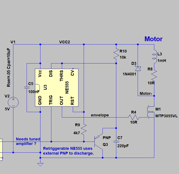

You are not butting in, you are welcome. You see the things that I miss. I never seem to need bypass capacitors in my LTspice models.jim hardy said:Not meaning to butt in your great conversation - just a thought to consider here...
I didnt see bypass capacitors across motor or Vcc , maybe i just missed them...
True, they are noisy, but if you add parallel capacitance to the inductive motor then you need another inductor between the motor and the the PWM drive transistor. Don't forget you must have the parallel flyback diode over the inductive load to protect the driver transistor.jim hardy said:Brushed motors are electrically noisy critters. Try a .1 or 1 uf right across the motor terminals, and a hundred or so across Vcc to circuit common.
First as Jim's suggests, check power supply bypass capacitors, and a place a 0u1F between ground and Ctrl pin of the NE555s.enJayneering said:When I try to run the motor at a high duty cycle it keeps quitting. I imagine it's because of a timing issue of the 555. Can you think of any reason why this could be the case?
Next, if that has not fixed it, check the output current capacity of the power supply.
Spikes on the supply get blamed for lots of deviant behaviour and encourage paranoia. You can only be sure it is not spikes by swamping the supplies with capacitance during testing. To identify supply problems, monitor the power supply voltage while testing the circuit at high duty-cycle.jim hardy said:'Noise' gives baffling symptoms.
