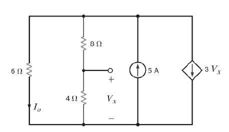

I need to find the voltages (if any) and currents of these circuit, but particularly Io
I do know that I have to use KCL bot I don't know how, can somebody help me with a node or somethinghttps://www.physicsforums.com/attachments/c2-jpg.80412/
I do not have any other info apart from this image
KCL
I don't know how to tackle this problem
I think by KCL
-Io = -I(Vx)+5A-3Vx
but not sure
and how do I find Vx? is
Vx=I(5 amp)*R(4 ohm)=5*4=20 volts ?
then the dependent current is 3*20=60 volts? but is current it should be on ampere not volt
or should I solve the resistors and get Req
1/ (1/(8+4)+1/6) = 4 ohm = Req
there is one node on the top and another one on the bottom, but that one is ground, so shoul I transform the current source and the Io resistor into a voltage source?

you are on the right track
-Io = -I(Vx)+5A-3Vx There is an error in this equation.
Remember that in most cases you must have one equation for every unknown.
This implies that you might have to apply Kirchhoff's laws one more time (seeing as there are two unknowns).

so my node is 5 (the current source) = Io (the one I need to find) + 3Vx (the one with the dependent source) + I1 (the one with the 8 and 4 resistances)
5=Io+3Vx+I1
I1=Vt/12
Vt=V(in 4)+V(in 8)
Vt=Vx+2Vx
Vt = 3 Vx
I1 = Vx/4
my unknowns are Io and Vx,
5=Io+3Vx+Vx/4
I really have no clue where is the other equation

I see 3 voltage nodes. If you reference one as ground, the other two are unknown.
