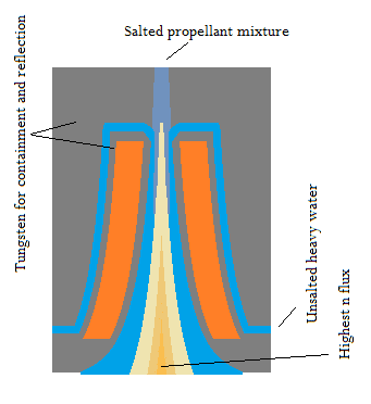

Had been talking NSWRs on a spaceflight forum and a thought occurred to me. Lithium-6 fission can be triggered with relatively low-energy neutrons and releases 4.78 MeV, a helium-4 atom, and a tritium atom. Without a neutron flux, however, lithium-6 is completely stable.
With a small electrically powered neutron source and a magnetic nozzle, a lithium-hydride-fueled thruster could have specific impulse approaching 3% of the speed of light, making it an extremely promising low-thrust engine. But that's not what I'm interested in.
In order to generate significant thrust, you need a high neutron flux...on the order of what you get inside a nuclear reactor. So why not?
Natural uranium cannot sustain a chain reaction without a neutron moderator. Thus, a mass of natural uranium inside a tungsten vessel (for neutron reflection and for containment) is quite safe. Add a neutron moderator, however, and you'll get a chain reaction and very high neutron flux.
Lithium hydroxide dissolves in water at 129 g/L. If you dissolved enriched lithium-6 hydroxide in heavy water, you would have a propellant with a density of 1,239 kg/m3 which, when pumped through a natural uranium cylinder, would immediately moderate neutrons, trigger a neutron flux, and undergo clean fission from that neutron flux. The reaction is inherently self-limiting, as the water is converted to steam by the lithium fission energy and thus stops moderating the neutrons. Such a propellant mixture has a theoretical exhaust velocity on the order of 2,000 km/s.
The propellant serves as the reactor coolant, the moderator, AND the fuel source:
This design avoids the problems with a nuclear thermal rocket because the reactor pile only needs to get excited enough to generate a high neutron flux, not generate the energy to heat the propellant. It also avoids the "giant nuclear bomb tank" and "fissioning radioactive death spray" problems inherent in an enriched uranium saltwater rocket a la Zubrin. There are also no moving parts anywhere close to the nasty bits.
If water proves too corrosive, then you could use lithium-6 hydroxide dissolved in ethanol with a graphite suspension. Varying levels of coolant performance, neutron moderation, thrust, and specific impulse could be achieved by mixing pure heavy water or pure light water in with the saturated saltwater; this could be done dynamically at the turbopump since none of the propellant components are particularly dangerous.
I foresee a few major challenges. I chose natural uranium since it is cheap and safe, but it may require a very high mass to achieve moderated criticality, which would put a high threshold on engine size and thrust. A different fissile neutron source might be better; I don't know how far down you can scale something like the HFIR. Also, you don't really want your propellant directly in contact with naked fissile material, so you'd want to have the fissile material separated from the propellant by some material that is neutron-transparent and has high strength and heat resistance but is also thermally conductive. Refueling the fissile mass would be tricky if you wanted to reuse, though I could conceive of a replaceable fuel rod arrangement.
The exhaust isn't entirely safe; it releases a good bit of tritium. But that's far, far better than the nucleotides released by a uranium NSWR. Basically, you don't want to be anywhere near this exhaust stream (not the least of which because it will melt any launch pad) but it shouldn't be prohibitive. It may be useful to include a supercharger to mix atmospheric air in with the exhaust stream to increase thrust and reduce the energy level of the exhaust.

I depicted a conventional de Laval nozzle for convenience, but you're completely right; I would almost definitely need a long cylindrical reaction chamber with a convex-section diverging nozzle. It won't have the near-perfect efficiency achievable by a properly choked converging-diverging nozzle, but nozzle design here will be less about efficiency and more about not blowing up.
Erosion/evaporation of the uranium is a big no-no. That's why I said "You don't really want your propellant directly in contact with naked fissile material, so you'd want to have the fissile material separated from the propellant by some material that is neutron-transparent and has high strength and heat resistance but is also thermally conductive." Upon review, this could simply be a thinner layer of tungsten; it should let enough neutrons through if it's not very thick. Other materials could potentially be better, though. Erosion and heat flux can also be mitigated by using a boundary layer of unsalted water.
Using a convex-section diverging combustion chamber as the nozzle will focus the highest neutron flux near the nozzle throat, which will further reduce heat flux within the chamber and keep the point of highest fission rate well away from the point of highest chamber stress:

It does not matter which solid material you use. Ions impacting with MeV energies impacts will always erode the surface. A liquid (and evaporating) material might work, but probably reduce thrust per reaction mass massively.
I absolutely want the fission products to be thermalized. MeV energies are far, far too high to handle; distributing this energy to the oxygen and deuterium in the heavy saltwater reduces the velocities well out of the relativistic range while massively increasing the momentum and therefore the thrust.
Adding the annular unsalted-water flow will do the same, increasing thrust-specific propellant consumption (because the unsalted heavy water now counts as part of the propellant) but significantly increasing thrust/weight. We are looking at a specific impulse thousands of times greater than the best chemical rockets and hundreds of times greater than the theoretical limits of solid core NTRs. Diluting the propellant mixture with more reaction mass is not going to be a problem.

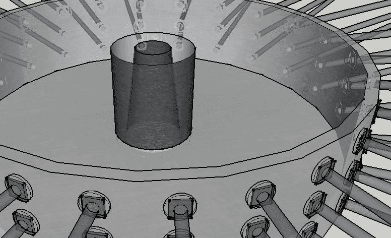

What about using some kind of neutron multiplier that would be consumed by the reaction?
A sufficiently active layer or layer set of neutron multipliers might even make a D-T fusion deuterium ion accelerator design feasible.
The required neutron flux would make your uranium explode in milliseconds. You cannot both use uranium for neutron production with a low fission rate and lithium for neutron absorption with a high fission rate. It just does not work.

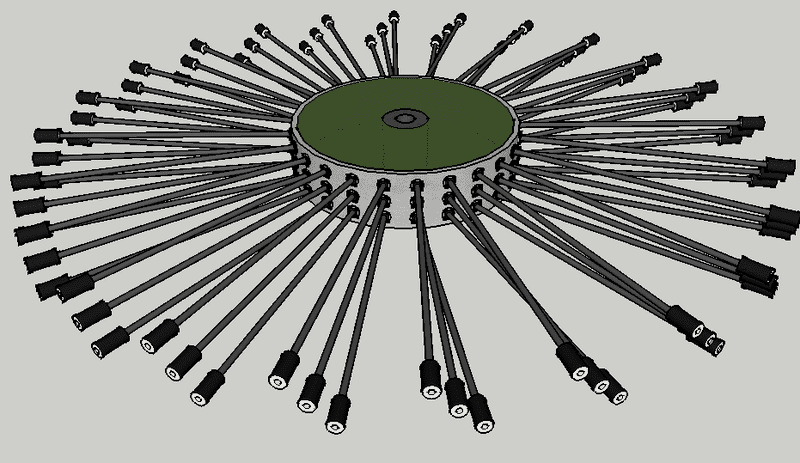

I was thinking less along the lines of uranium and more along the lines of an accelerator-to-target design. I don't know whether there are any large isotopes which can be triggered to release numerous thermal neutrons at once when struck by a fast fusion neutron, but if so, then these could be used to multiply the yield of a D-T accelerator. Another possibility would be spallation; spallation sources routinely produce beam fluxes on the order of 1017 neutron/cm2*sec. If these could be multiplied (perhaps focusing the proton beam onto an initial mercury target with a tantalum or depleted uranium cylinder at the center, as shown in the attachments) by a few orders of magnitude, it could become feasible to create the desired neutron flux.
Discussion on forum.nasaspaceflight.com already focused on the main problem: you need a neutron source which is too good to be true. But do not despair. You stumbled over one of the most promising engine ideas for interstellar travel - a fission fragment rocket. The problem is, how to let some significantly nonzero fraction of fission fragments leave engine and fly as exhaust without damaging the engine, and without much thermalization? (Any fission will do, no need to be fixated on Li).
