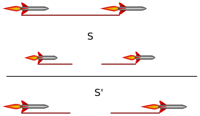

I believe length contraction always makes more sense when integrated with reminders of relativity of Simultaneity.
Let's say the engines are at the back end of each rocket. For the viewer "A" in the initial frame, they begin moving and continue accelerating simultaneously, and clocks next to the engines are seen in synch.
However right away, "A" will measure that for each rocket, a clock by the engine is running faster than the clock by the head of that same rocket. I have never seen this pointed out in a discussion of this paradox, and I think that this may be one reason people so often are mistaken about this situation. The idea that "both spaceships accelerate and keep their clocks synchronized" to "A" distracts the reader and puts one in the mind of a situation without SR. The reminder that within each rocket, the clocks appear out of synch to "A" might snap the view back to SR.
We might attempt to apply this same logic to the rope, but right away we run into a problem, since the back end of the rope is connected to the front of the back rocket, and the front of the rope is connected to the back of the front rocket. If the back end of the rope was accelerating in synch with the backs of the rockets, the rope back clock could not be connected to the back rocket front clock, since they are out of synch. And the similar applies to the front of the rope being attached to the front ship back clock. We are asking of a suggested nonstressed rope that it fulfill contradictory requirements.

That drawing nicely illustrates that the contraction of the rockets can be made totally irrelevant. If the rockets as drawn there are made with some technical means to have a "proper stretching" such that they do not length contract in the original rest frame, it will make no difference at all for the breaking of the string.

It doesn't matter how long the rockets are compared to the rope/space between them. If they contract, it will put stress on the rope. Why does this not happen with the 2nd-frame-train? Everything contracts together. The scenario here has been designed so that they whole getup can't contract *together*.

:bugeye: Please look again carefully at the Wikipedia sketch. Once more: as pictured there, Bell's example is insensitive to length contraction by the rockets.
It sounds as if you are bugged by the bug that bugged Bell's colleagues. Material objects length contract with their increase of speed, but their speed increase cannot affect the space between them.
If we set the string up for "proper stretching" as well, it won't break.
:bugeye: The point of Bell's Spaceship example is that the string undergoes "proper stretching" so that it breaks...

The ships are shortened, and while the distance between the backs of the ships remains the same to original observer, the ships are shortened to him, and so the distance from the back of the front ship to the front of the back ship is shortened
The breaking of the rope has nothing to with the contraction of the ships in the original rest frame. The rope is attached to points on the ships which have a constant distance in the original rest frame, but it still will break.

It's definitely related to relativity of simultaneity. As I suggested, instead of doing continuous acceleration, you can imagine the rockets having a schedule:
