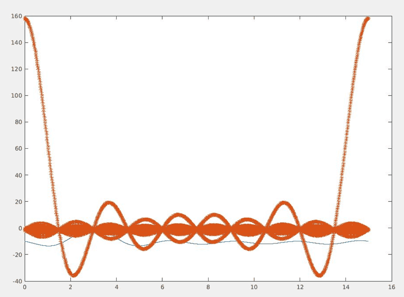

MATLAB Closed form not the same as the discrete form
The discussion focuses on the discrepancy between two functions, Z and Z1, calculated in MATLAB, where Z is derived from a summation over time and Z1 is an analytical approximation. Both functions are expected to match at the limiting case when a equals x, but they diverge for other values. The analytical expression for Z1 is referenced from a mathematical source, indicating it should approach a delta function as T approaches infinity. The plot generated shows that while Z meets the expected criteria, Z1 does not, raising questions about the accuracy of the analytical approximation. This highlights the complexities in transitioning from discrete to closed forms in mathematical modeling.

Matlab:
clear;
lambda = 3e-2;
x = 4 * pi/lambda * linspace(eps, 15, 100000);
T = 5e-3;
t = [0:0.001e-3:T] ; % 0.1:1e-3:0.1+T];
u = 3;
a = 4*pi/lambda * u;
for i = 1:length(x)
    Z(i) = sum(-((cos(a.*t) - cos(x(i).*t)).^2 + (sin(a.*t) - sin(x(i).*t)).^2));
end
% Z1 = csc((a+x)/2) .* sin(1/2.*(2.*T + 1).*(a + x)) -1/2 .*  csc(a) .* sin(2.*a.*T+a) - 1/2 .* csc(x) .* sin(2.*T.*x+x)
Z1 = csc((a-x)/2) .* sin((T+1/2).*(a-x))/(2*pi) - 2*T - 1;
figure; plot(x*lambda/(4 * pi), (Z));
hold on; plot(x*lambda/(4 * pi), (Z1), '*');

The above code does two things. one is a summation over `t` and stores it in `Z` for all `x` individually with a for loop. The second thing it is doing is trying an analytical function for the summation in `t` and and just use the vector `x` to find the same quantity as `Z`, but analytically. it is stored in `Z1`. Somehow they both are not the same. The expression of the analytical form can be found in https://mathworld.wolfram.com/DeltaFunction.html equation (41) on that page. There is also a plot representing the function there. However, the MATLAB plot is very different. However, it is interesting to notice that `Z` and `Z1` are the same at the limiting case `a == x`. The plot I get is shown below. It should have a maximum at `a = x`, that is the value it should take at that point is `Z = Z1 = 0` and for the rest of the `x`, it should be less than 0. However, the blue plot satisfies it, but not the red one.

Z1 approaches a delta function as ##T\rightarrow\infty##, you are using ##T= 5 \times 10^{-3}##.
