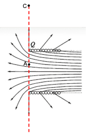

A semi-infinite solenoid with a coil radius ##r## and a winding density ##n## (the number of coils per unit length) is located coaxially with a circular superconducting coil of radius ##R## so that its base is in the plane of the coil. It is known that ##r \ll R## . Initially, there was no current in the coil. The inductance of the coil is equal to ##L##. The current strength in the solenoid is slowly increased from zero to ##I## and then maintained constant. The wires supplying current to the solenoid are arranged in such a way that their magnetic field and their interaction with other elements can be neglected. Let's direct the ##x## axis as shown in the figure.
1. Points ##A## and ##C## are located in the plane of the coil at distances ##\frac{r}{3}## and ##3r##, respectively, from the axis of symmetry of the system. Find the projections of induction ##B_{A_x}## and ##B_{C_x}## of the magnetic field generated by the solenoid at points ##A## and ##C##, respectively.
2. Find current strength in the coil. Which direction is it directed?
3. Find the magnitude and direction of the magnetic interaction force acting on the solenoid from the side of the coil.
Figure: https://ibb.co/R393bBJ
I have no idea how to deal with the problem. Do you have any hints, please?

You're right, but in a previous message I transcribed my approach to a problem, without receiving any response. Of course, I have attempted my own solution, but it does not reach any conclusive point. In the hope of receiving help, however, I transcribe it.
The magnetic field generated by the solenoid at points ##A## and ##C## could be found by using the formula for the magnetic field inside an infinite solenoid: $$B = \mu_0 n I$$, where ##\mu_0## is the magnetic permeability of free space, ##n## is the winding density of the solenoid, and ##I## is the current in the solenoid. Since the solenoid is semi-infinite, we need to multiply this formula by a factor of ##1/2## to account for the missing half. Therefore, the magnetic field inside the solenoid is $$B = \frac{1}{2} \mu_0 n I$$ I don't know how to continue.
The current in the coil is induced by the changing magnetic flux due to the increasing current in the solenoid. The magnetic flux through the coil is given by $$\Phi_B = BA\cos{\theta}$$, where ##B## is the magnetic field due to the solenoid, ##A## is the area of the coil, and ##\theta## is the angle between the normal to the coil and the magnetic field. Since the coil is in the plane of the base of the solenoid, ##\theta = 0##, and we have $$\Phi_B = BA = \frac{1}{2} \mu_0 n I \pi R^2$$, where ##R## is the radius of the coil. The induced emf in the coil is given by Faraday’s law: $$\mathcal{E} = -\frac{d\Phi_B}{dt}$$. Assuming that the current in the solenoid increases linearly from zero to ##I## in a time interval ##\Delta t##, we have $$\mathcal{E} = -\frac{d}{dt}\left(\frac{1}{2} \mu_0 n I \pi R^2\right) = -\frac{1}{2} \mu_0 n \pi R^2 \frac{dI}{dt}$$. The current in the coil is related to the induced emf by Ohm’s law: $$\mathcal{E} = IR$$, where ##R## is the resistance of the coil. Therefore, we have $$I_c = -\frac{\mathcal{E}}{R} = \frac{1}{2R} \mu_0 n \pi R^2 \frac{dI}{dt}$$. This current is directed opposite to the current in the solenoid, according to Lenz’s law, which states that an induced current opposes the change that causes it.
The magnetic interaction force between two coils can be found by using Ampère’s force law: $$dF = \frac{\mu_0}{4\pi}\frac{I_1 I_2}{r^2}\left(dl_1\times dl_2\right)$$, where ##I_1## and ##I_2## are the currents in each coil, ##r## is the distance between two differential elements of length ##dl_1## and ##dl_2##. To find the total force, we need to integrate this expression over both coils. However, this integration is very complicated and does not have a simple analytical solution. Therefore, we will use an approximation based on two assumptions: (1) the radius of the solenoid ##r## is much smaller than the radius of the coil ##R##, and (2) the distance between the coils ##d## is much smaller than both radii. Under these assumptions, we can approximate both coils as circular loops with currents ##I_1## and ##I_2##, and radii ##r## and ##R##, respectively. The distance between their centers is ##d##. The force between two circular loops can be found by using a formula derived by Biot and Savart: $$F = -\frac{\mu_0 I_1 I_2 r^2 R^2}{4(d^2 + R^2)^{3/2}}$$. This force is attractive and directed along the axis of symmetry of the system.

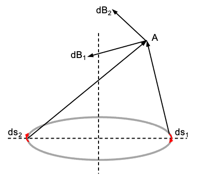

The vertical component cancel out, leaving ##~\dots##
They don't because you are asked to find the field at points A and C which are off-axis. Below is the appropriate figure where ##ds_1## and ##ds_2## are diametrically opposed current elements. The magnetic field contributions ##dB_1## and ##dB_2## don't have equal lengths because the distances to the current elements are not equal. Furthermore, the angle between ##dB_1## and ##dB_2## is not bisected by the horizontal. So the symmetry argument does not apply.

I found this on the web. I think you will find it useful. The answer for part 1 hinges on the observation that the flux through the end of the semi-infinite solenoid is half the flux in the middle.
I found this on the web. I think you will find it useful. The answer for part 1 hinges on the observation that the flux through the end of the semi-infinite solenoid is half the flux in the middle...
Thank you so much. However, I had already seen this useful video. I still don't understand how the observation that "the flux through the end of the semi-infinite solenoid is half the flux in the medium" can be determinative of point 1. I only found the following:
In terms of angle ##\theta_1## and ##\theta_2##, the magnetic field at a point on the axis is given as $$B = \displaystyle\frac{\mu_0 nI}{2}(cos \theta_1 + cos \theta_2)$$. For a semi-infinite solenoid we use ##\theta_1 = \theta## and ##\theta_2 = 0##, and we have: $$cos \theta = \frac{x}{(x^2+R^2)^\frac{1}{2}}$$. Thus, magnetic induction as a function of distance ##x## is given by: $$ B= \displaystyle\frac{\mu_0 nI}{2}\bigg[\frac{x}{(x^2+R^2)^\frac{1}{2}} +1 \bigg]$$.
Angles ##\theta_1## and ##\theta_2## are related to the ends of a solenoid that is finite at both ends. You have defined them as the complementary angles of the ones shown in the video. When you write $$B = \displaystyle\frac{\mu_0 nI}{2}(cos \theta_1 + cos \theta_2)$$ that gives the field at a point inside a solenoid that is finite at both ends. For an infinite solenoid, ##\theta_1=\theta_2=0## because the ends are infinitely far away from all points inside.
Then $$ B_{\text{inf}} =\frac{\mu_0 nI}{2}(1 +1)=\mu_0 n I $$ For a semi-infinite solenoid, only one end is infinitely far away from all inside points, say ## \theta_2=0.## Then for a point inside the semi-infinite solenoid $$B_{\text{semi-inf}} =\frac{\mu_0 nI}{2}(1 +\cos\theta_1).$$ At the open end of the semi-infinite solenoid, ##\theta_1=\frac{\pi}{2}## so that $$B_{\text{semi-inf}}^{\text{end}} =\frac{\mu_0 nI}{2}(1 +0)=\frac{1}{2}B_{\text{inf}}.$$

That will not work. Coordinate ##x## is along the axis of the solenoid. Points ##A## and ##C## are both on the plane of the end of the solenoid at ##x=0.##
So how can I arrive at calculating ##B## in ##A## and ##C## from "observation that the flux through the end of the semi-infinite solenoid is half the flux in the middle"? As you can see, I am really struggling, although I have attempted many approaches.

In part 1 you are looking for the axial component of the magnetic field at points in the plane of the last loop. If you follow the video, it is shown that for distances greater than the radius of the solenoid, the field lines are perpendicular to the axis of the solenoid which means that the field has zero axial component at ##C.## That's the easy part. Point ##A## is harder, but I suspect it involves a flux argument of the kind that used to prove item 4 in the video.
For part 2, I don't believe that flux goes through the coil. It's a Meissner effect situation. The supercurrent provides a counterflux that excludes all the flux that comes out of the solenoid. As you know from the video, half the flux in the solenoid goes out the sides. So you have to calculate how much current is needed to generate that amount of counterflux. Since the radius of the coil is much larger than the radius of the solenoid, I think it is safe to calculate the counterflux through the end of the solenoid using the expression for the field at the center of a ring of current.
If you follow the video, it is shown that for distances greater than the radius of the solenoid, the field lines are perpendicular to the axis of the solenoid which means that the field has zero axial component at ##C##. That's the easy part.

It is not possible to say that ##3r>R## and I don't know where you got that idea, The drawing below shows the plane of the coil as a dotted line and points A and C approximately drawn to scale. The axial component (parallel to the axis of the solenoid) is zero at C and non-zero at A.
About part 3, if you have the super current ##I_{sc}## and the radial field ##B_r## at the loop, you can find the force as ##F=2\pi R I_{sc}B_r##. The key for parts 2 and 3 is finding ##B_r## on the dotted red line as a function of ##r##. I don't know how to do that for large distances from the axis.

A friend of mine stated the following:
"Points ##A## and ##C## are located on the plane of the last coil of solenoid. In particular ##A## is an internal point of solenoid at distance ##\frac{r}{3}## from the axis while ##C## is an external point at distance ##3r## from the axis. Now it is clear that ##B_A## has an unic component of ##B## which is parallel to ##x##. Hence I think that $$B_{A_x} = B_A = \mu_0 n I$$. On the contrary ##C## as external point has a tangent component of ##B##. If we consider an Amperian coil of radius ##3r## in the plane ortogonal to axis containing just the last coil of solenoid, by Ampere law we obtain $$B_t \times (2 \pi 3r) = \mu_0 I$$ or $$B_t = \frac{\mu_0 I}{6 \pi r}$$. It is a negligible fraction of ##B## or $$\frac{B_t}{B} = \frac{1}{6 \pi r n}$$. We can say that $$B_{C_x} = 0$$."
Is it correct? In my honest opinion, only the second part is correct.
Your friend does not understand Ampere's law. To begin with, an Amperian loop
has no current cutting through its plane so the enclosed current is zero. This is consistent with the fact that the component of the field at the circumference of the Amperian loop is radial which means that the field vector ##\mathbf{B}## and the line element ##d\mathbf{s}## are perpendicular to each other and ##\oint \mathbf{B}\cdot d\mathbf{s}=0.## So Ampere's law in this case gives ##0=0## which is not very helpful.
I agree that ##B_{C_x} = 0## and I said so in post #20:
I have said all I can say about this problem and I am sorry I cannot help you more. If you come across a solution, let me know.

I am not sure I buy this statement. In the plane of the last solenoid loop the direction of ##\mathbf{B}## changes from parallel to ##x## at the center to perpendicular to ##x## at the circumference. How close is "extremely close" when the radial distance from the axis is ##\frac{1}{3}r##?
