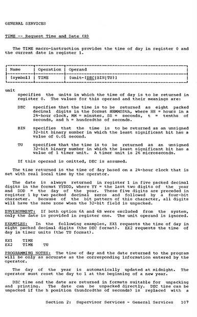

The IBM System/360 had a date format with 2 digits for the year.
IBM Systems Reference Library
IBM System/360 Operating System
Control Program Services
Changing to a 4-digit year genuinely was necessary for disambiguation, and all the mainframe software vendors had Y2K-compliant editions of their software products, and the IBM mainframe systems programmers were legitimately busy implementing all the required IBM and ISV and independent code changes and customizations, and the applications programmers were diligently updating many thousands of lines of code, in Cobol, PL/1, Fortran, Algol, Assembly, and other languages.
In the '60s, the System/360 MVT COBOL compiler defaulted the presumed century digits to '19'.
