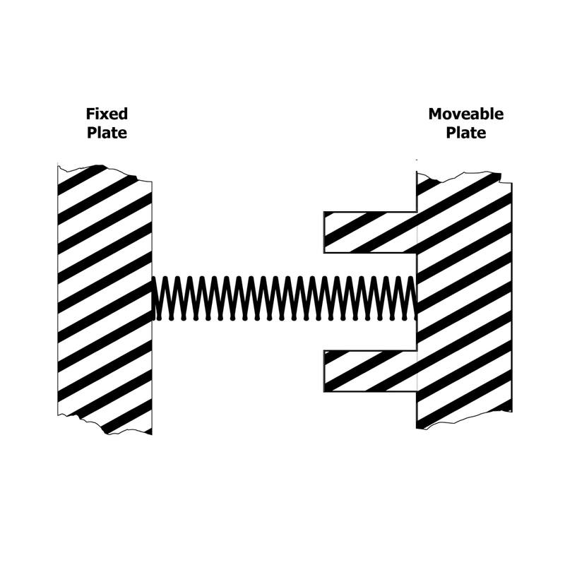

I am trying to understand the reaction of a steel coil compression spring when pulsed. The spring I am interested in has the following physical characteristics:
k (spring constant in pounds per inch) = 2.88
d (wire diameter in inches) = .043
n (number of active coils) = 29
D (mean diameter of the coil in inches) = .430
Lf (spring free length is inches) = 6.55The spring is mounted to a fixed plate on one end and a moveable plate on the other. The spring is at rest. It is compressed to a length of 3.75" and held there by the moveable plate. In this condition, the spring is exerting a force of about 8.064 pounds on the plates. If it matters, the moveable plate weighs 19 ounces.The moveable plate is subjected to a pulse that accelerates the plate at a rate of 29,400 ft/sec^2 for a period of .8 milliseconds (by a force of about 1,091 pounds applied to the moveable plate).
Intuitively, it seems to me that the spring will not have time to react to the pulse, so the presence of the spring has no practical effect on the acceleration of the moveable plate. However, I actually have no idea how to determine the length of time it would take the pulse to propagate the length of the spring.
I will appreciate any and all responses. Just to be clear, I am not looking for a lengthy explanation here. I would like to be pointed in the right direction and a link to some of that information would be greatly appreciated.

It helps to visualize what's happening before looking for a mathematical solution. I like to use the ESP method - Exaggeration of System Parameters. Think of two cases:
Case 1: The plate is displaced slowly. In this case, the spring force is proportional to the displacement times the spring constant.
Case 2: The plate is displaced almost instantaneously - much faster than the spring can possibly respond. The end turns will compress solid, then a wave will travel down the length of the spring. You can see this for yourself by playing with a Slinky toy (highly recommended to improve understanding).
Now for some calculations. Calculate the velocity reached at the end of the force pulse. You can ignore the spring force for this calculation because it is small compared to the acceleration force. Calculate the distance traveled at the end of the force pulse. Now compare the time to travel that distance to the period of one cycle of the surge frequency, while thinking of Cases 1 & 2 above.
Given the velocity at the end of the force pulse, the spring preload, and the spring constant, calculate how far the plate travels until the velocity decreases to zero. Then think about surge pulses traveling back and forth, and recognize that this calculation is an approximation.

I had gotten as far as your thoughts above in my examination of this situation, Before proceeding, I will describe the whole scenario. The spring is as described in my first post. the moveable plate weighs about a pound and can be considered to be rigid. The pulse acting on the moveable plate actually has a duration of about a millisecond. It starts with the impulse described in in post #10, then the force decreases linearly to about 900 pounds over the millisecond time period. At that point, the force is removed and the moveable plate has moved about .14" while attaining a velocity of about 27 ft/second toward the fixed plate. From that point on, the moveable plate coasts at its 27 ft/second velocity toward the fixed plate being slowed only by whatever energy is stored in the spring as the spring is being compressed. The moveable plate is stopped just prior to spring bind. The total distance traveled by the moveable plate is about 2 inches. The time of travel would be about 8 milliseconds. I calculate the natural resonant frequency if the spring to be about 140 Hertz. The period of one cycle at 140 Hertz would be about 7 milliseconds, so it seems to me that all the coils of the spring would be involved in resisting the movement of the plate at about 7/8 or about 90% of its travel. If that scenario holds water, I would think that the energy stored in the spring would ramp up at increasing rate for the first 90% of compression until all the spring coils were involved, then continue to increase linearly for the remainder of the plate's travel.
Please critique my assumptions.
It's not that simple. The sudden start causes a spring surge. The spring surge is bouncing while the plate is moving, so the spring force on the plate cannot be calculated easily. Any calculations are only a rough approximation. Did you calculate the spring surge frequency for the case of both ends fixed? When one spring end is connected to a mass such that the spring mass natural frequency is lower than the spring surge frequency, the surge frequency is for both ends fixed.
If the purpose of the spring is stop the plate, then the real test is to try and see if it works. The calculations tell whether your choice of spring should do the job, the test tells if it will do the job.
Make sure that the spring is not overloaded when compressed to solid height, because the individual coils are compressing that far during spring surge. Also, if you can find a high speed video, you would find it very interesting to video the spring at 1000 to 2000 frames per second.

I wasn't clear in my explanation. The plate is stopped just prior to the spring becoming solid. The spring itself does not stop the plate. Also, I know the spring performs as intended, because the application is repeated millions of times the world over every day.
However, there are many people (most, actually) who believe that the spring plays a material role in slowing the plate. I, and a few others, think that the role of the spring in slowing the plate is minor.
The purpose of my attempted analysis is to test my personal theory that the spring does not even have time to materially oppose the plate until a significant amount of time after the initial pulse. I don't care whether that is true or not, but I would like to have my theory either disproven or deemed reasonable. Either way, I gain understanding. Once I have some understanding of the system, I can (hopefully) engage is some intelligent discussion about it with others.
The actual design purpose of the spring is to absorb energy from the moving plate so that once the plate has expended all its energy by being stopped, the spring can then return the plate to its original position, ready to begin a new cycle. A person is capable of cycling the system at up to 7 cycles per second. The system handles that rate with total reliability.

I will be happy to tell all in the end. For now, I'll just say that your intuition in Post #11 is in the right arena, just looking at it from a different direction. Think internal instead of external.
Here is a sketch of a rough model of the situation (note the two stops on the moveable plate):
