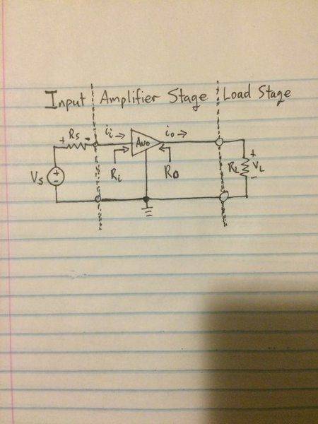

1) vs = 1 mV. Find v1, v2, v3 and vL
2) Model the three-stage cascaded amplifier by a single voltage amplifier model. What are the values of Ri , Avo, and Ro?
Diagram:
1) v1 = 0.909 mV
v2 = 9 mV
v3 = 818 mV
vl = 744 mV
These are correct, same as the book
2) I got 900.42 to be the gain. But why is Ri and Ro the same values of the input and output of the 3 stage amplifier ?, I am thinking because Ri depends on the source voltage which is the same and Ro depends on the voltage given to the load which is also the same in both cases ?
[ mentor note: image link modified to remove advertising/spam content ]
Assuming the values of ##v_1, v_2, v_3##, and ##v_L## are correct, I have a few questions.
What do you mean by ##A_{vo}##? Do you mean the gain across all cascading stages, or the overall gain from source to load? ##A_{vo}## is usually used to represent open-loop gain, and probably shouldn't be used in this context. I would suggest using something such as ##A_v## for the gain across all cascading stages, and ##A_{vs}## for the gain from source to load.
The gain across the cascading stages is ##818.48 \frac{V}{V}##. The overall gain would be ##744 \frac{V}{V}##. How did you get the result of ##900.42 \frac{V}{V}##?
More importantly, why don't you show us how you calculated ##R_i## and ##R_o##?

I am talking about the open circuit voltage gain. I am referring to question two where they say you have to model the three amplifiers as a single voltage amplifier and find the values of Ri, Ro and Av. I am not sure how to calculate Ri and Ro but from the answers in the book they are 1 mega ohm and 10 ohms
If they want you to model all three stages as a single voltage amplifier, why would the cascade gain or overall gain be any different?
To find ##R_i##, you must find ##\frac{v_i}{i_i}##. What about ##R_o##?
I think the term Avo applies to the gain without any load and without consideration of Rs because Rs is part of the source only. Hence, it is the voltage ratio V3/V1.
Simply look into the input node and the output node of the amplifier without connected source and load. Simple solution by visual inspection.

When you look into the amplifier input, what is the input resistance, i.e what resistance is initially seen by the signal at the input?
Now pretend the load resistor isn't there. How much output resistance does the signal experience before it gets to the load resistor?
Okay, so the first resistance the signal sees is the 1MOhm resistor, so the input impedance of the single voltage amplifier circuit is 1Mohm ?
In order to get to the output it passes the remaining resistors which are all in parallel so the equivalent resistance is 1/(1*10^6) + 1/(1*10^3) + 1/(100*10^3) + 1/(1*10^3) + 1/(10*10^3) + 1/10 = 1/10
So the equivalent resistance is 10 ohms which is equal to the output resistance of the single voltage amplifier ?
Looking into the output node of the amplifier model you must know that the source resistance of the last voltage source is ZERO !
Likes STEMucator
that is correct for the input resistance.
Ro is output resistance, which means the resistance seen from the output of the amplifier. This has already been stated, but I will say it again.

v3-vl = 74mV = Voltage across Ro
Io = Vl/Rl = 0.744/100 = 0.00744 A
Ro = Vo/Io = 0.074/0.00744 = 9.95 ohms
Is there any other way to calculate it ?
so you forgot something important!
you must zero out all independent sources (which includes the voltage source at the input). If that voltage source is zero, what is V3?
V3 depends on Vs so V3 is zero. If their is no voltage source then there is no voltage in the circuit
correct, which means in your solving for Ro Vs is zero...
soo Ro is...

So I made an assumption that you knew how to find equivalent resistances. When I say V/I, i mean zero out all independent sources, remove the load, then put a voltage source on the output (which is vL). Then find what the current is, and that will tell you what the output resistance is. does that make sense, tell me if it doesn't
But for a problem like this, there is a shortcut, that was hinted at before. since v3 is zero, there is just a single resistor, so you can tell what the output resistance is by inspection.
The RedDevil - here is what i wrote in my post#7, Didn`t you read it?
"Visual inspection: Look into the amplifier and identify the resistor you see. And the same from the other side. Disconnect the load and look into the output. Not very tricky!"
You must not calculate anything - which resistor do you identify looking into the output? (The voltage source has a zero source resistance!)

I know it's the 10 ohm resistor but what about the output resistances in stage 1 and 2 ?, doesn't that play a role in finding the equivalent output resistance for the single voltage amplifier ?
no. that's the beauty of electronics. You can isolate all those other stages to get the desired output resistance!
So if I had a voltage amplifier connected to a current amplifier which is connected to the load and if I wanted to model it as a single transconductance amplifier then the input and output resistance would be the same as the resistor that you see when looking into the input and output terminals of the voltage/current amplifier ?
Yes! please keep in mind that sometimes it is not just one resistor, and you will have to use the voltage/current method (there are other methods too).

I would like to add a thought.
Why not look at the diagram as if stage 1, 2, and 3 were all just one stage. Call it the amplifier stage.
Then the diagram would reduce to the voltage source with a source resistance, the amplifier stage, and the load stage:
If you look into the input of the amplifier stage, what is the input resistance seen ##(R_i)##?
If you look into the output of the amplifier stage, what is the output resistance seen ##(R_o)##?
I felt there was still some uncertainty, so I posted this in case you might want to see it.
Do you see - any connections between the output and the other stages?
With other words: Injecting any current into the output (no signal at the input, of course) the only voltage created by this current will be across Ro3,
