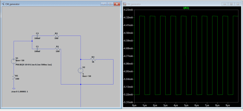

Hello!

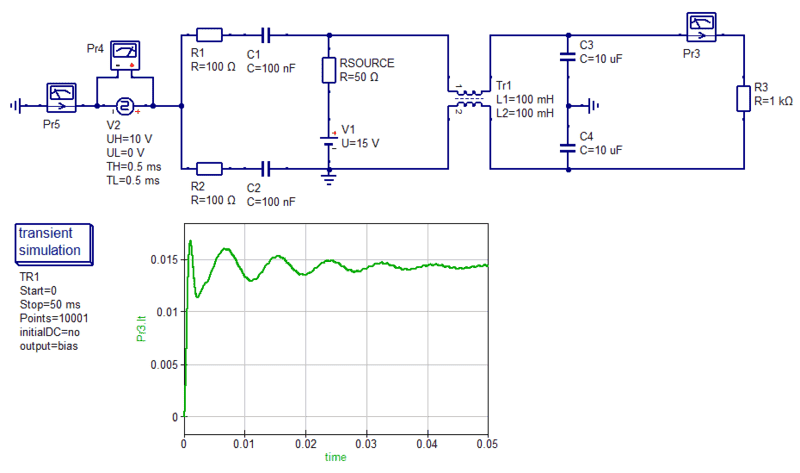

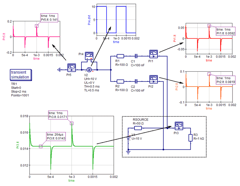

I'm trying to model common mode current with LTSpice, but there is a problem with my simulation. Someone else tried on an other software and got the expected result, but I can't explain why. When going through the capacitor, square signals should become pulses, but that's not the case for me Here is the two screenshots:

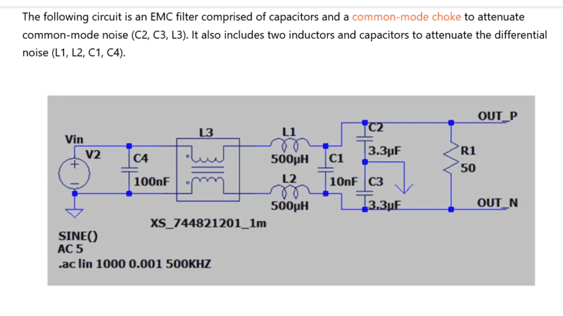

This is the one that shows the expected results

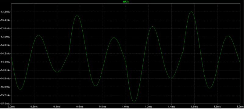

and mine
You have missed part of the LTspice schematic circuit in the post. There are no inductors ?
LTspice has assumed parameters for inductors that are not shown on the screen.
You need to post the CM_generator.asc file, but as a text file; CM_generator.asc.txt
Then I can look at what is not shown.
Likes berkeman
You are simulating the circuit 2000 times faster than the other model. 1 usec ~ 2 millisec cycle.
V1 should be PULSE(0 10 0 10u 10u 0m5 1m0)
Why is V1 "Rser=50" when in series with 100R ? make it Rser=0
You need a 2 msec transient analysis time, not 2 microsec; .tran 2m
Likes DaveE and berkeman

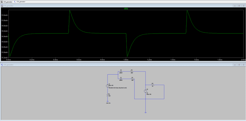

Hello!
I assume that was the problem, because now it matches the other graph, thanks!

You have reversed the numbering of the voltage sources between the competing diagrams. I refer to the pulse generator on the left. Yours has 50R internal + 100R external = 150R extra in series with the pulse generator, before the split in two, each branch of which has 100R.
The models should not have the same response since your generator has more series resistance.
Screen dumps make it very difficult to diagnose what is what.
Only an LTspice.asc as an attached .txt file can be trusted.

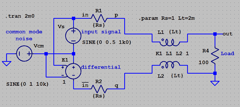

Here is a different simulation that allows common mode and differential signals to be tested.
The normal mode signal is a differential signal from Vs, with the image generated by E1. The common mode noise comes from Vcm and is applied to the mid-point of the differential signal.
Line resistance Rs, and choke inductance Lt, are parameters that keep the circuit balanced as you experiment with how far you can push them before the performance is degraded.
This circuit can be changed to simulate several different things.
Run a 2ms .tran analysis and view the signal input against output.
Run a 20ms .tran analysis, select plot window, then view, and FFT, to show cm rejection ratio.
Change Vcm to AC 1 and do an .ac analysis to see cm rejection across frequency.
Similarly, make Vs an AC 0.5 source to see .ac analysis of the signal path.
Note that the differential signal is doubled if not AC 0.5, so it has a +3 dB gain if AC 1 is used.

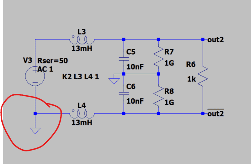

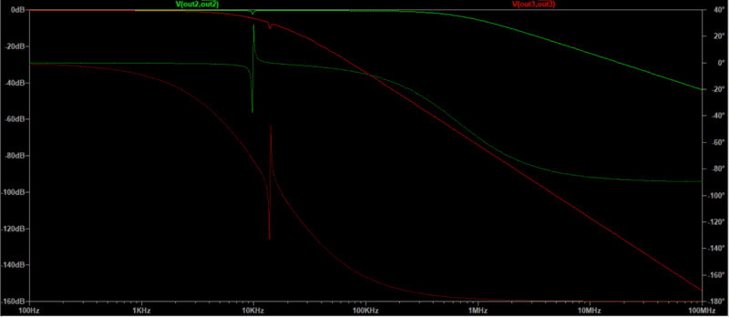

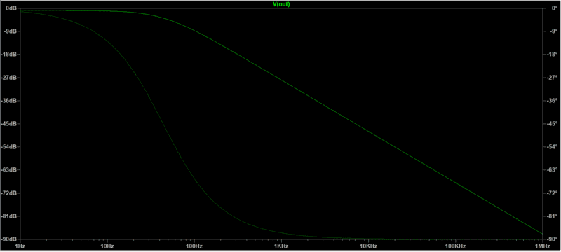

Hello!
So I've ploted the bode diagram of a filter and I've obatined a weird result: some kind of resonance (we clearly see it on the phase plot, less on the gain plot)
But it only appears when I've added the ground to the generator, and I'm not sure if it is really needed (the new reference point)
appart from that, I've also ploted the bode diagram without a common mode choke, but with two uncoupled inductors with the same value as the choke , and I can't explain the difference between the two of them. Of course I knew I would get two different plot, because the component aren't the same, but from a mathematical point of view, the transfer function is the same: two parallel inductors and two capacitors. I can't figure out the impact of the coupled inductors in the transfert function, and how to express mathematically the difference between both of them
red is without the chokethanks in advance for your help

There is no CM signal component in your model.
If you are modelling a power supply filter, then you don't need a 50 ohm series resistor in the V3 supply.
Also you don't need a balanced differential signal output for a power supply.
Here are a couple of AC analysis files, one for CM rejection, and one for signal transfer.
There are only three parameters to juggle initially.
There are no capacitors to ring with the choke, or to require fake grounds.
Notice that signal attenuation is about 0.1 dB due to the ratio of Rd /( Rd+Rs ).
Notice that signal phase is less than a milli degree.
The signal is doubled, but then only the top half is analysed, so dB is correct.
I believe that is as simple as analysis of a CM choke can get.

Re: Your circuits attached to post #22.
Out is a LPF of the 50 ohm with capacitance. 90 deg phase. No a resonance.

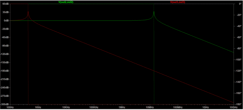

Out2; I cannot immediately explain the resonace near 15 MHz.
Out3 as expected shows the resonance of 26 mH in series with 5 uF at 441.6 Hz.
A CM choke is effectively wound back on itself, which cancels the differential mode magnetic field and the circuit inductance. Without the coupling coefficient the CM choke is gone, but the choke inductance appears twice in the series circuit.
PS Edit.
The 15 MHz resonance of Out2 appears to be an artefact of the computation. The currents in L3 and L4 do not cancel completely because of the floating point precision used. That results in a small residual choke inductance that resonates with the output capacitance. The resonance can be moved by changing the parameters Lcm=13mH, or Cp=10uF, or K=0.999999

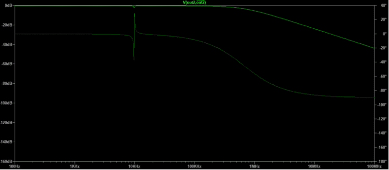

I'm sorry but I still don't understand what am I looking at. There's too much spikes and the phase is going from -8K° to 10K° seems absurd (is it 10 kilo degree?)
That is not what I see. All your signal is below -300 dB. I think you are looking at two very small signals that add and subtract randomly to generate phase reversals. Do not use the subtraction V(out,_out)
Look at only V(out). Do NOT reference the plot to _out.
You're right that's better
