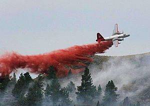

I think it's worth exploring, especially in connection with other fire suppressant materials. Keep in mind that air drops are the typical way that such suppressants are dropped ahead of the advancing fire (or on hot spots in some cases), so the density of the material (weight per unit area covered on the ground) is an important measure of effectiveness.
I'm guessing that the complications of making the tons of ice for air drops, and the fact that the ice will melt on the ground before the advancing fire front reaches it, will probably be the reasons that ice isn't used currently and may not work any better than water. I think the state of the art is currently dry fire suppressant powder, in combination with smaller water drops on hot spots by helicopter. This introductory article at Wikipedia looks fairly good, although more directed Google searches may help to shed light on the ice option...
https://en.wikipedia.org/wiki/Wildfire_suppression
https://upload.wikimedia.org/wikipedia/commons/thumb/2/20/BLM_Firefighting_at_Pine_Mountain,_Oregon_(14186496134).jpg/300px-BLM_Firefighting_at_Pine_Mountain,_Oregon_(14186496134).jpg
Likes cptolemy and phinds

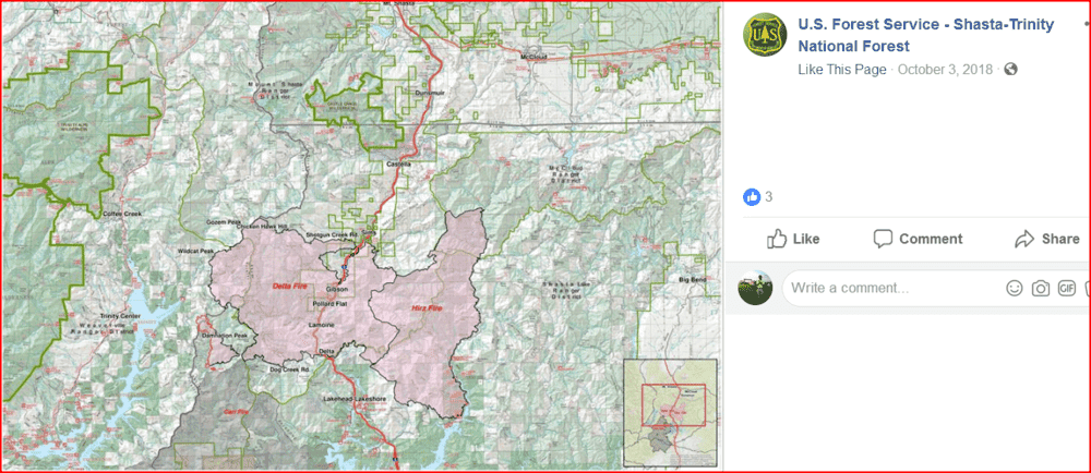

BTW, I was talking with a Battalion Chief friend of mine recently at my local fire station, and he asked me if I had ever seen the daily briefing maps that are printed out each day at the Incident Command Center of a typical wildland fire. I told him that I hadn't seen any, and since he had just gotten back from Strike Team duty for a recent wildland fire (where he was part of the Incident Command Staff), he opened the back of his Tahoe and pulled out some of the maps they had been using.
Turns out they have large format color printers running on the generators at the Incident Command Center, and each morning they print out the situation maps for the Command Staff to use in the planning for that day's operations. Pretty amazing stuff, especially when you consider what it takes to coordinate hundreds of firefighters and dozens of aircraft all in the same relatively small area. And to do it in the best possible way to protect life and then structures. Hats off to such amazing teamwork.
This is not one of his maps; his were similar to this, but zoomed in Topographical maps with lots more details on the terrain and the fire(s)...
https://www.facebook.com/ShastaTrin...994429865937/2236994326532614/?type=3&theater
Likes cptolemy

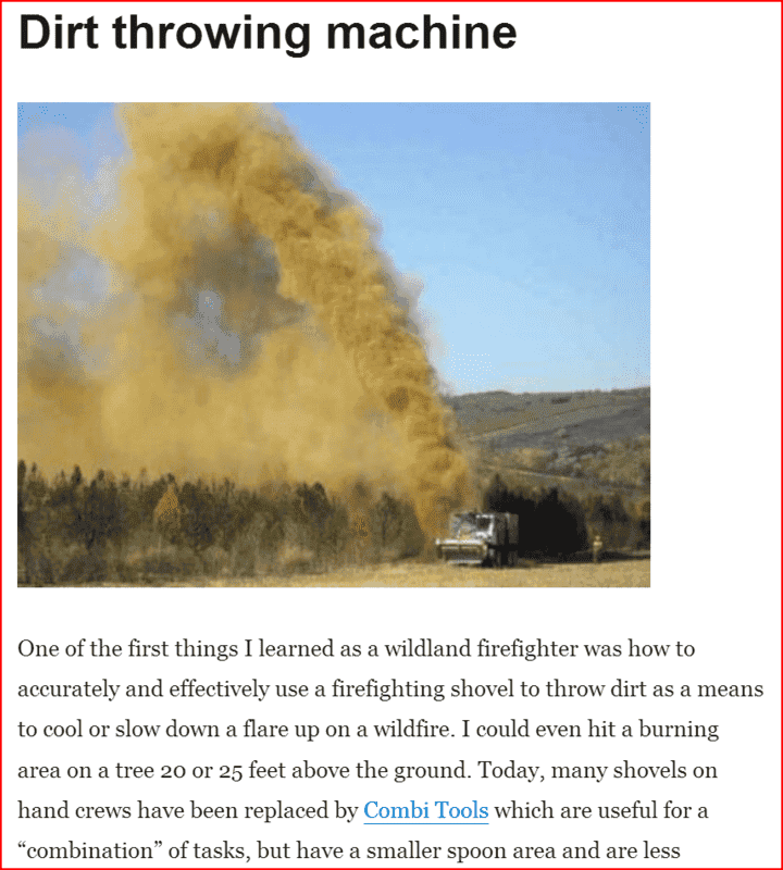

Don't know about using ice to fight fires but I had a idea some time ago(Ii do have them sometimes) that a possible way of fire fighting is to use dirt, Thinking mainly of bush fires and places where water is scarce.
My idea was to use some kind of machinery to project a large quantity of dirt or soil etc onto the fire to smother it. Maybe a high speed mobile conveyor and a system to feed dirt/soil onto it. Material could be scooped up locally in the bush by dozers etc. The conveyor should be able to project the dirt a fair distance, be easily moved across the flame front. I guess it would only be useable from bush tracks or trails and in suitable terrain.
Likes berkeman
pedro the swift said:
Greetings,
Dirt is used on small scales to fight wildfires, but any large-scale use of dirt would require the digging/projecting apparatus to be way too close to the flame front on the ground. And given the speed of advance of many wildfires, that's a very dangerous place to be! That's why so much of the firefighting is done with planes and helicopters... :smile:
EDIT: Hey -- check this out. I did a quick search, and there are some situations where your idea is being used!
https://wildfiretoday.com/2011/07/04/dirt-throwing-machine/
Likes 256bits
