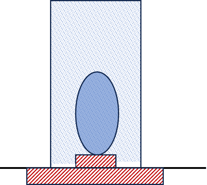

  • #33
Can I put some forces on these?
I think the force on the scale is initially
$$W_j+ W_{air}+W_{balloon} - F_b$$
Where:
##W_j## weight of bell jar
##W_{air}## weight of air surrounding ballon
##W_{balloon}## weight of ballon material and air inside balloon
##F_b## Buoyant force from initial displaced volume of balloon.
In the case after the air is removed the ##F_b = 0 ## because the density of the fluid displaced is zero ( Vaccuum), and ##W_{air} = 0##?
  • #34
Where:
The buoyancy of the balloon in the atmosphere inside the bell jar is a purely internal force pair. Up on the balloon and down on the inside-the-jar air. It can have no effect on the reading of a scale outside the jar.
A scale positioned inside the jar and supporting the balloon only will not see a contributions from ##W_\text{j}## and ##W_\text{air}##
An unusual scale design where the scale is hermetically sealed and covers exactly the bottom of the jar would see a contribution from ##W_\text{air}##. But only if we covered the top of the jar with an identical hermetically sealed scale and calibrated the two to measure the force difference. That would be an entirely unexpected situation.
Normally we set scales on legs so that air is allowed underneath.

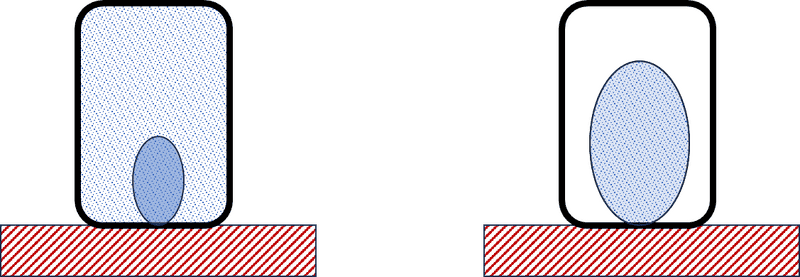

The bell jar and its contents which includes the air inside the bell jar is what is getting weighed when the bell jar, totally enclosed, is on the scale. The bell jar does displace a volume of ambient air around it, so the buoyant force from the bell jar becomes part of the picture to be considered.
What the balloon does inside the bell jar is no longer of any bearing in the calculation.
Simply its weight plus the air inside the balloon, plus the weight of the air inside the bell jar, plus the weight of the glass of the bell jar minus the buoyant force of the whole bell jar from the outside air is what the scale will read.

  • #41
What does the scale measure in this scenario with the scale completely inside bell jar?
  • #42
The weight of the blue egg including its contents of air or fluid minus a buoyant force from the weight of the displaced air inside the bell jar.

The weight of the blue egg including its contents of air or fluid minus a buoyant force from the weight of the displaced air.
ok, then when we decrease then amount of air in the jar, the ballon expands the displaced air volume goes up, but the density of the displaced air goes down i.e. there is less air in the same jar. So what is ##F_b## doing, I think its declining in magnitude, because I expect there to be no buoyant force in a perfect vacuum - thus, increasing the readout on the scale?
  • #44
What the buoyant force does in that case would be hard to predict, and it would depend upon just how much the balloon expands as the external pressure is lowered. If the balloon expands enough, the buoyant force could increase. If you make a vacuum, yes, then the buoyant force would be zero.
  • #45
So then it's fair to say that there is something complicated occurring if you think it won't necessarily monotonically decrease toward zero. I'm a little bit - :oldconfused:
For a "rigid balloon" (I expect) it decreases monotonically as the air is evacuated. What is it about the rubber?

You've greatly changed the scenario from what @kuruman has with his isolated bell jar sitting on top of the scale. His case is simple. His balloon is inside an isolated bell jar. It doesn't matter for his case how the balloon responds.
When you have a balloon, basically in ambient air on a scale, and you change the air pressure, (e.g. lowering it) the balloon could expand an unpredictable amount. That makes for a case that doesn't have the same simple answer for what the buoyant force will do. If the balloon suddenly expands to a much larger volume, the larger volume could more than offset the lower density of the ambient air.
  • #47
Have I though? So…that whole assembly is now on a scale of its own. The scale reading inside is unpredictable, and the scale reading outside is predictable. That’s kind of interesting isn’t it?
Likes Charles Link
  • #48
You could have the balloon inside the bell jar be a helium balloon that originally floats in the bell jar. It doesn't matter at all to the scale outside what the helium balloon is doing. It will read the weight of the contents of the bell jar, minus the buoyant force of the entire bell jar from the outside air.
The scale inside the jar will read zero though if the helium balloon is floating in the air or rises to the top and pushes against the top of the bell jar. If you then empty the air out of the jar, the scale outside the jar will read less, but the scale inside will now have a helium balloon resting on it and it will read its weight. (Note: there is zero buoyant force inside the jar). The outside scale reading went down, and the inside scale reading went up. Yes, it's very interesting. :)
  • #49
kuruman said:
The answer was given by the teacher, which the OP didn't buy. I pointed out OP's misapplication of th 3rd law in post #12.
Let's say you have a bowl of water on a scale. Then you submerge your hand in the bowl without touching the bowl so the hand is freely in the water not moving. This will result in the scale registrering more weight since there will be additional force from somewhere on the scale. I just thought that the additional force was a opposite force from the buoyancy force on my hand, but it seems you think I am wrong?
If you apply this to the balloons then you could say the scale readings will both be the same? Their mass will always be the same.
  • #50
@erobz addition to post 48: The scenario mentioned at the bottom of this post with the helium balloon also applies to @kuruman 's condom demonstration of post 14. The outer scale will show less weight, but a scale inside the bell jar would show an increase as the air inside the bell jar is removed.
to answer @Thamska of post 49, your first paragraph is correct, but I don't see how you get the result of the second paragraph from that, and the second paragraph is incorrect if air is present to supply a buoyant force in the scale readings to the balloons.
Note: Even the bowl of water (no hand in it) appears to weigh less than it really does because there is a buoyant force from the outside air. The scale would show a slight increase if you were to remove the air.
