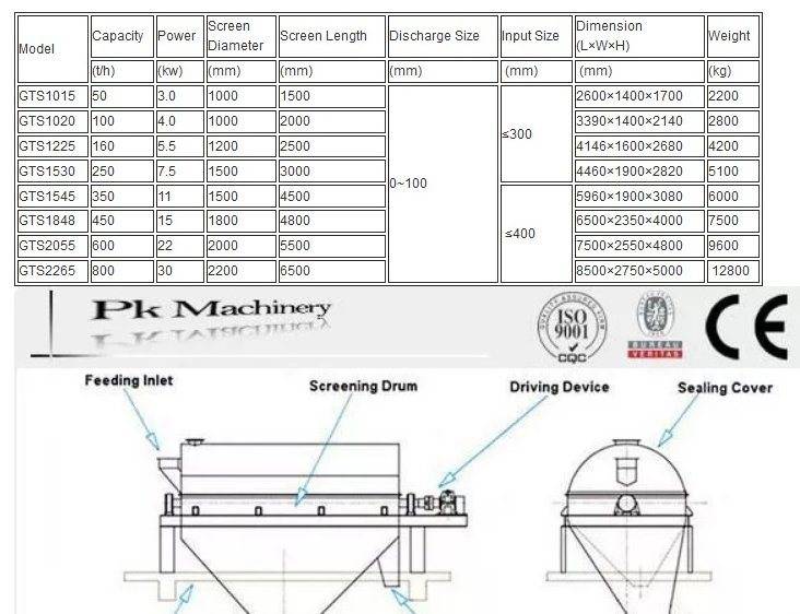

Well, this might be a very disappointing attitude but if everything else fails ... well, it still works, you see :sorry:
Pick an existing trommel from somewhere and just check the engine power...
(Source is some random trommel-distributor from an online marketplace)
Good data. The smallest is 50 tonne per hour, with 3 Kw. But the OP is building a smaller system, so the 1 HP motor seems like a reasonable solution that should not stall.
