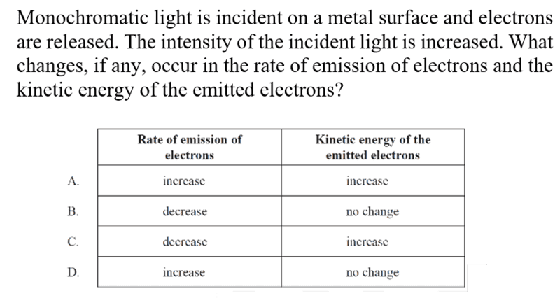

Please see below
##hf=\phi+KE_{max}##
I have trouble understanding these two separate questions:
I know the answer for this one, it is (D). The KE of electron depends on the frequency of the light so since the frequency of the light does not change (I assume so), the KE wil stay the same. Increasing the intensity will increase the no. of photons so the no. of eletrons emitted will also increase.
But for the next question:
"The frequency of the incident light is increased but the intensity remains constant. Explain why this increase in frequency results in a change to the maximum photoelectric current (saturation current)"
I don't understand why there is change in photocurrent while the intensity is constant. My answer would be the current does not change but the electrons will move with higher speed.
Why can't I use the same logic as the 1st question? Or maybe there is something wrong with my assumption in 1st question (where the frequency is constant)?
Thanks

From practice questions given by teacher, answer also given. The level of the question is high school.
For 1st question, answer key is (D). For 2nd question, the answer is something like the photon per second will be lower so the photocurrent will decrease.

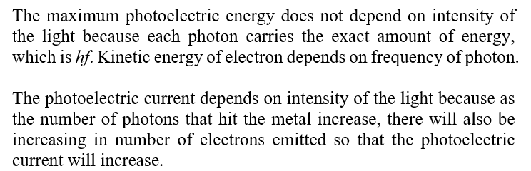

This is what in my notes:
So I am confused why the answer for 2nd question is not be the current does not change but the electrons will move with higher speed.
Is there something wrong with my notes?
Thanks

What I understand so far is:
For my 1st question ##\to## frequency is constant (presumably) but intensity increases so rate of photon increases
For my 2nd question ##\to## frequency increases but intensity stays the same so rate of photon needs to decrease

songoku said:
For my 1st question frequency is constant (presumably) but intensity increases so rate of photon increases
Agreed.
songoku said:
For my 2nd question frequency increases but intensity stays the same so rate of photon needs to decrease
Agreed.

songoku said:
2)
I want to ask about my notes in post #12: "The photoelectric current depends on intensity of the light because as the number of photons that hit the metal increase, there will also be increasing in number of electrons emitted so that the photoelectric current will increase".
Note that we must (to avoid ambiguity) refer to the saturation current. (A photoelectric current's value can be smaller than the saturation current if the collecting-voltage is too small.)
songoku said:
Is this concept correct only if the intensity increases but frequency stays constant?
No - these are not necessary conditions.
The photoelectric saturation current increases if 2 conditions are both met:
a) the photon frequency does not fall below the threshold frequency (if this happened, there would be no photoemission);
b) the number of incident photons/second increases.
So, for example, the intensity could be reduced by 10% and the frequency could be reduced by 20%. Providing condition a) is still met, the number of photons/second has increased - so the saturation current increases (surprisingly!).

Is what in my notes incomplete? Because if the intensity increases, I also need to know about the frequency to be able to draw any conclusions about the saturation current.
Thanks
Your Post #12 notes aren’t quite complete/accurate IMO. For example, compare this (improved IMO) version to the Post #12 version.
For a given material (work function ##\phi##) and light of a given frequency (##f##), the maximum kinetic energy of a photoelectron (##KE_{max}##) does not depend on the intensity of the light. That’s because each photon carries the same energy (##hf##) and ##KE_{max}## depends only on photon energy and the work function: ##KE_{max} = hf - \phi##.​
The photoelectric saturation current is proportional to the number of incident photons per second (##N##). ##N## depends on both the intesity and the photon energy of the light. For a fixed photon energy (frequency), ##N## is proportional to the intensity of the light; in this case the saturation current is proportional to the intensity.​
