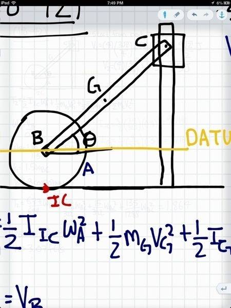

The system consists of a 20-lb disk A, 4lb slender rod BC, and a 1-lb smooth collar C. If the disk rolls without slipping, determine the velocity of the collar at the instant theta=30 degrees. The system is released from rest when theta= 45 degrees.
v=wr
kineticjustin said:
Above I attached a photo of what my FBD for the question looks like. When solving the question, the velocity of point B was described as 1.5*w(bc). I understand that the velocity of of any point of a rotating body is the angular speed times the radius, so where is the radius measured from when considering the speed of a point on a rotating body? The rod is rotating about Point B isn't it?
The radius is measured from the center of rotation.
But I suspect you have misunderstood the question - point C (the collar) is not rotating.
Would the center of rotation be C or G?
The rod is certainly turning - but it's also translating (well, it's center of mass is).
It's rather like those problems with a ladder leaning against a wall and sliding isn't it?
How could you go about figuring the center of rotation - could it be B?
Why not draw a free-body diagram and place the forces on it and let them tell you?
(Your attachment, btw, is not a free body diagram.)
