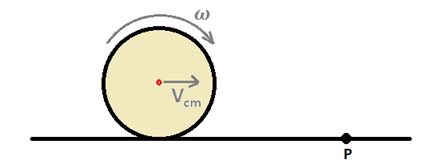

As a quick exercise, consider a solid disk of mass M and radius R rolling without slipping as shown. You can use ##\vec {L_p} = \vec {R_{cm,p}} \times \vec {P_{cm}} + \vec {L_{cm}}## to find the angular momentum of the disk about the point P in terms of Vcm, M and R.
Likes timetraveller123
sir sorry for the very late reply i was traveling and had net issues sorry
in post 8) i understand what you are saying i am familiar with the transformation but i am afraid you did not answer my question of a definitive way to calculate L
but i think your next post may help
post 9)
i am familiar with these kind of problems it is simply just
L = MVR + \frac{1}{2} M R^2 \omega
the kind that trip me up are when i need to calculate it in the frame of cm like this
there in the question in the para the cm was chosen as origin and in calculating the L about cm why do they include the ##
\Omega \hat z##term because that is the motion of the centre of mass i understand that that term would be used when calculating in lab frame but why in ball frame
