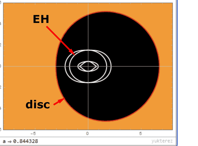

That's correct, as Peter has already noted. But look closely at the image at the top of this page: https://www.planetary.org/space-images/interstellar-black-hole. The innermost ring of the "halo" is not concentric with the rest, and the whole halo is noticeably off center from the disc. Those two features are optical effects of the angular momentum.
Wikipedia has a really nice animation of a black hole with an orange background as you vary the spin parameter from 0 (non-rotating) to 1 (maximum possible angular momentum). Counting from the outside, the second white line is what you might call the actual edge of the black hole if you could see it without the gravitational effects. The black region is the size you would actually see. (I note that the image is generated by yukterez, who I assume is @Yukterez, occasional poster here.)
IIRC, Gargantua was modelled with ##a\approx 0.3## on that scale.

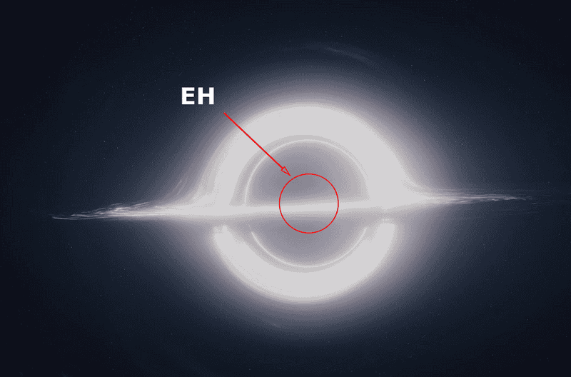

  • #33
So the diameter of the EH is significantly smaller than the apparent disc of the BH to an observer, thus?

  • #35
Yes. I think you've taken the animation still at a lot higher ##a## than Gargantua is modelled so that's a good deal more asymmetric.
