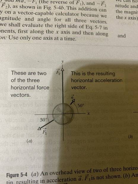

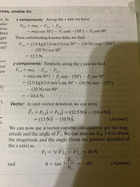

Three forces causes a net acceleration of ##3 \frac {m}{sec^2}## . Two of the forces ##F_1## and ##F_2## are 10N and 20N. Find the ##F_3## in unit vector notation?
Mass of the body is 2 kg.
##\vec F= m\vec a##
##\vec{F_1} +\vec{F_2}+\vec{F_3} = m \vec a##
x component of ##F_3##
##F_{3x}= m a_x- F_{1x}-F_{2x}##
= ##ma\cos 50-F_1\cos(-150)-F_2\cos90##
y component of ##F_3##
##F_{3y}= m a_y-F_{1y}-F_{2y}##
=##ma\sin50-F_1\sin(-150)-F_2\sin90##
And so on…
My question how we can represent it in diagram ##F_1\sin(-150)##. I suppose what is ##\sin(-150)## : ##\sin(-30)## and -30 is measured from position X axis. So what is the component now . Is it now in Forth Quadrant from 3rd.
I can understand the component ##F_1\sin30## or ##F_1\cos30## in diagram but the above component, I don’t.
I could have done it via reference angle taking a right triangle in each quadrant and taking acute angles and put a sign accordingly to each component after calculating magnitude of each component. But I choose to do it more systematically by textbook way.
I was told you can do it by unit circle convention. That’s what I am aiming for, for doing all the vector questions. Taking all the angles from + direction of x-axis and straight away putting in ##\cos and \sin##. In this way I don’t have to worry about the signs. It is dealt automatically.

Taking F1 = 10N:
F1 has x-component = 10N x cos(-150º) = -8.66 N
F1 has y-component = 10N x sin(-150º) = -5N
With the xy axes marked in units of Newtons, one way to plot these is:
For the x-component, draw an arrow starting at (0,0) and ending at (-8.66, 0)
For the y-component, draw an arrow starting at (0,0) and ending at (0, -5).
Note that if you add these two components (e.g. using the parallelogram method), you get F1 back.
EDIT: Typo's corrected. I got x and y interchanged.

rudransh verma said:
What I want is to be able to solve any problem by just putting the angle given relative to +x axis , not the reference angle
EDITED
The angle measured anticlockwise relative from the +x axis is the standard position angle. [EDIT - I incorrectly called this the reference angle pre-edit.]
If you are given a different angle, it is trivial to calculate the standard position angle. Then using your calculator will give the correct sign for the trig' function.
Steve4Physics said:
If you are given a non-reference angle, it is trivial to calculate the reference angle. Then using your calculator will give the correct sign for the trig' function.
I just need one angle that is relative to + x-axis to calculate component in any quadrant. I don’t want to solve by reference angle (which is angle relative to horizontal )method.
So by directly putting -150 like in this example I’ll get the component. But the thing is how do you represent this component in figure?
My apologies. I misused the term ‘reference angle’. I’ll add an edit-correction to my post.
The angle, measured anticlockwise from the +x axis, is called the ‘standard position angle’. I have also seen it called the terminal angle.
It is simple to find the standard position angle from whatever angle you are given. Then use these to find the components.
For example, for F1, the standard position angle is 180º+30º=210º. So using cos(210º) and sin(210º) will give the correct answer for the x and y components. No triangle required.
