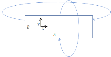

Here is my simple definition of a flat two-torus:
It is like a rectangle size ##A\times B## with coordinates ##x,y## but if you go off an edge, you come back to the opposite edge, so adding multiples of ##A## to the ##x## coordinate of ##B## to the ##y## coordinate keep you in the same place. It's a bit like a torus ...
A torus is intrinsically flat. Identifying boundaries of a compact flat manifold does not introduce (intrinsic) curvature.

I was baffled by @pervect although I could follow the maths*. I couldn't see how his equations mapped onto my flat torus. @PAllen solved that. I think that his polar coordinates give me$$
x=A\cos{\theta}
y=A\sin{\theta}
z=B\cos{\phi}
w=B\sin{\phi}
$$they induce a constant metric$$
{ds}^2=A^2{d\theta}^2+B^2{d\phi}^2
$$and a constant metric gives zero curvature immediately.
Now I can see why this is like a flat torus. Adding ##2\pi## to ##\theta## or ##\phi## takes you back to the same place in 4D just like my diagram of the flat torus where I started. And we have used the two circles (##S^1##'s) in 4D to get to this manifold which explains why Carroll was saying that a three-torus was ##S^1\times S^1\times S^1## and was flat. I suppose he just started in six dimensions.

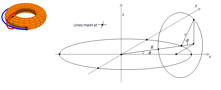

I don't get why a torus is intrinsically flat. A 'normal' torus is like a ring doughnut. In 3D Euclidean its surface can be parameterized by $$
x=\left(R+r\cos{\theta}\right)\cos{\phi}
y=\left(R+r\cos{\theta}\right)\sin{\phi}
z=r\sin{\theta}
$$which I got from Wikipedia. I made the diagram to see where ##r,R,\theta,\phi## were. It works.
That gives a 2D metric$$
{ds}^2=r^2{d\theta}^2+\left(R+r\cos{\theta}\right)^2{d\phi}^2
$$which fives a Ricci tensor$$
R_{ij}=\left(\begin{matrix}\frac{r\cos{\theta}}{R+r\cos{\theta}}&0\\0&\frac{\cos{\theta}}{r}\left(R+r\cos{\theta}\right)\\\end{matrix}\right)
$$which gives a curvature scalar$$
S=\frac{2\cos{\theta}}{r\left(R+r\cos{\theta}\right)}
$$That's not zero except when ##\theta=\frac{\pi}{2},\frac{3\pi}{2},\ldots## So that doughnut torus is not flat everywhere. In fact ##S## oscillates between a positive maximum and negative minimum and is positive on the outer side - it curves in both ways like a sphere; zero at the top and bottom like a cylinder and negative on the inside - it curves in in one direction and curves out in the other like a saddle. That all makes sense and it's still not flat.
I may have made a mistake in my calculations but they seems to agree with this here which, sadly, is so old that most of the maths symbols have worn away.
George Keeling said:
I don't get why a torus is intrinsically flat. A 'normal' torus is like a ring doughnut. In 3D Euclidean it...
I think the statement refers to a "flat torus", which can only be embedded isometrically in 4D, but not 3D:
https://en.wikipedia.org/wiki/Torus#Flat_torus
The doughnut surface is also a torus, but with a different metric, which can be embedded isometrically in 3D. They both share the torus-topology.
Likes George Keeling and vanhees71
A circle ##S^1## with the usual metric is flat, so the products ##S^1\times S^1## and ##S^1\times S^1\times S^1## with the product metrics are also flat- there's not any more calculation you need to do. But the standard picture of a torus in ##\mathbb{R}^3## is not isometric to this flat ##S^1\times S^1.##
