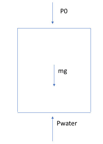

Would this be the forces in the vertical direction? For the same CV as above (I reckon I might miss a contact force from the dam?)
I also assume these would have to sum to zero as we only have flow in the horizontal direction (using sigmaF = rho*q*v,out - rho*q*v,in = 0)

The macroscopic momentum balance in the vertical direction is F= mg, where F is the upward force that the base of the control volume (including the dam) exerts on the fluid within the control volume, and mg is the weight of the fluid in the control volume.

Thank you! but what about the atmospheric pressure P0? Is it canceled by F?

For incompressible fluids, it is easier(and better) to work with gauge pressures.
