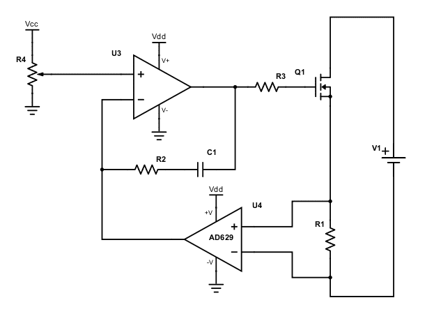

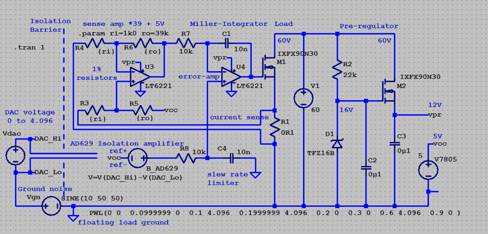

Please refer to the simplified circuit in the attached figure. The overall goal is to control the current through sense resistor R1 by adjusting a reference voltage V2, thus creating an electronic load where the power is dissipated in Q1. All load current is returned locally in the isolated loop on the right. By sensing the current differentially with e.g. AD629 and using the output as an error signal, U3 should to my mind simply drive Q1 to whatever level necessary thus closing the loop. However, in weak moments I start to think about what exactly is the relationship between the gate and source of Q1 since they are referenced to different ground domains. Is something off here?

You have not specified how the grounds are related.
There is a real problem with that circuit. I would expect an analogue isolator between the op-amp output and the gate input voltage.
As the design is now, the op-amp output will have to track the control signal plus the differential ground noise.
There is no low-pass filter in the feedback loop, so it will probably behave like a switching PWM controller. The error amplifier needs to become an integrator before it drives the isolator.
Likes berkeman and anorlunda

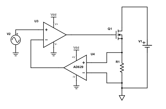

Please see the updated figure below (it's still simplified--I'll shed more light as necessary).

Galvanic isolation is not a requirement per se--it just so happens that the loop on the right is not referenced to the same ground as the left loop. Why is an isolator necessary?
Can you help me understand why the output will track the differential ground noise? To my mind, U3 will simply drive the gate such that its two inputs are equal, the effect of which propagates back through U4, ultimately forcing a portion of the set voltage across R1.

Then you have defined the two wire "circuit" as having only a single connection. It cannot work because there is no current available to charge the gate capacitance.
If the grounds really are floating then why can you not simply join them at one point?
The MOSFET Q1 will have zener-diode protection of the gate-source voltage to prevent electrostatic destruction of the gate. That is one connection between the different grounds. The other is the input resistance of the instrumentation amplifier, U4.
Your series R2, C1 is not an integrator. Move the (-)input of the error-amplifier U3, to the junction of R2 with C1, which will make a miller integrator.
But you are still missing an isolator, or a ground cross-connection.
Until you relate those two grounds your circuit will remain a mess of confusion.
An isolator will require a power supply on the MOSFET side. What is the V1 supply voltage specification?

It is necessary now. You do not appear to know what you are doing, so you are in no position to decide what is going to be relevant.
gnurf said:
In fact, I could've removed the "analog ground" symbol and pretended the right loop was a battery. I have simulated this whole thing with correct models etc and concluded, if only temporarily, that the circuit worked ...
Go ahead and do that. Also inject a sinewave or random +/- 50 volt signal between the two separate grounds and see how it responds. Then you will appreciate the monster you have created.

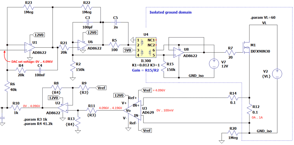

Thanks for your patience--your frustration re my attempt to trickle down information is probably warranted. Unfortunately I don't own the schematic so I can't post it here.
In an attempt to recreate the important parts of the circuit from memory I omitted the output resistor of U4, which I believe will complete the Miller integrator you describe. R2 still seems to be necessary though if my spice simulation is anything to go by--it is critical to my ability to dampen the oscillations I observed in simulation.

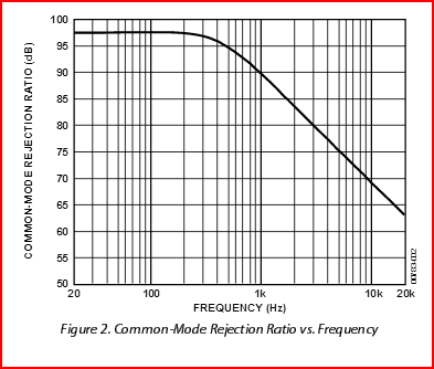

The difference ampflier AD629 has about 400k from Vin(-) to Vout. Doesn't that provide the return path for the charging of Cgs? Is an isolator still required despite this?
In the actual circuit the two ground domains will probably be connected at some point. However, that connection is out of my control so I just wanted to see if I could design as if it wasn't there.
In summary, given the completed Miller integrator, return path through AD629, and the the somewhat loosely defined (probably off-board) ground relationship, do you still think this is going to end bad?

As others have mentioned as drawn this won't work, the grounds for the current and error amplifier should be the same ground as the load elements.
The AD629 is a crazy amplifier with +/-270V common mode capability! I assume you chose this part because of the isolation?

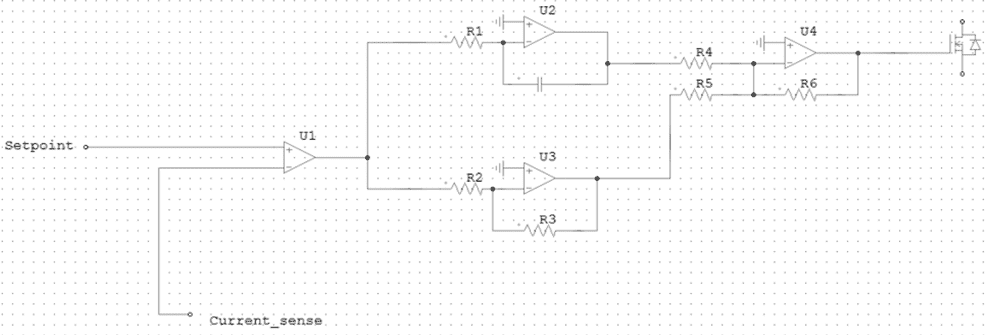

I'd do this a little differently:
Putting the isolation barrier inside your control loop makes things needlessly problematic from a stability point of view, so I'd put the opamps on the same ground as the load, and use an isolator (eg opto or what ever) to relay your setpoint signal over the isolation barrier (assuming you must have this isolation). This way you can use normal opamps, something that can go to 15V supply, (a little dual opamp something like LM2904Q1). One to do the current sense amplification, the other to do your error amplifier, strictly speaking of you want to do "true" PI control (assuming you want your steady state error to be zero, you need to integrate) you need to do the K and I separately:
U1 is error amp, U2 integrates, U3 is the proportional gain, U4 is the summation amplifier to bring it all back together.
Depending on how picky you are something like below can often be enough:
I'd also add a small resistive element between the drain and the load input, this makes the power dissipation on the fet(s) a little easier to manage, and reduces the overall gate voltage to current gain, this makes it a little easier to stabilize the whole thing.
Also for me at least, one fet was never enough, its always been at least a kw or so load, so needed quite a few parallel devices, which brings in a whole host of other things to keep in mind, (like source degeneration resistors).

As others have said, you'll need to ground the negative side of the battery.
You'll also want to add a resistor in series with the output of the current sense amp to make your integrator work properly. In fact, you could do this with a single op-amp if you wanted. Look up "differential integrator" if your interested.
Since you haven't included any numbers we can't tell if you are dealing with mW of KW, so we can only give general advice.
If the voltage across R1 is small compared to Vgs, then this circuit should work fine. In fact, this is a very common circuit for what you are trying to do.
The source resistor will tend to stabilize the circuit with local negative feedback. You can look up "source follower" (or "emitter follower" for BJTs) to learn more about this.
Your amplifier will have to accept signals at ground potential, of course.
You still have a bunch of details to work out, but there is nothing fundamentally wrong with your plan.

Thanks for the "differential integrator" pointer, I'll check that out. For this project, however, I kind of liked the robust AD629 as the interface to the load side (which is out of my control and thus assumed abusive). The AD629 is in fact followed by a level shifter/amplifier (not shown in the figures) which puts the control signal back into the range of the reference (set) voltage. As I said elsewhere, I have simulated this in its entirety and thought I had the details down--but apparently the spice model fails to take into account that the mosfet is doing a split between different ground domains. That doesn't align with my previous experience with spice, but who trusts simulators anyway.
The sense resistor is 0.1 Ohm and the current range is 0 to 1A so the voltage across it will be negligible compared to Vgs.

This misbegotten project has so many problems that they are colliding with each other. There is insufficient information to give sensible advice. Any changes suggested just confuse things more.
For example; If R1 is the output load, then Q1 is an N-channel source-follower, and will need a gate voltage that swings from zero to V1 plus a few volts. Even with a ground connection, I doubt U3 will have the required output voltage swing of 60+ volts.
What really is the load R1? Is this a DC motor speed controller?
What current and voltage can appear across R1 ?

R1 is not the load, it's a 0.1 Ohm sense resistor. The load is Q1 which is operated in its current saturation region.
It seems I have two choices going forward:
1) connect the grounds, in which case I can among other things also get rid of AD629 to simplify the circuit.
2) find a way to isolate the gate drive signal.
Do you agree?

No. I am sorry about being brutally honest when I say that there are many problems with this design. One change will not fix it.
Another example: Notice that the AD629 output cannot approach within 2 volts of the negative supply, or 1.5 volt of the positive supply. If the AD629 is used then the supply needs to be more sophisticated, so the lower terminal of R4, the pot voltage is the same as the zero reference on the AD629, which must be 2V or more above Vneg supply, = ground in your diagram.
If the problem was specified it could be solved reliably, and with a few components. But there is no specification. We do not know the output current, nor what the load really is, or why.
Why do you not derive the Vdd power supply from the V1 = 60V rail ?

Yes, it's a heater aka an electronic load. The AD629 does indeed attenuate by 20 as you say, but the gain is also internally restored and the transfer function is ultimately Vout = V(+IN) - V(-IN), ref page 10 in the datasheet.
Don't be sorry, I'm thankful for all feedback.
I add a DC bias (+4.096V) to the AD629 output in order to avoid your concern here about the lack of room near the negative rail (GND). I then amplify and strip off the bias downstream and feed the result (0V to 4.096V, which now corresponds to 0A to 1A load current) to the "error amplifier" where it is compared to the output from a DAC (also 0V to 4.096V).
The output current is 0 to 1A. The load is Q1 and it's because it is an electronic load. I just need to draw a programmable amount of current from a device under test. V1 will be nominally turned off and activated by another system, so I can't rely on that (this is just a small subsection of a larger board which has other duties as well).

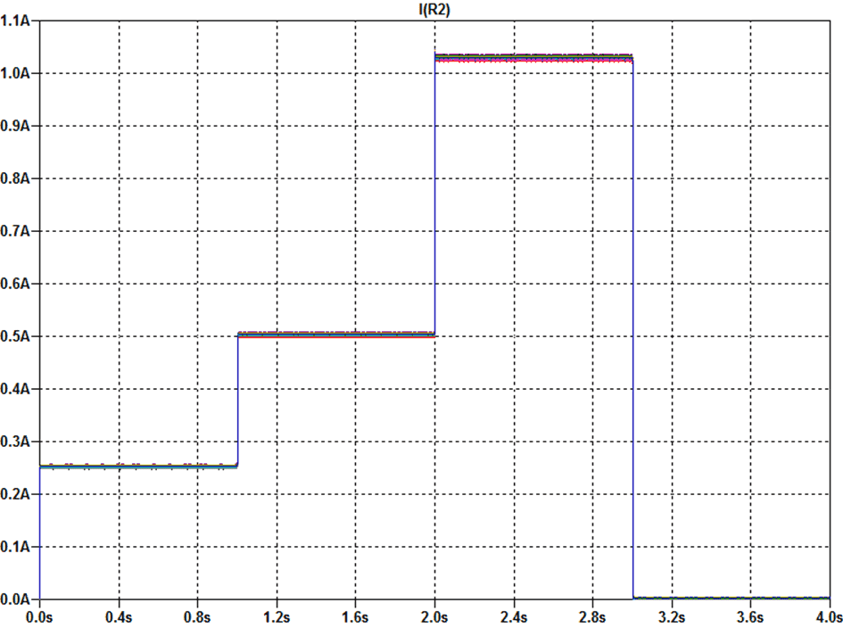

If I can get the optocoupler model working, I'll see if I can make a complete model of what I'm trying to do (i.e. option 2 from post #20) and add it here. I probably should've done that straight away, given the wall of text that is unfolding here. Thanks.

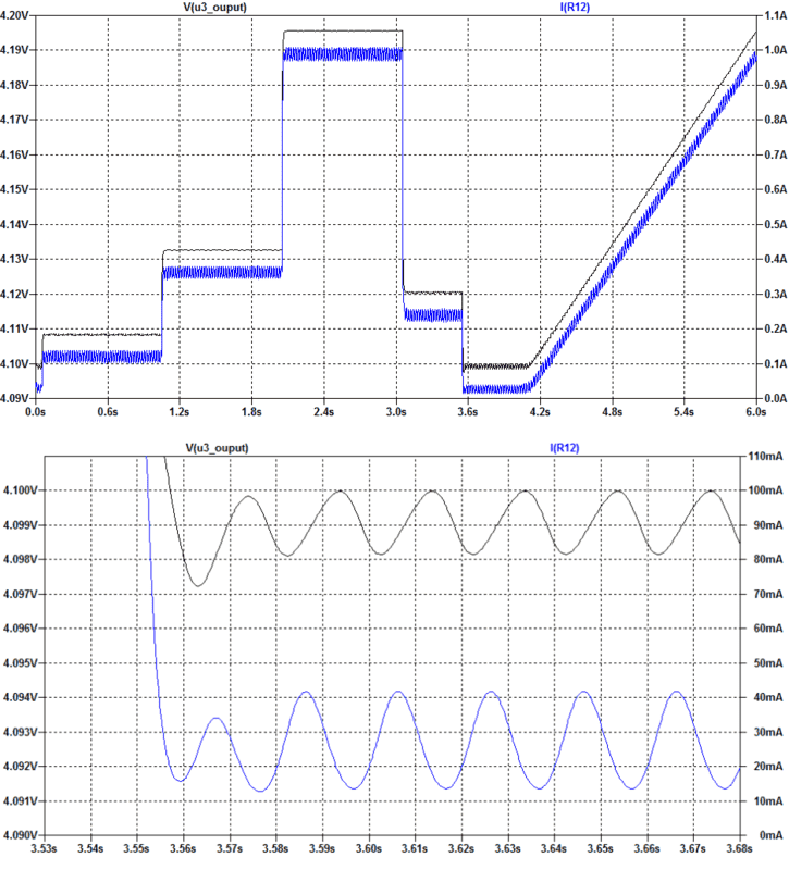

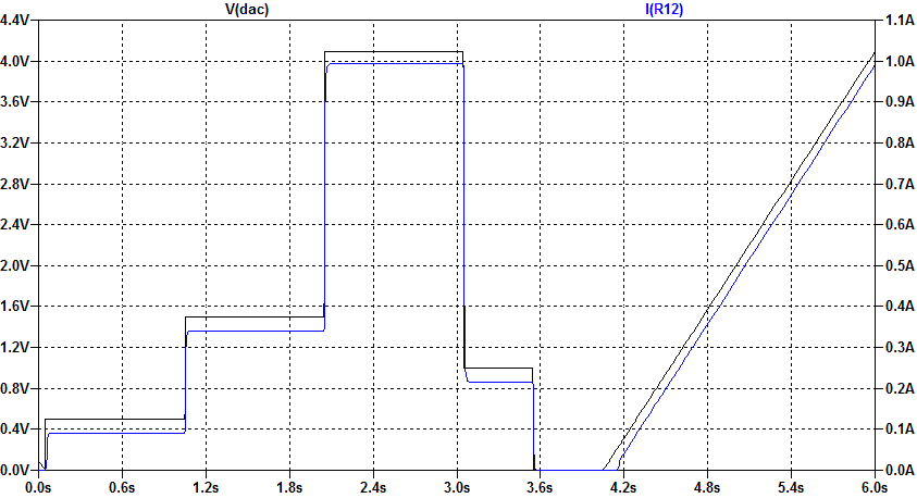

OK, so I hacked together something which seems to do what I want which is to control the load current by adjusting the output of a DAC. What is new here, well to me anyway, is the IL300 optocoupler suggested by @Tom.G in post #19 which I think solves the issue with floating grounds mentioned by @Baluncore and others. I'm a bit hesitant to post the whole .asc file, but if someone wants to have a look (or just wants it for whatever reason--I don't care) I can send it off-thread.
If there are any fundamental issues here (still) I'd be glad if someone could point them out. E.g. I'm sure I've butchered the so-called Miller integrator; the values are chosen by trial and error but it seems to work. I can easily break the whole thing by reducing for example R6 to say 20K or less. Also, I get that the optocoupler probably lives a happier life outside of the control loop, but for something as crude as this it hopefully can be acceptable.
Note: The 1MEG resistors in the schematic were added due to convergence issues and can be disregarded.

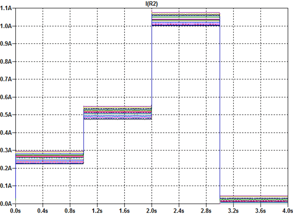

The plot below shows how the load current tracks the DAC input to U1. If someone can think of another test that actually breaks this, then that would be great.

Not necessarily problems, just a couple concerns.
1) It is unclear if the +VREF for U2 and U3 are separately derived as they need to be. The VREFs for U3 must be generated on the GND_iso portion of the circuit, while the VREF for U2 must be generated on the other, non-GND_iso, side.
SEE MY POST #30 BELOW
2) Please check the loop gain of the overall circuit, especially the gain distribution among the stages. If I did the quicky estimate correctly I get a transconductance of 79 A/V from the DAC voltage input, that seems quite high for your stated current range.
Cheers,
Tom
The circuit has grown in complexity again, and again.
I no longer believe anything I read in this thread.
How would I do it?
I would have kept the control voltage DAC on one side as a two terminal voltage source that changes from zero to 4.096 V. That requires only two thin tracks cross the ground discontinuity. Keep it simple.
Everything else would be powered and referenced to the load side supply. The AD629 would be powered from the load side and would sense the DAC differential output voltage only. There is then no requirement for any opto-isolator loop of any sort. The control loop becomes trivial as it compares two voltages.
A 100k resistor across the AD629 inputs will zero the load current when the DAC is not powered.
Loss of load side power will not load the DAC because the AD629 input resistance is high voltage.
Ignore part 1) of my post #28 above r.e. the REF voltages.
A more thorough reading of the AD629 datasheet reveals that the Output is referenced to the REF pins 1&5. The datasheet also shows that the maximum isolation resistance from Input or REF to Output to be 400k. And the maximum CM voltage for your configuration is about 125V.
The consequences of this are that most of the circuitry should be on the GND_iso side and the DAC voltage should be fed in thru optical isolation. This would also allow replacing the AD629 with a lower cost device if desired.
A minor circuit 'convenience change' could be to use a Rail Splitter virtual ground to shift the op-amp reference to 1/2 the supply voltage.
See for example: http://www.ti.com/product/TLE2426
Cheers,
Tom
(p.s. I think we're getting there)

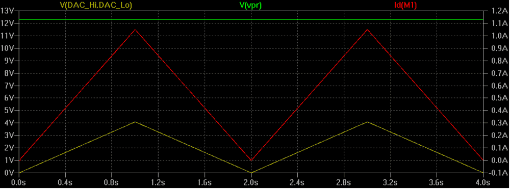

  • #31
Here is a proof of concept. LTspice .asc attached as floatearth.asc.txt, remove .txt to run it.
DAC produces Vdac, perched on 50 volts of AC noise.
Pre-regulator makes Vpr ≈ 12 volt rail. Select a cheaper MOSFET, adjust zener voltage.
No model here for a 5 volt regulator following Vpr, here it is V7805. Called Vcc = 5V.
Supply rails do not need to be precise.
I have no model for the AD629 chip. Replace B_AD629 with a model.
Select two op-amps for Rail to Rail input and 15V supply.
  • floatearth.asc.txt
  • #32
Not having used DACs for decades, I have a couple questions.
Are DACs available with 50V isolation between the digital input and analog output?
If the DAC is voltage output, what is the source for the Reference input?
  • #33

  • #34
Basically if using an opto as a linear device its best to wrap a control loop around it since they are not very good at being linear, you'd have to use PWM or something if the opto was open loop.
Beyond me doing an actual schematic review, on the surface what you have should work.
Regarding the whole current sense thing, I don't know if I like using high CM input amplifier to achieve this isolation thing, which is hilarious because that's precisely what I'm using (INA series from ti) although its sensing phase current in poly phase inverter (so the CM amplifier rejects the PWM voltage), so grounds are ~ same, well they beep out with multi meter, but due to the 100's of A of current being switched very quickly, there is a lot of inductive kick generating ~10V transients at full load. The seem to do the job well and haven't failed yet after some pretty nasty life testing, so maybe my "feelings" are off here.
Have you considered something like hall based contactless sensing? Would certainly put to bed any concerns re different grounds on the sense amplifier.
Eg:
https://www.melexis.com/en/products/sense/current-sensorshttps://www.allegromicro.com/en/Pro...-To-Fifty-Amp-Integrated-Conductor-Sensor-ICs
  • #35
@Baluncore I asked about the 50V isolation
Baluncore said:
Not DtoA that I know of. There are isolated AtoD available. Isolation of serial data input is most energy economic, so if isolated DtoA were available it would probably be with a serial data I/F.
because the schematic you show has the digital ground on one circuit and the analog output connected to a device with Gnd reference different by 50V . I was wondering if this is an appropriate configuration.
https://www.physicsforums.com/attachments/schematic-png.247128/
And the question about the DAC reference source has the same concern. The internal switching transistors in the DAC will be subject to the 50V Gnd difference if they are driven directly by the digital logic.
In light of the above, I believe the DAC must have galvanic isolation to avoid the different Gnd voltages appearing between the digital and analog pins.
