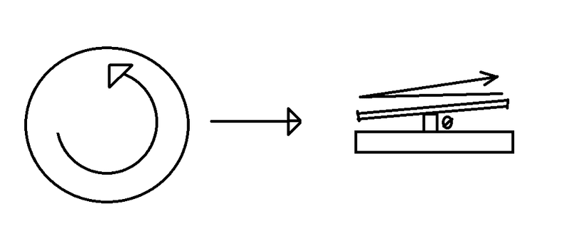

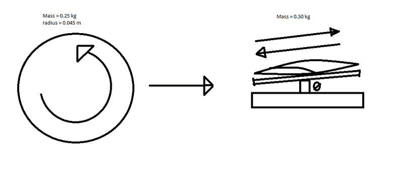

BvU said:
Or perhaps an informative drawing ?
Not sure if this makes the most sense, but the circle is from a transverse view and the platform rocker is from a coronal view.

akwok said:
currently using a mixer that rotates clockwise
Sorry, how does rotating a fluid filled container cause efficient mixing?
The assumption for the rotation mixing is that the agitation rate would be high enough through swirling to mix over long periods of time as rotating does not keep particles in the same field due to the shape of the container being that of a conical flask. When placed into experimentation, the mixing does occur, but I would like to place it into the system of rocking in a sterile bag instead of rotating/shaking in a flask.
So, if I understand correctly you want to know what parameters (speed, angle) of the rocker would give "similar" results as the rotation mixing? Similar meaning same time to mix a particular fluid?
I don't think there is a simple answer for this as the fluid is moving in a highly complex way (the more complex usually the better for mixing). You will have to experiment.
