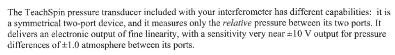

The pressure gauge just states on the back of it that 1atm is plus/minus 10V.
My lab manual only states the following regarding the pressure gauge :

I have a inclination to just leave both axis in terms of Volts, but I did just come across this in my lab manual:
Do you think it would still be appropriate to leave it in volts in this context?
Why is the lab manual concerned with the slope of the index of refraction vs. pressure graph? More importantly, why have you taken all these measurements? What is the object of your experiment?
Also, I question the necessity of having to worry about ##P_i##. If you used a decent mechanical pump to evacuate your chamber, you can safely assume that ##P_i \approx 0## because, in all likelihood, the mean free path of the air molecules is greater than the size of your chamber.
