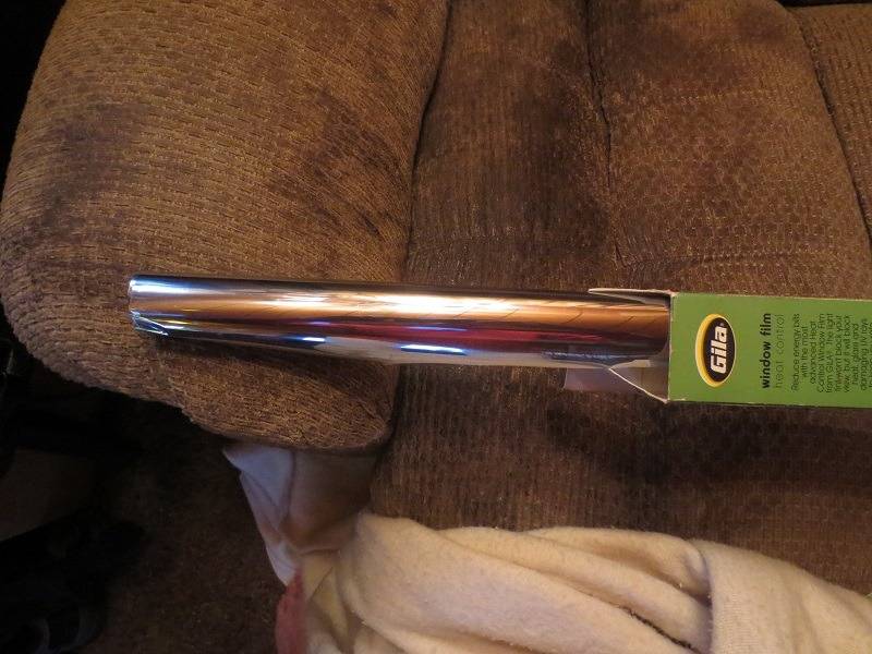

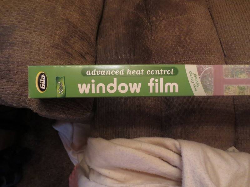

  • #51
BvU said:
What's the stuff supposed to do ? Alu foil reflects a lot better I would expect ...
from: https://www.google.com/search?q=wha...0j0i390l4.11273j0j15&sourceid=chrome&ie=UTF-8
It is a polyester film construction generally made of Polyethylene Teraphthalate (PET). Most films are applied to the interior surface of a glass window in a home, commercial building, or vehicle. They have a scratch resistant coating on the outer surface to protect the film. There are many types of window films.

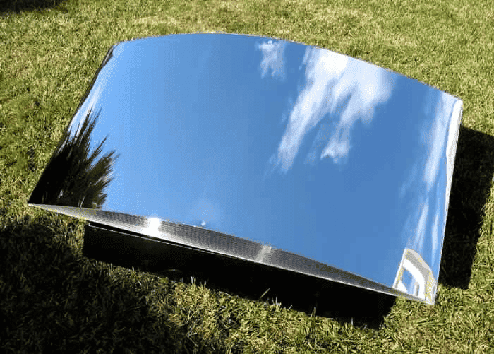

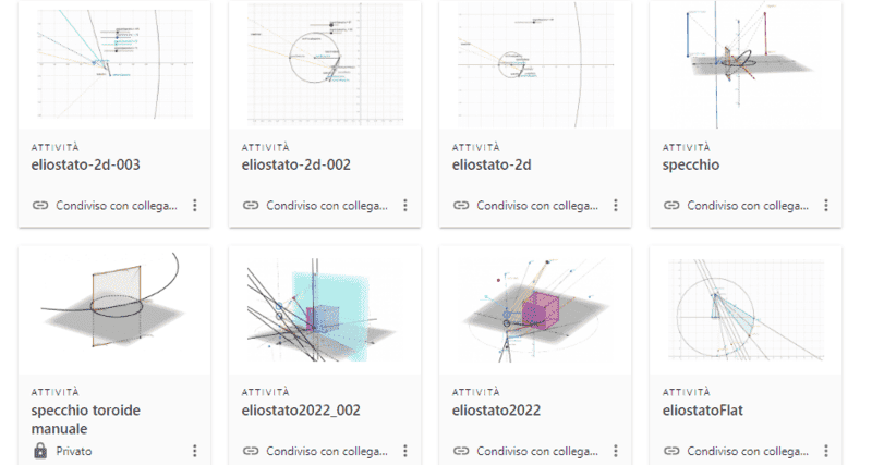

I am studying this topic since a long time... and didn't find a solution yet; not a static one, anyway; for a moving mirror I created a program which calculates the needed orientation of a mirror, given a position in the world, to constantly reflect the sun into a static point:
https://jumpjack.wixsite.com/progetti/ipsun
But it's very hard to find a pan/tilt mechanism which can be easily interfaced to such a software: the camera I used was just a "feasibility study", it's too weak to be useful for a big mirror; and I don't want to spent months on building and testing my own pan/tilt device, so if anybody could suggest a ready-made product wihch can be externally controlled at degree-level precision, I would really appreciate it. I think we should also focus on "RS-485 Pelco D protocol" for remote controlling, and the "key" is "absolute positioning".
In the meantime, I found this static mirror product:
http://cleardomesolar.com/solareflexpanels.html
I tried to reverse-engineer it, currently without success (and without help...)
I did a lot of experimenting with geogebra, but as of now I didn't yet find a valid geometry. You can find here my million of experiments...
https://www.geogebra.org/u/jumpjack
I think that probably the final outcome of this study won't be a single mirror, but a "tower of mirrors": I imagine a stack of small 20x20cm mirrors, probably at least 4 "floors" (one per season), each one made of 5-6 mirrors with different orientations, each mirror reflecting sun into the window for a couple of hours, but this is just an hypotesis.
Maybe a double-mirror system would be even better: the "tower" reflects the sun in different location inside a window-sized mirror set, which then reflect all the different reflections into one single point.
Can anybody help designing all of this in geogebra?

  • #61
Point is: is it just cylindrical, or something else?
Continuing my simulation I found the possibly it is cylindrical, but also that a discrete mirror would work better than a continuous one, because each mirror would reflect into the window a "box of light" as large as the mirror itself, without attenuation due to curved surface.
I am now trying to calculate the best curvature of the cylinder and best width of the single mirrors to have several "suns" traveling across the window along the day.

  • #69
jumpjack said:
About "sun capturing" surface, I wonder: if it was possible to design a "multimirros structure" which concentrates the sun light from 1 m2 into a small pipe 10cm wide and 10 meters long, how much of the original light would came up from the other edge, assuming the interior of the tube is a mirror? Of course I don't have enough space for a 1m diameter solar tube!
Certainly. A concave mirror could focus the light into a narrow mirrored tube. You'd lose a small percentage of light with each bounce off of the mirrors, but should have plenty of light left at the end. Throw in some flat mirrors to track the Sun and you'd have what you're looking for.
But that's a rather convoluted way of getting some sunlight into a building when things like skylights and roof windows exist.
