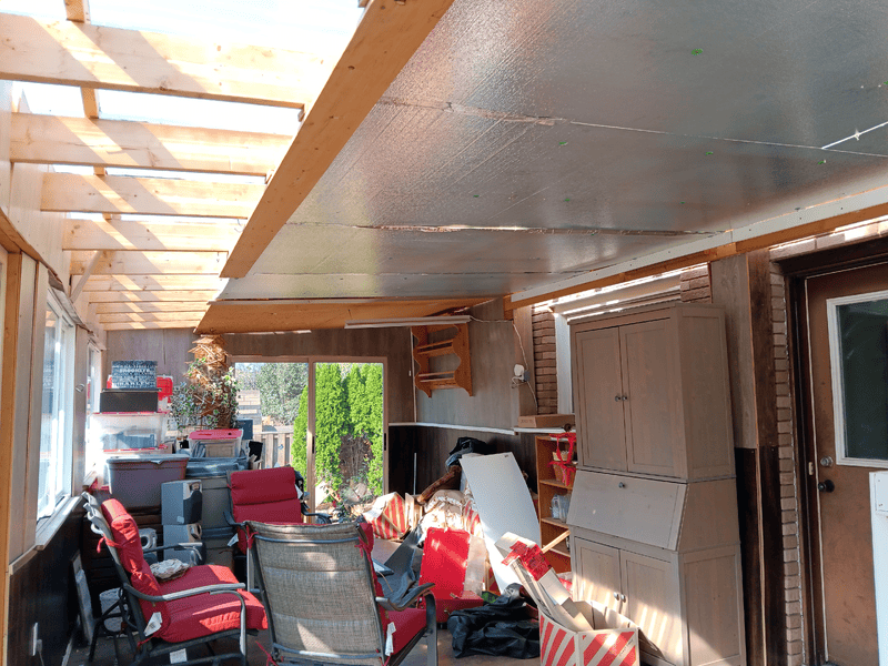

I've got this 300 square foot sunroom off the back of my house. It was hastily and amateurishly assembled by the previous owner. It's got a clear, corrugated panel roof, and large windows on the south and west walls. There are lowered panels that block much of the roof light (which probably just means it's creating a little greenhouse there above the panels).
I keep the wndows open and a good cross breeze stops it from turning into an oven. But it's still just a bit too hot for comfort. I bought a portable air conditioner (14,000 BTU) to see if I can bring the temp down to a more tolerable level.

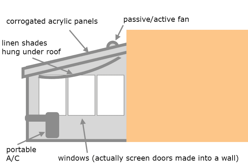

Now that you mention it, I'm not so much interested in a direct sun room as a shade room. I like the bright outdoor light, but no direct sun for me. (I go to Cuba twice a year and spend the whole time in the shade.)
These shades, they go inside? i.e. hang them under the transparent corrugated panels? I'll make them loose-weave enough to let some % of light in. I guess white is better to reflect. Maybe linen or gauze.
Thus?
With a highly reflective material it might mean some help, but in general if it is dealing with the radiation inside then the associated heat will remain inside (the greenhouse).
Agreed with Rive, putting them inside is not ideal. I would put it on the outside with at least a few centimeters of standoff if practical.

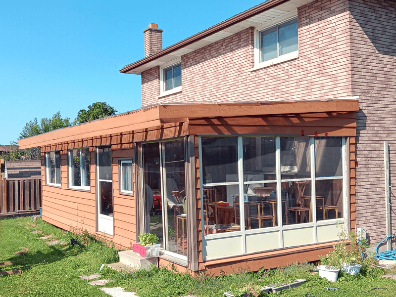

DaveC426913 said:
Sure but how would that work? I can't put curtains above the roof.
Can you post a photo of the area in question? I might have some ideas.
Looking North:
That slope is certainly not to-code. It's about 1:12.
(Don't judge me. We're still moving in.)

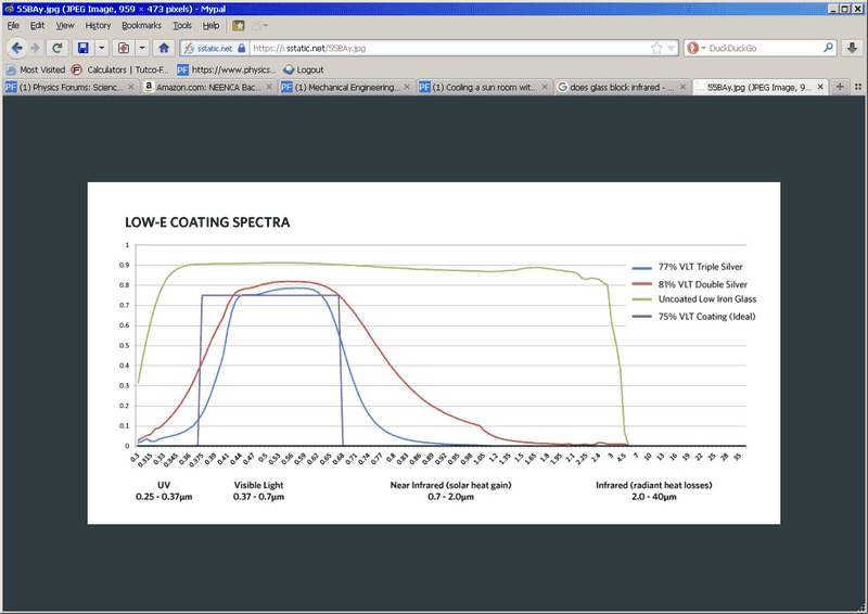

DaveC426913 said:
What material can I use that will give me overhead light? I realize this is an oxymoron - wanting to let light in but not wanting the heat.
I have so called Magic Glass on my conservatory roof and walls. (This a different house than the last one with blinds.) It lets visible light in but blocks IR. The energy in the narrow visible range is very little compared with all the rest. In sunlight, the conservatory doesn't get intolerably hot but, in winter, the 'contained' heat keeps the inside warmer than outside. This is in the south of UK so we seldom get excessive temperatures (that is until things started to go silly recently)
I found this ad. Others are available and I don't know the name of my supplier but you get the idea.
10K
