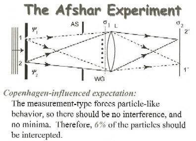

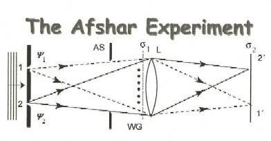

Afshar Setup
The following summary of the Afshar experiment may prove helpful.
Afshar experimental arrangement:
A beam of light of fixed wavelength from a coherent source is incident upon the following sequential arrangement:
- double-slit [1, 2]
- wire gird [WG]
- lens [L]
- particle detectors [1' ,2']
See diagram.
Some details:
1) The wire grid WG consists of wires placed at the positions of the (would-be) interference minima (for a screen placed at that distance from the double-slit).
2) The lens L is such that rays from slit 1 (2), in the absence of any obstacles, will be focused at detector 1' (2').
3) With only one slit open, and WG in place, the detector experiences a 6% loss relative to the setup with no WG. WG is therefore said to have 6% opacity.
Summary of reported results:
a) No WG + both slits open --> no loss;
b) WG + only one slit open --> 6% loss;
c) WG + both slits open --> < 0.1% loss.
Conclusion:
Since the results of c) are very nearly the same as those of a) and, on the other hand, appreciably different from those of b), the situation in c) must be that of "wave-like" behavior (i.e. the quantum system interacts with both slits, and not just one slit). That is to say, two waves are propagating, one from each slit, and in the vicinity of WG these waves overlap and interfere to produce minima at the locations of the wires in WG. For this reason, WG is essentially transparent to the incident beam.

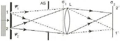

Two Measurement Options:
Take a look at the diagram. It shows a modification of the Afshar setup in which the wire grid WG has been removed. For this setup, consider the following two measurement options:
(a) Before light can reach the lens, at a screen labeled
sigma1, measure an interference pattern;
(b) After light has passed through the lens, at a screen
labeled sigma2, measure two distinct, separate images,
situated at 1' and 2'.

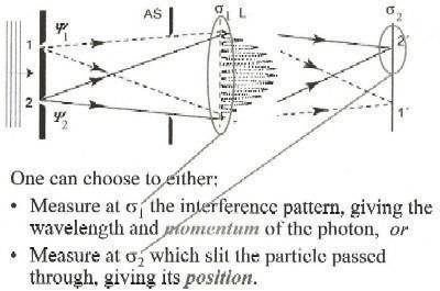

Cramer's Rendition:
Here is what Cramer has to say, in the name of "Copenhagen", regarding these two options (see diagram):
(C-a) Measure at sigma1, the interference pattern, giving the
wavelength and the momentum of the photon;
(C-b) Measure at sigma2, which slit the particle passed
through, giving its position.
Complementarity:
By statements (C-a) and (C-b), Cramer purports that, according to the Copenhagen Interpretation, the following is true:
P1: Options (a) and (b) are experiments which measure complementary attributes of the quantum system.
Argument for (C-b):
Cramer's statement (C-b) regarding option (b) is built upon the following type of argument:
P2: A photon arriving at 1' (2') must have passed through slit 1 (2) and not 2 (1). Therefore, a measurement at sigma2 corresponds to a "determination" of which slit the photon went through.
Since this type of argument serves as a basis for Cramer's statement (C-b) concerning (b), and (C-b) itself is said in the name of "Copenhagen", it must be that the precise sense in which an argument like P2 eventually leads to Cramer's (C-b) is seen by Cramer to be deemed valid by the Copenhagen Interpretation.

In a final step, the wire grid WG is put back into the arrangement of (b) to give, once again, the Afshar setup. With all of the above in mind, Cramer then concludes - in the name of "Copenhagen" - regarding the Afshar experiment (see diagram):
The measurement-type forces particle-like
behavior, so there should be no interference, and
no minima ...
This statement makes the intended meaning of Cramer's (C-b) absolutely clear. That intended meaning is equivalent to the following proposition:
P3: In option (b), the measurement performed at sigma2 is physically equivalent to a nondemolition measurement which takes place at the site of the slits and determines which slit the photon passes through.
To repeat, according to Cramer, P3 (like the propositions P1 and P2 above) is deemed correct by "Copenhagen".

So the claim that a measurement at sigma2 corresponds to a "determination" of which slit the photon went through, is no stronger than EPR's claim that given two "paired" particles S1 and S2, a position measurement on S1 "determines" the position of S2.
Bohr, by contrast, insisted that we can only infer from a position measurement on S1 what the position of S2 would be if we measured it. If we measure S2's momentum instead then we disturb the system sufficiently to nullify the inference.
In Afshar's experiment, what would we need to do similarly to nullify the claim that a measurement at sigma2 "determines" which slit the photon went through?

Afshar admits that, in the end, he is unsure what his experiment means in detail for quantum theory. "We are back at the fork in the road encountered by Bohr and Einstein, and avoided entirely due to Bohr's ingenious complementarity," he says.
But we've still got a wave that's a particle, and a particle that's a wave. What are we to make of that? Well, Afshar says, there are two choices. The first is to shrug your shoulders and concede that human logic and language will never explain what is going on. The second option is to conclude that the particle phenomenon isn't really there, and to use the wave picture for the entire experiment. In this interpretation, the interference pattern and which-way information are not logically inconsistent - the waves do go through both slits, while the "image" each detector sees corresponds to light waves from only one of the pinholes.
Afshar believes the second option is the simpler and better choice, which leaves a big question: is there any such thing as a photon?
The photon detectors in Afshar's experiment "click" when they detect a photon. But if there is no photon, what are they seeing? It comes down to the interpretation of Einstein's photoelectric effect, the experiment that "proved" the existence of the photon - and won him the 1921 Nobel prize. Afshar says the American physicist Willis Lamb and others have explained these particle-like clicks as a result of the interaction of unquantised electromagnetic waves and quantised matter particles in the detector. So although Einstein was right to doubt Bohr's complementarity, he was "right for the wrong reasons", Afshar says. "In order to declare Einstein the winner of the Bohr-Einstein debate, we must take back his Nobel prize. We have no other choice but to declare the idea of Einstein's photon dead."
To this, I would like to add: not only is it "no stronger", but it is "definitively weaker". That is to say, the degree of "determination" in the sigma2-measurement is less than that which occurs in the EPR scenario. Specifically, in the language of "collapse", the sigma2-measurement does not "induce" a "collapse" at the slits, whereas in the EPR scenario, the measurement upon S1 does "induce" a "collapse" with regard to S2.
To put it another way, in the simga2-measurement scenario (see diagram), the two cases of "no, we do not perform a measurement at the slits" and "yes, we do perform a measurement at the slits" are physically distinct; that is, by introducing a suitably chosen identical "element" into each of these cases, we find that each case will exhibit distinct quantum phenomena. For the EPR, scenario, on the other hand, there is no such "element" which can be introduced into each of the cases ("no, we do not perform the position-measurement on S2", and "yes, we do perform the position-measurement on S2") that will distinguish between the them.
... what would we need to do similarly to nullify the claim that a measurement at sigma2 "determines" which slit the photon went through?
