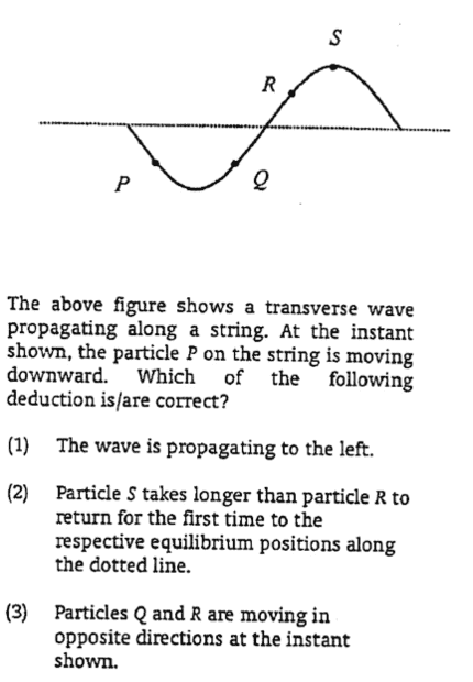

Correct statement about transverse wave propagating along a string

My answer is (1) only but my teacher said (3) is also correct. I don't understand why, I think when the wave is moving to the left both Q and R will be moving upwards, no?

Seems that way to me : you could ask them to expand on their response, see if they have the right particles.

Only 2 is correct. 1)Since P is moving downward the wave is going to right as p approaches to right. 2)Yes, since R has a longer way to go. 3) Both are going to right.
P is not moving left or right, just straight down, and the wave is moving left.
Yes.
How do you mean that? This is a transverse wave and the points on the string can only move up and down.
No. Each point on the string is moving up or down only. For P to be moving down, you need to find the displacement direction of the wave for which the wave at P is lower in the next instant. This occurs when the wave moves left.
2) No. The wave will have passed S completely first and the statement is false.
3) Is false regardless of direction of wave motion.
Please do not confuse students if you are not 100% certain of the answer.
To put that in slightly more mathematical terms:
A wave moving left/right is given by the displacement ##u(x,t) = f(x \pm ct)## (with upper sign for a wave moving left). At a given point ##x = x_0##, the up/down motion of the string is given by ##u_t(x_0,t) = \pm c f'(x_0 \pm ct) = \pm c u_x(x_0,t)##. The string is moving down at ##x_0## if this is negative. Since the x-derivative at P is negative, we need the positive sign for the full expression to be negative, i.e., the wave is moving left.
