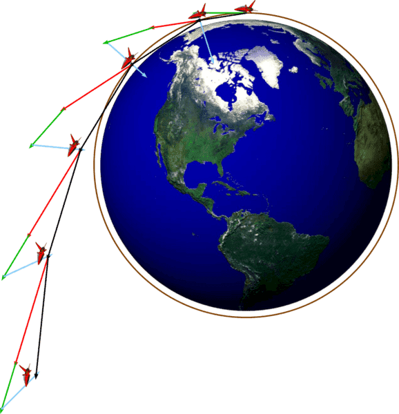

I had an image I made that seemed to visually explain the rail idea. It was of a 1G ship taking off from a 1G planet using a launch rail.
It uses vectors to show the different forces as I see them and, admittedly, discounts friction and atmospheric drag.
The brown circle is the hypothetical rail.
The ship's acceleration vector is in Green, the planet's gravitational vector is in Blue.
The projected path is in Red and the actual path is in Black.
Basically, the rail acts as another vector acting against gravity by limiting the effect of the planet's gravity vector. Once the speed is high enough, the ship's resultant lifts it off the rail and gravity is insufficient to bring the ship down.
Granted, I've taken liberty concerning the actual path of the ship; I've ignored the curvature of the track and substituted the straight black vectors. But, if you shrink the time scale down, eventually the straight black vector is indistinguishable from the curved track, but the vector math would still apply.
Now, I'm not perfect. If anyone can show me any mistakes I've made here, I'll be happy to hear them - well, *read* them. The image seems correct, but my gut is still telling me a 1G ship is trapped on a 1G planet.
So you accelerate horizontally along the rails up to surface orbital velocity while still supported by the rails. Sure, that works. [If you can ignore that pesky air resistance]
Orbital velocity is the point where the curvature of the ship's path under the influence of gravity is equal to the curvature of the rails beneath it. Having achieved orbital velocity, continued thrust will eventually take you past escape velocity for the then-current altitude.
Yes.

If you are running the aircraft on a rail, the downward gravitational force from the Earth is offset by the upward force from the rail. Your analysis is correct that if you accelerate at 1g or even much less than 1g for long enough, you can build up enough speed to have what is known as the "escape velocity". Even in the case without a rail, where you have flaps on the wings, with the upward force from the air pressure that can offset the force from the Earth's gravity, what matters is the speed in the forward direction.## \\ ## (Edit: Additional item=in principle it requires no expenditure of energy or any work required to maintain a constant speed at a given altitude. In some cases, especially with atmospheric drag, engineering this is another matter. Outside of the atmosphere, one way to achieve this is to be in a circular orbit. In this sense. the gravitational force of ## F=mg ## does not need to be overcome. As previously mentioned, if the object is made to accelerate in its direction of motion, that acceleration increases its speed, and the escape velocity is the determining factor here ). ## \\ ## The acceleration of "1g" is not the hurdle here. The hurdle is the gravitational binding energy=see below. A stronger gravity=higher ## g ## goes hand-in-hand with a higher binding energy, but the actual hurdle is the binding energy=see below. ## \\ ## And the "escape velocity" comes about because the gravitational binding energy (at the Earth's surface) ## U=-\frac{GM_e m}{R_e} ## is equal (and opposite) to the kinetic energy ## K.E.=\frac{1}{2} mv^2 ## when ## v ## is the escape velocity. The object has enough energy when ## v>v_{escape} ## that its trajectory ultimately results in being basically an infinite distance away where there is no gravitational pull, and if you compute the final velocity, you will find it still has some speed in the forward direction away from the earth, because the total energy is conserved. (## U=0 ## at ## r=+\infty ##. Meanwhile ## K.E._1+U_1=K.E._2+U_2= ## total energy, and total energy is positive if the object has the necessary escape velocity).
It's not only possible, but in some scenarios (no atmosphere, low friction rail) it might be the most efficient way to get away from the planet. It minimizes the losses due to gravity drag:

As has already pointed out, you will remain on the track until you reach orbital velocity (~7.9 km/sec). This will occur after you've been accelerating for ~13.5 min. and after you have traveled 3189.4 km along the rail. After this, you will be in an orbital trajectory. Even if you were to cut your engines at this point you would remain in orbit.( neglecting air resistance) Continuing to accelerate will push this orbit further from the Earth (At what rate you accelerate doesn't matter, even an acceleration of 0.000001 m/s2 would cause you to slowly climb away from the Earth*). As you climb, you will exchange velocity for altitude. (you won't gain speed as fast as you did while on the track). Unless you take active steps to do so, the nose of your ship will drift from pointing in the same direction as your velocity vector. (once you enter orbit, your craft will continue to point at the same point in the sky, while your trajectory will continue to curve. Thus your line of thrust will shift more and more towards the vertical with respect to the Earth. At some point your velocity will exceed the escape velocity for your altitude and you will fly away from the Earth even if you provide no more thrust.
* in fact, you could have been accelerating at 0.000001 m/s the whole time, it just would have resulted in taking more time and distance to reach orbital velocity.(250 1/3 yr and nearly 77869 circuits around the Earth.)
