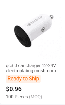

To reinforce @DaveE 's point. This power supply is for sale on alibaba.com. 12V in, USB out. I expect they have a good market and many customers satisfied by the lifetime at that price. $0.96 each.
Is it better to design a higher quality device that lasts longer? Maybe yes. Maybe no. Customers might prefer to discard them as they fail rather than invest 100x more up front for a long life device.

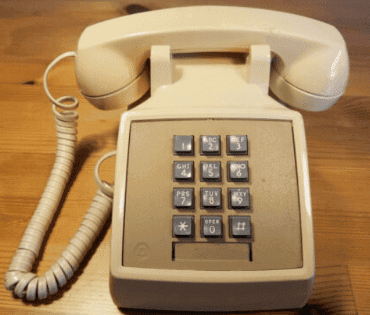

I can even make a good case for planned obsolescence. I remember one summer around 1980 when I returned my phone to AT&T. I found a mountain of returned phones in the phone company's lobby. Nobody wanted them.
Western Electric bragged that those phones were designed to last 45 years. Who in their right mind would want a 45 year old phone in today's world?
How do you open that phone to see the display?

I have that very phone buried in a closet somewhere. I originally kept it so I can make phone calls if the power goes out, but I'm 99% sure that was before I had a cell phone. You can have it for free if you come pick it up.
Now it's a testament to how much useless crap I have squirreled away. I think 6 oscilloscopes at last count, plus one I actually use occasionally.
