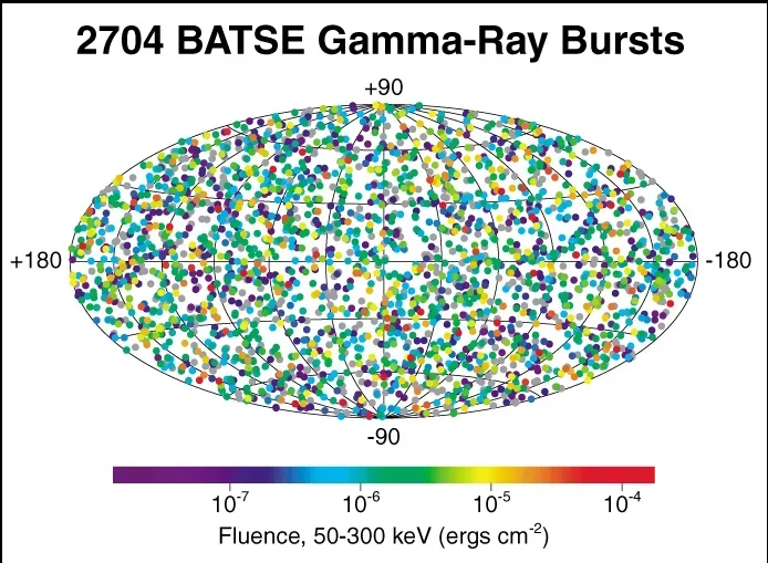

Gamma-ray bursts may have an intragalactic origin, as suggested by the distribution map of these bursts, which shows anisotropy due to absorption by dust and gas in the Milky Way. The argument posits that if gamma radiation is absorbed by interstellar components, fewer observable bursts would originate from the Milky Way, leading to a minimum in the plane and center of the galaxy. The map's visual distortion creates an illusion of greater density at high latitudes, which could misrepresent the actual distribution of bursts. Even with a seemingly uniform distribution, this does not confirm an extragalactic source, as bursts could still arise from a concentrated region within the Milky Way. The discussion highlights the complexities in interpreting gamma-ray burst origins and their spatial distribution.
Line_112
49
TL;DR Summary
This is indirectly evidenced by a map of the distribution of gamma-ray bursts in the night sky, made in the form of an elongated globe. And also the weakening of gamma radiation by the disk and the center of the Milky Way.
This is indirectly evidenced by a map of the distribution of gamma-ray bursts in the night sky, made in the form of an elongated globe. And also the weakening of gamma radiation by the disk and the center of the Milky Way, which leads to anisotropy in the possibilities of observing gamma-ray bursts. My line of reasoning is as follows:
1. Gamma radiation should be absorbed to some extent by dust and other components of the interstellar medium. As a result, with an extragalactic origin, fewer flares accessible for observation should come from the Milky Way, that is, anisotropy should appear on the map of their distribution, with a minimum in the plane and in the center of the Milky Way.
Since even the Earth's atmosphere absorbs gamma radiation (and much more effectively than visible radiation), being almost transparent to visible radiation, it is difficult to imagine that gas and dust clouds in the center and in the plane of the Milky Way, which are opaque to visible light, will be absolutely transparent to gamma radiation, especially since they essentially contain the same components as the atmosphere, only in a different ratio.
2. The sky map for gamma-ray bursts is given as a stretched globe, on which high latitudes are visible as if at an angle, although in fact everything in the sky is distributed equally. The size of the dots on the map is the same everywhere, and in theory it should be smaller at high latitudes due to the visual flattening of the dots, the plane of which is at an angle to us. This creates the illusion of greater density of dots at high latitudes. In addition, the equator is greatly stretched horizontally, which means that in the case of a uniform distribution of bursts in the sky, there should be a lower concentration of points in the equatorial zone on the map. Just as if we were to stretch a sheet of rubber to the right and left at the same time, the central part would stretch more strongly and the amount of rubber per unit area there would be less than closer to the edges. If we mentally compress the equatorial part of the map so that we get a round globe (as it should be on a spherical sky), then the concentration of points in the equatorial zone will increase. If this logic is correct, then this can also be an explanation for the apparent relative uniformity of the distribution of gamma-ray bursts, and in fact their concentration is towards in plane and in the center of the Milky Way.
In addition, even if we consider the distribution of bursts to be completely uniform, this will not yet be proof of the extragalactic origin of the sources. They can just as easily occur within a sphere in which the concentration of stars and matter is roughly the same (within a radius of half the thickness of the Milky Way's thin disk). As for cases of association with galaxies, I don't know how many there have been of gamma-ray bursts (perhaps few).
But to what extent? Attenuation by 10 or even 90% doesn't preclude detection. It's not all or nothing. You can't just hand-wave it and call it a day.
Rather than coming up with fanciful arguments of dubious value (no, the ISM is very much not like the atmosphere in composition or attenuation properties) check the literature. Read up on methodology of gamma ray observations, maybe try and find extinction maps for high energy astronomy. You want numbers and understanding, not pictures and guesses.
This is your main argument, and it's based on not understanding how sky map projections work.
The map is an equal-area projection. Probably Hammer. Equal-area projections are chosen specifically because they don't distort relative areas. They only distorts angles and orientations (shapes). That's why they're good for density maps. The density of signals is >not< distorted.
The argument about how you think you can stretch the map to fit a sphere is neither here nor there. If in doubt, take it up with the maths.
And the dots in the attachment are not distorted at all, because they are markers of point-like sources, and not any sort of representation of the areal extent of the signal. Their shape and size is not a part of the map. If they were, they'd still have the same sizes, because it's an equal-area projection.
Line_112 said:
On the map, there are 180 pixels between the poles, and 360 along the equator. But the celestial sphere will have 360 everywhere
No! The N-S is half the length of E-W, because a meridian on a sphere is half the length of its equator! Figuratively, the sphere is split along a meridian and unwrapped. When you go 'east' beyond the edge of the map, you end up on the 'western' edge. But when you go 'north' past the edge, you come back from the north.
These projections are also used for the globe of the Earth, where you can see this clearly. You can't circumnavigate the globe by going from one pole to the other, once.
As a general rule, if a source provides you with a statement - like the one that the data is isotropic - and illustrates it with a figure you're unsure you understand, then the first instinct should be to verify your understanding - not to doubt the underlying claim.
The debate over the origin of the GRBs is now some three decades old. There's plenty of peer-reviewed publications to refer to.
References to random websites are not acceptable on this forum. If you find an argument on a website that you want to bring up, track down its source publication.

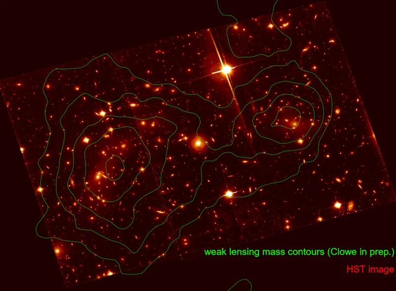

Line_112,
I have two things to say to you, which I will do across two separate posts.
Below is a contour map of weak gravitational lensing, taken from the Wiki page on that subject.
https://en.wikipedia.org/wiki/Weak_gravitational_lensing
If I claimed that there was a spherical structure in this image, caused by a gravitational lensing phenomena that I have cited no values for, would you be persuaded by my claim?
And would you be further persuaded if I also claimed that this map is actually an illusion, with the spherical structure there, but unable to be seen by us?

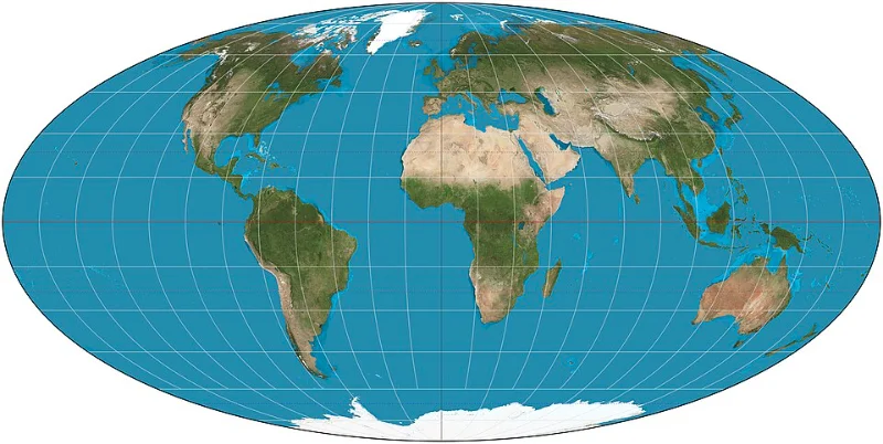

But I still don't understand how you can unfold the globe without distorting the proportions. Usually they show two hemispheres separately, then both have a rounded shape. And the map of gamma-ray burst distribution doesn't remind me of a geographic map at all. In order to lay out the entire surface of the sphere in the form of a map, you need to tear it apart, turning it into a piece of canvas. Then the proportions will be more or less maintained. But here we see a contraction towards the poles. Once I tore ball apart and got a two-headed torn structure in the form of a canvas. There is +-, but the proportions more or less corresponded to what was on the surface of the sphere.
Plus, high latitudes "look" not at us, and the dots, as you right wrote, are simply superimposed on this matrix and have the same sizes everywhere. This means that near the poles, in the case of a uniform distribution of gamma-ray bursts on the celestial sphere, in theory, there should be a higher visual concentration of points than near the equator, but we do not see this, which logically should mean anisotropy (I will not confirm this, but this is how it seems to me).
In any case, such puzzles are very entertaining, especially when it comes to things of an astronomical scale. Moreover, gamma-ray bursts are among the main astronomical threats, but if it turns out that they have an intragalactic nature, then the danger will be greatly exaggerated.
Here is an equal area projection map of the Earth, similar to the GRB map. Areas are not distorted, but of course shapes are. It's not possible to map a spherical globe on to a flat sheet of paper without distorting something. But these equal area projections have the advantage that area is preserved. That's why the GRB map shows a uniform density.
Okay, so I was wrong with that argument. But remain two more - the highly probable absorption of gamma radiation in the plane of the disk and the fact that the dots on the gamma-ray burst map are not inserted correctly. Since these dots (spots) do not geometrically belong to the map itself (unlike the continents on the sample of the world map you presented) and are the same size everywhere, a false sense of their density increasing in the direction of the poles is created, as well as to the right and left in the temperate latitudes, where the surface of the globe is also located at a strong angle relative to us.

I haven't studied this issue enough to have a clear opinion. It seems to me that both the extra- and intra-galactic variants are possible. But scientists should in any case check the absorption capacity of the Milky Way disk (if it hasn't been checked yet) to give preference to one of these variants.
I see.
The map you posted does give preference to the extragalactic origin of GRBs because there is no clustering of them on the plane of the galaxy, which would have been the case if they were intragalactic.
But you clearly cannot bring yourself to admit or accept that.
My three questions (which are based upon the science of galactic rotation) also give preference because they rule out the possibility of there being a spherical subsystem of intragalactic GRBs.
But you clearly cannot bring yourself to address them.
I therefore wonder, if, when the absorption capacity of the Milky Way disk is found to rule out the possibility of intragalactic GRBs, you would dismiss that finding and continue in your beliefs?
Beliefs for which you have presented no real evidence, which are not supported by the available evidence and which do not stand up under questioning.
Goodbye, Line_112.

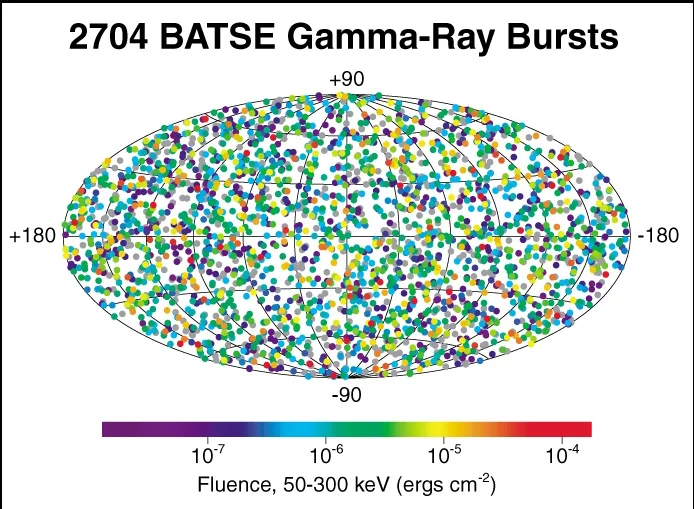

The other is that a dot of the same size on this map at the equator will cover a smaller area of the sphere's surface than in other parts of this globe.
Why do you think this? It is an equal area projection. So dots of the same area will cover the same area of the sphere.
