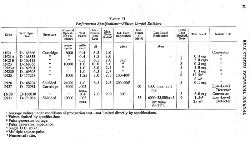

Here are some comments from my limited understanding. (I invite Baluncore and other experts to correct me if I go astray.)
1) Piezoelectric operation for the tan headphones seems right. See, e.g.
Amazon earphones
They have an impedance of a few thousand ohms. Why not 8 ohms, which is standard for HiFi/stereo speakers and headphones? Because of the need to match the load impedance to the crystal rectifier. The broadcast AM band is, for discussion purposes, pretty close to DC so we can look at the DC impedance of crystals, which is typically a few hundred ohms (see, for example, the center column in this table from Scaff and Ohl, Bell System Technical J., 1947).
These World War II microwave diodes literally used cat whiskers and semiconductor crystals inside of a cartridge.
Choosing the load impedance is a balance between best power transfer, which occurs with a matched load (500 ohms, say), and good selectivity (narrow bandwidth to capture just one station at a time) which requires high Q and therefore high impedance. I'm guessing that ~3000 ohms was empirically arrived at as a reasonable compromise.
EDIT: Another consideration is the need to forward bias the diode over at least part of the RF cycle in order to provide rectification. For a given power intercepted by the antenna, a higher circuit resistance will provide higher voltage across the diode. The forward drop sets the minimum voltage: 0.3V for germanium and 0.7V for silicon.

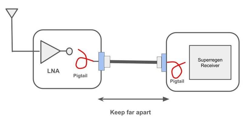

Swamp Thing said:
A superregenerative receiver for the aircraft band could be the next project.
Please don't use simple regenerative or super-regenerative receivers.
Regenerative receivers re-transmit on the listening frequency. Super-regenerative receivers also re-transmit on the channels above and below the listening frequency.
You do not need the attention you will get from an unattended 'Jenny' on the air-band.
Likes sophiecentaur

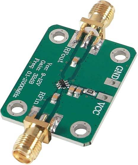

Best use one of these black box LNA things to isolate the antenna from the superregerative circuit's input.
https://www.amazon.com/HiLetgo-0-1-2000MHz-WideBand-Amplifier-Noise/dp/B01N2NJSGV?tag=pfamazon01-20
You likely won't need to actually wire the output of the LNA to the receiver; you just need to glue a short piece of insulated wire with one end near the output of the LNA and the other near the input of the receiver, and put both into a metal box.
Just like a feedback oscillator, cavity-tuned.
On second thoughts, better still to put the LNA in one metal box and the receiver in another. Mount a connector on each box and run a coax. But in the receiver box you just have a short piece of wire hanging from the connector terminal and near the receiver circuit.

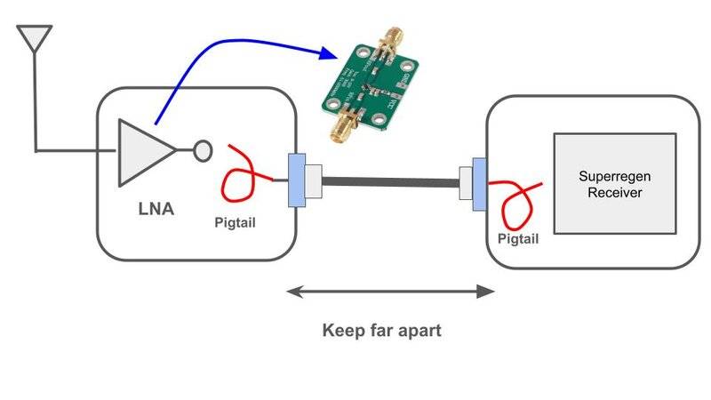

How about something like this? (See this post)
Edit: Purists might want to terminate the LNA output. Maybe even terminate the input and use a gimmick pigtail capacitor to the antenna.
Broadband LNAs are class-A amplifiers, that typically require a supply of 20 mA. That is a lot of power, compared to a minimum radio receiver, that should run on a couple of milliamps.
Unless you have a good RF filter at the input, an LNA will amplify everything, and cross-modulate the signals you want. I believe they are still prohibited from being connected directly to an antenna in Germany, because they oscillate, and transmit that oscillation from the antenna.
  • #33
As I'm sure you know, superregenerative receivers at VHF are extremely sensitive considering their simplicity. Plus, the LNA adds 20 or 30 dB gain depending on the model.
Because of this, we can use very small valued gimmick capacitors at the input and output of the LNA and still get a usable overall sensitivity while avoiding intermodulation. Typically, the modules have a 1 dB compression point of around 20 dBm.
These LNA modules are MMIC based, using MMICs that are found in many professional and consumer devices. They are usually unconditionally stable (i.e. very immune to oscillating even with open circuited inputs and outputs. And if we terminate at least the output, the chances of them oscillating would be minuscule unless some horrible mistakes have been made in the layout and decoupling on the PCB.
Even if the LNA oscillates, the radiation would be at a level comparable to other electronic devices typically found in the home, since its port are very weakly coupled to the outside world. Also, MMIC based modules of this type are used by many, many people at the inputs of SDRs, and not necessarily with input filtering.
Regenerative receivers have more than enough sensitivity. They can follow the noise floor without more gain from an LNA.
Why burn 20 mA, just to waste it in poorly coupled terminals. Gimmick couplers are unpredictable, something a beginner does not need with an introductory project. The receiver can be isolated from the antenna with a 1 mA FET RF stage, without an MMIC and 20 mA.
I disagree. For stability, they need to be terminated in resistive loads, usually with attenuator pads between stages. I have used MMICs in the first IF of broadband radar receivers, as the gain rises it takes more effort to tame the reactance and parasitic oscillations. I would never use such a wideband device if I did not need it for the signal. A regenerative receiver is inherently narrow band, and so is totally bandwidth mismatched to an MMIC. It is better to go with a tuned RF, FET front end.
Not so. When connected directly to an antenna, there is often a side frequency at which positive feedback encourages oscillation. That can be reradiated efficiently by the antenna. Much time has been invested, tracking down those nuisance oscillators.
If I were launching on a project to build and understand radio receivers, maybe.
I would start with a crystal set, add an audio amplifier (which means a power supply) to drive an 8Ω set of headphones,then maybe a 2nd stage to drive a speaker, the maybe an RF amplifier, then maybe replace the crystal, and so on. This might be one piece.
To keep my sanity, I'd probably put these all on their own small breadboards (Radio Shack used to sell them in various sizes). Modularity is an important consideration in enginering (how this started) and while there is no reason that electrical modularity demands physical modularity, doing this makes evolving the design easier: this audio amp is no good - let's try again.
Because this discussion got me thinking harder about impedance, each part would likely have some sort of impedance matching up and down the chain. If not matching, at least defined specs.
And, so people can mock me, I'd probably go from board to board with shielded ribbon cable. "That's not the right stuff!" you say! No, but I have a lot of experience with it, and would do a good job - better than on alternatives where I don't know what I am doing.
