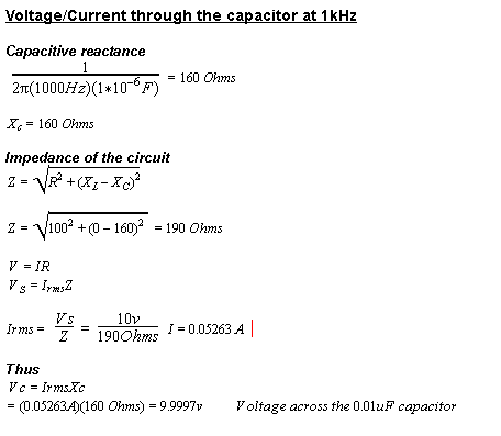

Hi , i was just wondering how would i find the current through a capacitor (Series RC circuit)
I found a questions online which asks to find the voltage and the current through a capacitor at 1kHz and 10Khz
Capacitor = 0.01uF
Resistor = 100 Ohms
Voltage Source = 10v
ive done some calculations but not sure they are 100% correct too
0.01 ##\mu##F is ##10^{-8}## F
so would it be 0.00062A across the capacitor ?

You have
With (a bit much, but elementary): $$\begin{align*} V_0 &= |V_0| e^{j\omega t} \\ V_0 &= Z_{\text tot} I \\ Z_{\text tot} & = Z_R + Z_C \\V_C &= V_0 {Z_C\over Z_{\text tot}} \\
Z_R &= R\\Z_C &= {1\over j\omega C} \\V_C &= Z_C I\end{align*}$$
easy to solve, no reason for uncertainty.

This is a sinusoidal steady state problem. For some reason you have calculated only the magnitude of the voltage and current and not the phase. Also, as others have mentioned 0.01uF = 10^-8 F. Not sure what is expected of you but since this is a series circuit just divide the voltage by the complex impedance which (at 1k Hz) in this case is just 100 - j * (1/(2*pi*10^3*10^-8)). That would be the current. The voltage would then be the current * (- j * (1/(2*pi*10^3*10^-8)). If you are just interested in magnitudes then of course take the square root of the sum of the square of the impedances and do the same thing.
