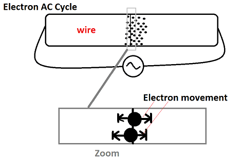

Hi,
I realized I didn't understand the physical model of something I know the theory of pretty well. I was considering the real power loss of an AC transmission line I2*R, then I realized that from source to load the electrons in an AC line don't actually move anywhere. (as far as I know) Yet if I'm running a three phase motor, it certainly draws current.
WARNING: Personal interpretation >> I know that 'electricity' isn't really about the movement of electrons. I'm not sure if it's the negatively charged electrons that move to contain the electric field in the conductor, or if EM energy passes through like a sound wave through the conductive media, really...The mechanism by which energy actually travels down a power line is a bit of a mystery to me. I do remember learning about TE, TM and TEM transmission lines in Adv EM, but I don't know if a simple AC or DC line is one of these. (it would be good if someone could explain it.
To make things more complicated I'm also trying to work out how a rectifier works, because I imagine that the electrons would have to jump across the PN junction very fast, but the drift velocity of an electron is about 8cms an hour. So yeah, in brief power lines can draw a lot of amps, which is a lot of electrons per second, so how does this happen, and how is there various levels of current in an AC TL?Sorry if I'm re-treading old ground, but I haven't found any succinct answers.
Hope I've made the Q's clear, thanks!

The electrons move back and forth at 60Hz (in the USA). They can do work moving in either direction. Frequently we want to be able to compare AC and DC circuits. Problem is what to use as the current for an AC circuit. Can't use the mean current because that's zero. To get around this we quote the RMS or Root Mean Squared value for AC current. Taking the square and then the root gets rid of the problem. Frequently the fact that it's rms is ignored. For example a power drill might be rated at 110V and 5A. Hoever they really mean 5Arms, it's not 5A like in a DC circuit.

Imagine that you were in hyper time, and a single second seemed like an eternity well for the first half of the AC cycle the current would look DC, then finally after as it reversed it would look DC again, just the other way. Fair way of looking at it? So say that the distance moved by the electrons was a scalar not a vector...I might need to draw a picture:
What if the total amount of electrons moving over an infinitesimally thin line over the line frequency oscillation, was the same as the total amount of current as DC? Does that sound right?
If we've got an open circuit TL from a source, do the electrons still jiggle?

Specifically my reasoning that over a short enough time-frame each half of the AC wave is just like DC, so really there is no difference. The point being, it doesn't matter how far they moved, the point is they moved, any movement is enough to do Work.(?)
So @jim hardy , you're saying that if I have a large HV load, the individual electrons in the load each have a larger electric field energy, but there are fewer of them, like those electrons wiz through [or back and fourth if AC] the load faster, but there are less of them, than a low voltage load with a higher current? To do the same Work.
And so since real loss of a TL is proportional to electrons, the way to cheat is to use fewer electrons, but each of them have some sort of [trying not to delve into QM] greater potential due to the field.
power is volts X amps
power is joules per coulomb(that's volts) X coulombs per second(that's amps) = joules / sec (that's watts)
But academics will fuss at you if you say electrons instead of coulombs.

I find that statement about it traveling only between conductors interesting because it's not something that I've ever considered to be the norm for run of the mill conductors. So what if I had an infinitely long conductor, that is, there is an infinite amount of space between the return path conductor, and the positive terminal of the source? Does that mean no energy or current would start to flow? Actually I'll give a different example:
Say I have an infinity long distance the return path between two charged parallel plates (I don't know if this is an appropriate example of an electric source), does the electric field have to radiate off forever before charge can flow?
Sorry, Probably a silly thought experiment but I'm trying to get my head around the fact that there is no E-field in the wire, yet a B-filed surrounding it.
Cheers
  • #35
No. When a two wire line is connected to a signal source, a differential wave travels away from the source guided by the two conductors. That transient wave will roll on down the transmission line, being attenuated by resistive losses and radiation until what energy remains reaches the load. There can be many transients traveling in a train down the line at one time. There will also be transients traveling back up the line due to impedance mismatches on the line and at the load.
If the conductors are far apart the energy density will be sparse and some “antenna” type radiation will take place. If they are close together, the energy will be dense between the conductors. By keeping the conductors close the energy radiated can be reduced. A coaxial cable internalises the fields and reduces cross coupling of stray signals.
I have no idea what you are getting at with that diagram.
Were you of the opinion that energy could not flow until the signal had run all the way down one wire, then all the way back up the return wire ?
