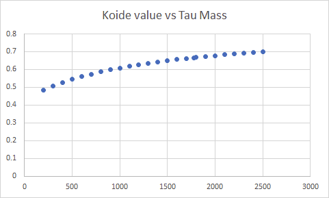

Further, here's what the Koide rtatio looks like vs. Tau lepton mass. It's close to 2/3? How shocking!
  • Haha
Likes vanhees71
It's only that close to 2/3 for 0.25 MeV in the 2300 MeV range you plotted.
The relation was proposed when the best tau mass estimate had an uncertainty of +3-4 MeV. That has shrunk to 0.12 MeV and the ratio is still 2/3 within the uncertainties. That's using the PDG average, this recent Belle II measurement will shrink uncertainties further and move the best fit ratio even closer to 2/3.
I don't say it has to be true, but if not then it is an exceptionally well-working coincidence.
