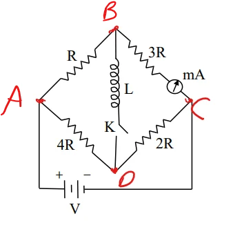

Find the current through the inductor as a function of time, if the switch is closed at t=0.
V= Ldi/dt
this is the circuit given. I have marked points A,B C and D.
First, my attempt is to find the time constant for the circuit. For this, my approach will be to remove all voltage sources and replace them with their internal resistance, so that I can find the equivalent resistance between B and D.

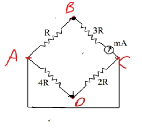

hence the modified circuit. now clearly,
$$V_A= V_C$$ as they are connected by a wire. So I think that the R and 3R are in parallel, with the 4R and 2R parallel combination being in series with the latter.
Hence, $$R_{eq}= R.3R/4R +4R.2R/6R =25R/12 $$
now time constant will be $$L/R_{eq}$$

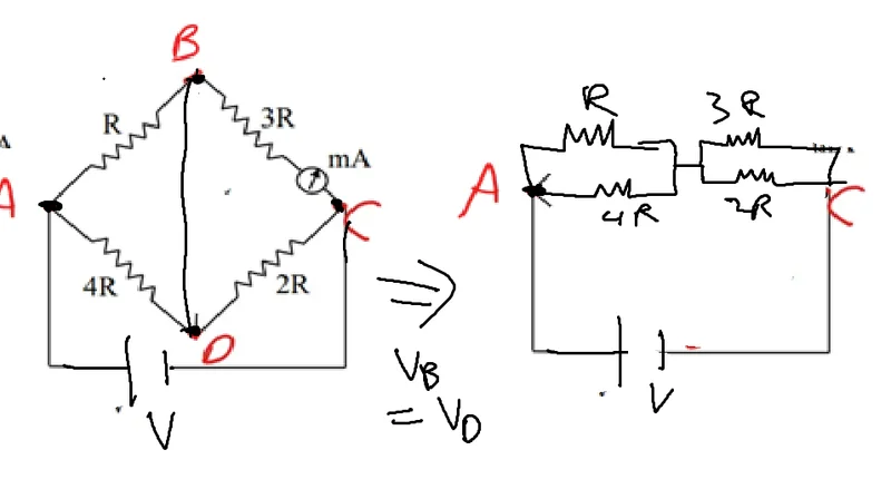

to find the current at steady state through the inductor, we replace the inductor with a plain wire.
hence we have the arrangement in the figure.
the current in the circuit will be
$$i= V/R_{eq}= V/2R$$
which will also be the current flowing through BD, and hence the inductor.

The current through the battery isn't the same as the inductor current, there are other paths too.
Hi @palaphys. IMO your overall method/logic looks ok – but you have made a mistake.
It looks like you are trying to apply a method which basically uses Thevenin's theorem. Do you recognise the name? Have you been taught this? You may want to read-up on it, or watch some YouTube videos about it.
You have removed the ‘load’ (the inductor between B and D) and correctly calculated the Thevenin resistance ##R_{Th}##. You call this ##R_{eq}##.
You have used this to correctly determine the time constant.
You have then short-circuited BD and tried to find the current through the short circuit since this corresponds to the steady-state current through the inductor. However, you have calculated this current incorrectly. You should think about why.

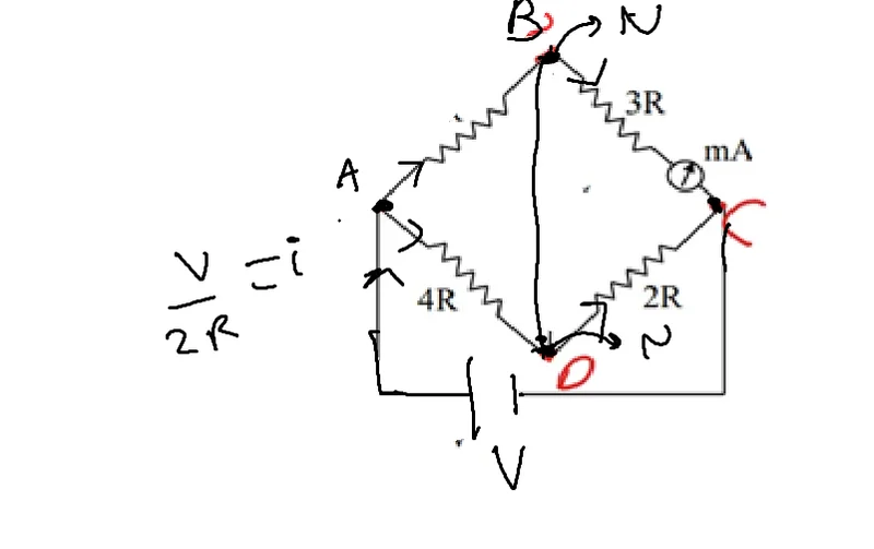

I feel @DaveE has highlighted my mistake. I have to admit I was initially unsure about the current through the inductor, so it was incorrect to assume that the current through the battery and inductor are the same.

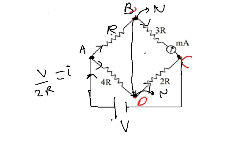

Hi @palaphys. First, note that you have used the same symbol, ##R_{eq}## to mean two different resistances. That’s a recipe for confusion!
The problem is fairly easy using Thevenin’s theorem but it sounds like you are not using that method in full. So I’m guessing that you are expected to do something like the following...
In your right-hand diagram, you correctly found the current through the cell to be ##\frac V {2R}##. (But you should have used a different name for the total resistance of this circuit, e.g. ##R’##.)
Using your right-hand digram you can now find the voltage across each resistor and the current through each. In fact you only need the currents through, say, ##R## and ##3R##.
Then, using the left-hand digram, if you apply Kirchhoff’s 1st law at point B you will get the required current through BD.
See how that goes.

Okay. I feel that I have identified my mistake.
Now, I have assumed that the potential at C is zero, and that at A is V. Also assumed that the potential at B and D are N.
Now applying KCL, we have:
##(V-N)/R + (V-N)/ 4R= V/2R##
on solving for N we have ##N= 3V/5##
Hence, the current through the resistance ##R## is ##2V/5R## , and the current through the resistance ##3R##is V/5R. This clearly indicates that a current equal to ##V/5R##flows through the branch with the inductor.
Hence, the maximum current through the inductor when it behaves like a plain wire will be
$$I_0= V/(5R) $$
as a result the current function is
$$i(t)= V/(5R)( 1-e^{-25Rt/12L} )$$
