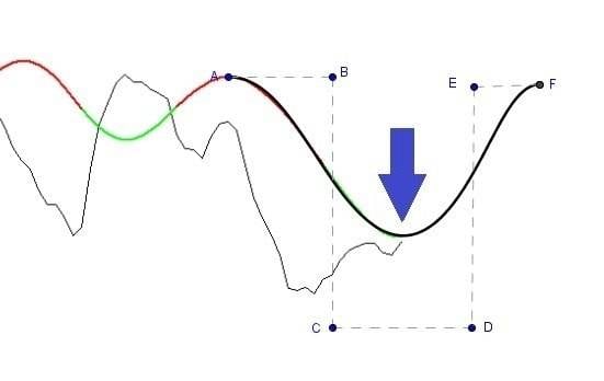

On a stationary, non-periodic signal (black) a smooth causal filter is calculated (green/red). It is sampled discretely (every distance unit of 1 on the X-axis). My goal is to find which "path" it is "travelling" on so I can extrapolate the current shape until it is completed (reaches a maximum/minimum: 1st derivative = 0), in real time: so at every point in time I assume the shape of the completed "path" and I want to measure the length between the previous turning point and the extrapolated turning point of this extrapolated curve:
I was playing around with a Geogebra script of a Bézier curve because dragging around the control points is visual and intuitive (for non-math guys like me) and it is easy to see where my current smooth movement would end if it were to continue "on the same path" it is currently on. I added some restrictions to my control polygon of my Bézier curve: 2 consecutive control points can only be on horizontal or vertical lines. In case of the image above, I used a Bézier curve of order 5, so it has 6 control points with the following restrictions:
  • A & B are on a horizontal line
  • B & C are on a vertical line
  • C & D are on a horizontal line
  • D & E are on a vertical line
  • E & F are on a horizontal line
So under these restrictions, at the blue arrow we assume the curve will continue via the dotted line to point F: so we start fitting the data from point A (the previous turning point) up to the blue arrow (a bit after the last turning point), and "extrapolate" further to F.

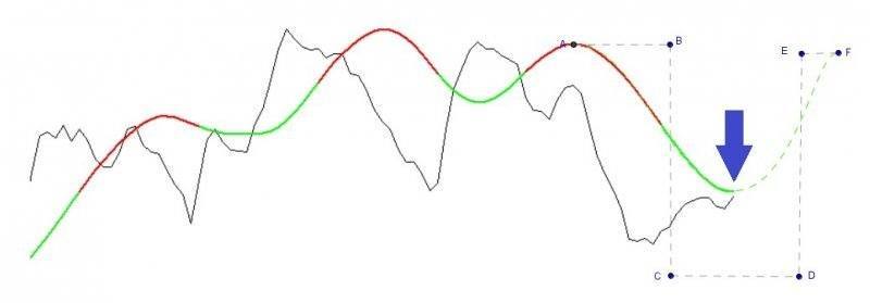

But then I realized that I don't need a parametric curve: I don't need an element of "speed" along the path (and all the headache that comes with that). I need something more simple. Should I just fit a polynomial
ax^5+bx^4+cx^3+dx^2+ex+f = 0
and then calculate where the slope of the tangent becomes 0 for points to the right of my blue arrow (to mimic that last control point F)? Or should I use a Bernstein polynomial to keep the same shape-properties as the Bézier, knowing that I only need y=f(x).

The first question that comes to my mind is to ask why you think that past history has any influence on the turning point (max or min) in the future? I certainly don't see any pattern. Some time series analysis might help to identify any relationship that would help you make a predictor. If time series analysis does not show a relationship, I think you may just be fooling yourself to make a predictor.
My goal is not to use this signal as a predictor on itself: the data is only stationary, not periodic. I try to get an estimate for the instantaneous frequency of the smooth curve. This I can further use as an input for other filters and models that are calculated on the original signal so I can make those adaptive. Instead of using a look-back window of constant length, I change it dynamically. When the extrapolated turning-point lies further to the right of the last observation, I make the look-back window longer, if the extrapolated turning-point is at a short distance, my window length (of the other models) decreases.

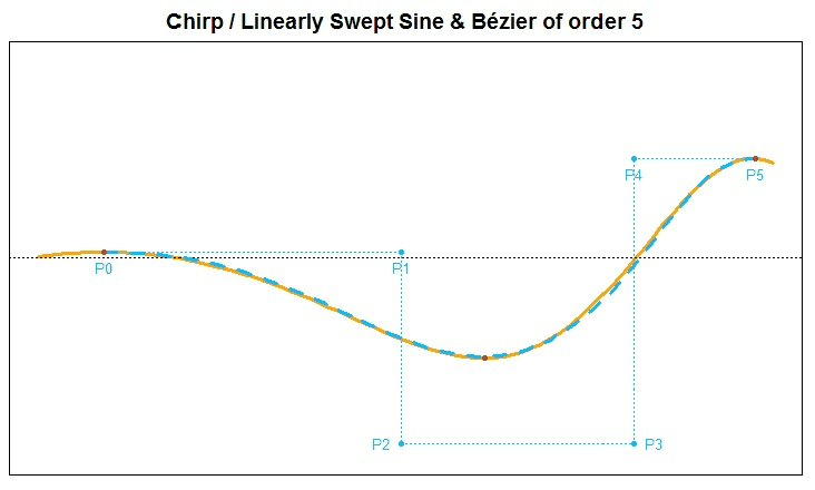

Something else I had in mind was this: the linearly swept sine / chirp: ( a sinusoidal wave that increases in frequency linearly over time):
Let me post some R-code of a linear chirp:
Code:
a<-1/100
b<-1/200
c<-1 #amplitude 1
d<-4
x<-1:80
output<-c*sin((pi/(b-a))*(((((x/d)*(b-a))+a)^2)-(a^2)))
plot(output,type="l",pch=20,lwd=3,col='orange',main="Chirp / Linearly Swept Sine & Bézier of order 5")
If I draw my Bézier curve of order 5 with the known restrictions on top of the linear chirp (from the first to the second to the last turning point), I see that they are equal: it is done manually, so there is some error on the estimation of the control points:
Maybe I could use the model of the linear chirp for the regression & extrapolation?

MisterH said:
I am afraid that for online analysis, the FFT suffers from edge effect.
Forgot to say, do a linear regression first and subtract that line. Then add it back at the end.
Likes MisterH
