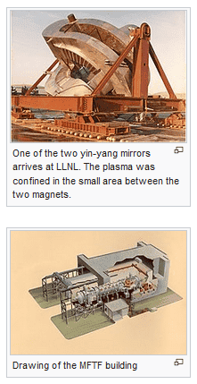

My idea is probably similar to the already researched "Mirror Fusion Test Facility", and from what I see in your answers, your research and development did not give good results.
My idea is that the "concentric cylindrical coils" push the plasma towards the center of the cylinder like two concentric particle accelerators, but I can't ensure that this is 100% effective in concentrating the plasma and preventing it from flowing towards the ends as I also see that It happened in the "Mirror Fusion Test Facility".
