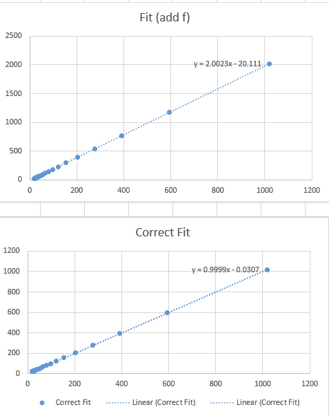

Hi,
I'm trying to come up with a section of an optics based physics lab designed for 2nd year Calc-based college students. Calc 2 is a co-req.
There are 2 labs that are intimately linked together. The first effectively revolves around taking ##d_i(d_o)## data from a lens, source and screen system, then plotting in excel.
I'm trying to come up with an intuitive way to linearize the data. Students tend to not get a lot of data analysis, particularly in early labs, so I'm trying to add this in while I have the opportunity.
The end goal is to get to the relation ##d_i = \frac{fd_o}{d_o-f}##.
My thoughts are this:
Give a little background, note that if I have some data that looks like a particular function, I can plot against that function to check to see if it matches, i.e. e^x vs. e^x is a line with slope 1 and intercept 0.
Give a few options for possible "general fits": 1/x, e^-x, maybe 1 or two more?
Student data should have both vertical and horizontal asymptotes at f. This rules out e^-x, as it only goes to inf at x=>-inf.
With 1/x hopefully chosen, now we can fix the vertical asymptote by shifting from x-> x-f.
We now have ##\frac{1}{x-f}##, which has a vertical asymptote at f, but horizontal at 0.
Now here is a fork that I'm trying to remedy.
Occam's razor suggests that we should add f, which will fix the horizontal asymptote. It does. So does multiplying by f*x, i.e. ##\frac{fx}{x-f}##. If I follow Occam's razor and plot this function vs. my data, I get a very linear graph with a slope of 2 and y intercept of around -f. This implies that we can add f and multiply by 1/2 to get a good fit. It works, really well, actually. All the data points are within around a centimeter of using the correct fit.
I will attach all 3 graphs with the equations. I added in a bit of random variance to the ##d_i## measurements, so they are all +/- 1cm.
I would really like to end this section by arriving at ##1/f = 1/d_o + 1/d_i##
Any ideas on adjustments that could be made, or why we can/should argue around the "add f" method?
The 3 labeled graphs are as follows:
Correct Fit = ##d_i## vs ##\frac{fd_o}{d_o-f}## which can be arranged into the standard thin lens equation.
Add f = ##d_i## vs ##\frac{1}{d_o-f} + f##
Fix again = ##d_i## vs ##\frac{1}{2}(\frac{1}{d_o-f} + 2f)## , I added f again to fix the intercept, then multiplied by 1/2 to fix the slope.
If need be, I can attach the spreadsheet.
Any ideas or suggestions are appreciated.
What I find really interesting is that the correct fit and fix again trendlines are both very convincing, although correct is objectively ever so slightly better, and over a large data range at that. Horizontal axis is fit values, vertical is simulated data with random variance.
All plots use the same data.

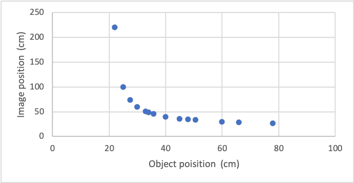

If the latter, I asked myself what would I do if I were presented with a list of dependent and independent variables pairs and asked to find the relationship between the two with the aid of an Excel sheet. I generated pairs ##(d_i,d_o)## using the thin lens equation and did my best to pretend that I forgot where they came from. I used ##f=20~##cm and no random variance. This how I proceeded
1. I first made a scatter plot to get an idea of what is going on (see below)
2. Clearly, there is an asymptote at 20 cm and one around 25 cm, but I pretended I didn't notice them. So I used the Excel fitting options in sequence Exponential, Linear, etc. nothing worked. Changing the linear axes to logarithmic didn't work either.

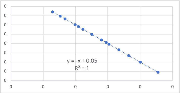

3. It dawned on me that I should consider investigating the asymptotic behavior both vertical and horizontal and plotted ##y=1/d_i## vs ##x=1/d_o##. Aha! A straight line which can be fitted by linear regression.
4. It follows from the fitted linear equation on the plot that ##\dfrac{1}{d_i}=-\dfrac{1}{d_o}+0.05.## This can be rewritten as
##\dfrac{1}{d_i}+\dfrac{1}{d_o}=0.05~(\text{cm}^1)## and it shouldn't be too hard to make the leap and wrie the constant on the right-hand side as a reciprocal, in this case ##\dfrac{1}{20~(\text{cm})}.##
I really don't see why you bother with all that stuff about the horizontal asymptote, Occam's razor, etc.

I believe that you're idea of plotting 1/x vs 1/y is pretty clever.
Does that seem more obvious than saying, "This looks like 1/x, but shifted to the right and up"?
To me, the shifted graph feels more intuitive, but again, that's to me.
I think I have resolved the issue. I looked closer at my formulae in excel. For the "add f" function, I went through and cleaned it up to get ##\frac{1+fd_o - f^2}{d_o-f}##. However, when plugging it into excel, I typed ##+f^2##. Doing so and adding f again (then multiplying by 1/2) gives ##\frac{1}{2(d_o-f)} + \frac{fd_o}{d_o-f}##, and the first term is always small relative to the 2nd, which is why the graphs were so close, which was the source of my confusion and frustration.
My apologies.
Now the curve for doing it with +f looks significantly different to the data.
My suggestion would be to also get the students to understand and verify that light rays can be reversed. If they perform a measurement with the source at ##d_i## of a previous measurement, the image will appear at ##d_o## of that measurement. This interchangeability of variables points to a symmetric treatment treatment of ##d_o## and ##d_i##, i.e. if you plot 1/x on one axis, you should plot 1/y on the other because the axes are interchangeable as far the underlying equation is concerned.
Thank you for your compliment but my "clever" idea follows from the symmetry of the problem.
I still do not understand what this "add f" is all about. It looks unjustified to me and will likely confuse the students.
Adding f isn't the way to go about it. However, I think most students will be inclined to try that first.
I want this to have less "hand-holding" rather than more.
When you have ##1/{d_o-f}##, you have a general shape of the graph, and the correct asymptote at ##d_o = f##, however the incorrect asymptote at ##d_i = 0##. The way to adjust the function such that you get the asymptote and also the lens equation is to multiply by ##fd_o \to \frac{fd_o}{d_o-f}= d_i##. Strictly looking at the asymptotes, however, you can also add f, so ##1/(d_o-f) +f## which will give you both correct asymptotes. When making a plot of this model vs. the data, you end up with a fit that doesn't really match the data.
