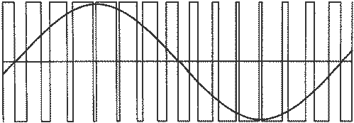

So I am searching the Internet for how the Solar inverters work. Most schemes that I come across have an H-bridge with some sort of transistors. Now how I understand the transistors are controlled by an oscillator and bridge itself then converts DC current to AC current (though a square wave one).
Is this correct so far? Also, how do they get a pure sine wave from a square wave? By using inductors?
Yes, you are right.
The output from the transistor bridge is a rectangular wave, where the relation between high-voltage-time and low-voltage-time is varied. It is called a pwm-signal ( pulse-width-modulated signal ):
In this way the mean voltage in the output signal can be controlled, and filtering the ouput current through an inductor, it will become sinusoidal. If the net-frequency is 50Hz, the rectangular signal could be clocked at say 16kHz.
