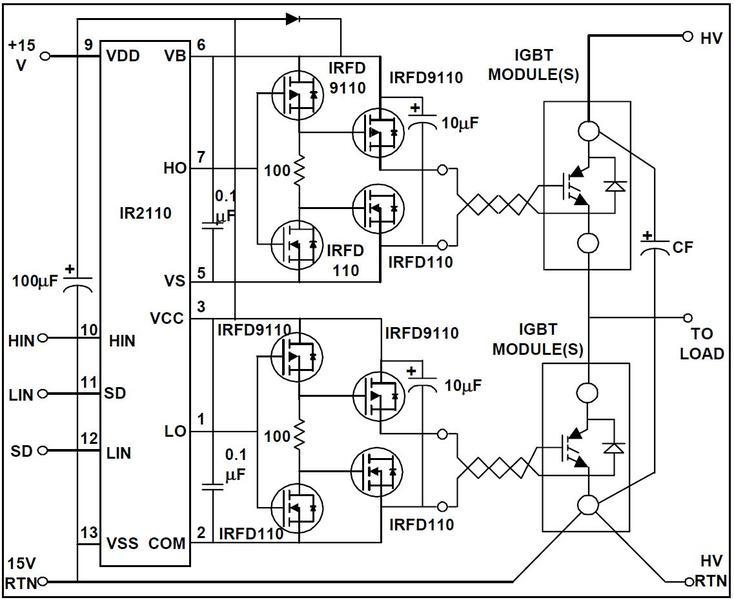

To date, we've designed, built and tested a low power gate driver circuit similar (almost identical) to the one shown in the figure below. The end goal is to use such a circuit to drive a Power MOSFET Module for an electric motorcycle.

According to the application note for our gate driver, the power buffers in the schematic shown above (i.e. the circuitry shown to the right of the IR2110) are needed to provide a higher gate drive current and lower gate drive impedance than what a typical gate driver IC can provide. (Application note is attached below)
They mention that the one shown in the figure above is capable of providing 8A peak output current, which is sufficient for driving Power Modules. (We are using a MOSFET power module, I've attached its data sheet below)
So does this imply that the 12V(or 15V) output from DC-DC Converter (i.e. VCC = 12V or 15V) must be capable of supplying 8A peak output current? The current needed to the drive the gate must be supplied by VCC, right? Or does the power buffer somehow amplify or boost the current?
No, in proper design circuit this extra current needed for driver should be supply by a "big" capacitor. In your case it is a bootstrap calculator. Vcc current will be equal to the average current.

So are the decoupling capacitors for the high side switch also functioning as the bootstrap capacitor? Or is a separate bootstrap capacitor needed?
Also, what is the purpose of the leftmost 100uF capacitor? It seems to be connected between Vcc and Vss, but I'm not sure what's there for.
Its looks like this 10uF act as a bootstrap capacitor for high side also.
This capacitor "provide a current" for IRF210 and for this 10uF caps also.
Isn't the 100uF used to stablize the VCC supply, not necessarily supply current like the decoupling capacitors?
It's all depend on the point of view. This capacitor don't serve only one role.
Also this circuit looks strange, do you really need all this mosfet do drive a singe IGTB?
