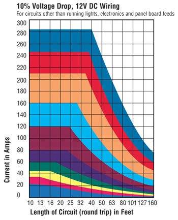

Project : a solar panel powered LED light (with built-in storage battery) with the house facing north (in Canada).

: In the beginning I thought the solar panel would work with ambient light or whatever light is available, but obviously it didn't. So now I am thinking of moving the solar panel to the backyard (south facing) to get solar powered to charge up the battery. I am afraid that just getting an extension DC power cable is not the solution since it is over a long distance of over 60 ft'. Am I right? In order to make this idea work, what gauge of cable do I need? Do I need to up the voltage at the source and down again at the light using transformers? or convert it to AC? I am no electrical engineer and my knowledge of electronics is at high school level. Please give me ideas and solutions with this project if you can, much appreciated!

You need to figure out how much voltage and current the light needs and the size (gauge) of the wire. Then use the following chart.
As a guess, your light will probably work OK with the longer wire because an LED flood light will need only 1 amp or so. If you buy additional wire, get 14 or 12 guage.
The colors in the graph above correspond to the following wire sizes.
Likes ChuckyMho and meBigGuy
So that chart says that you would get a 10% voltage drop if you ran 10 amps for 40ft (power and ground) through 14ga wire (bottom of the lower red band)
Yes, that's correct, 10% of 12 volts, or a 1.2 volt drop. If the voltage is higher than 12 v, then 1.2 v is less than 10%.
But I'm guessing that the light needs 1 amp or less, especially if the light is LED. There should be a nameplate on the light someplace to tell you.
