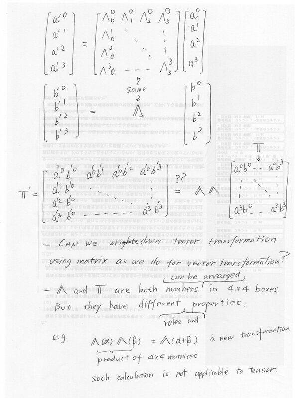

Say vectors are transformed from coordinate system S to S' as
[tex]a'^\mu=\Lambda^\mu_\xi a^\xi[/tex]
[tex]b'^\nu=\Lambda^\nu_\gamma b^\gamma[/tex]
The product is
[tex]a'^\mu b'^\nu= \Lambda^\mu_\xi \Lambda^\nu_\gamma a^\xi b^\gamma[/tex]
If we write ##T^{\mu\nu}=a^\mu b^\nu##
[tex]T'^{\mu\nu}= \Lambda^\mu_\xi \Lambda^\nu_\gamma T^{\xi \gamma}[/tex]
Not only these products of vector components but anything that follows this transformation rule in coordinate system change, is tensor. For the third rank or order tensor we make triple product, for the fourth quatro and so on.
Example: Angular momentum tensor for a particle
[tex]M^{\mu\nu}=\frac{1}{2}(x^\mu p^\nu - p^\mu x^\nu)[/tex]
Though substract for antisymmetrization is applied, it clearly meets the above transformation rule. The three non zero distinguished numbers from components of ##\mu,\nu##=1,2,3 give angular momentum.
Addendum attached thought on the difference of ##\Lambda^\mu_\nu## and ##a'^\mu b'^\nu##.

I found a video that has some features of a definition in it, although is has a lot to say about examples. By the end you will see the features:
Transformation rules must be explicitly stated in a formal definition of a second rand tensor or any tensor.Jim Adrian
