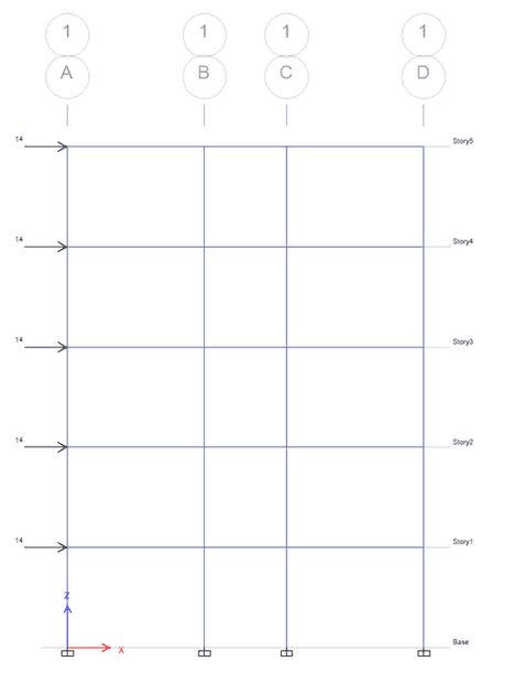

I am working on approximate methods to solve for member forces for a multi-storey rigid frame, such as below:
Firstly, I am trying to compute the shears in the columns, and to do this I am using the the shear rigidity given by Stafford-smith and Coull (1991), Tall Building Structures, Analysis and design.

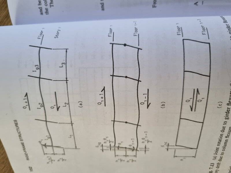

EDIT: Important information that needs to be added.
The book my Stafford-smith and Coull provide the following attached diagrams:
The first diagram is the joint rotation due to beam flexure, the second is storey drift due to beam flexure and third is storey drift due to column flexure.

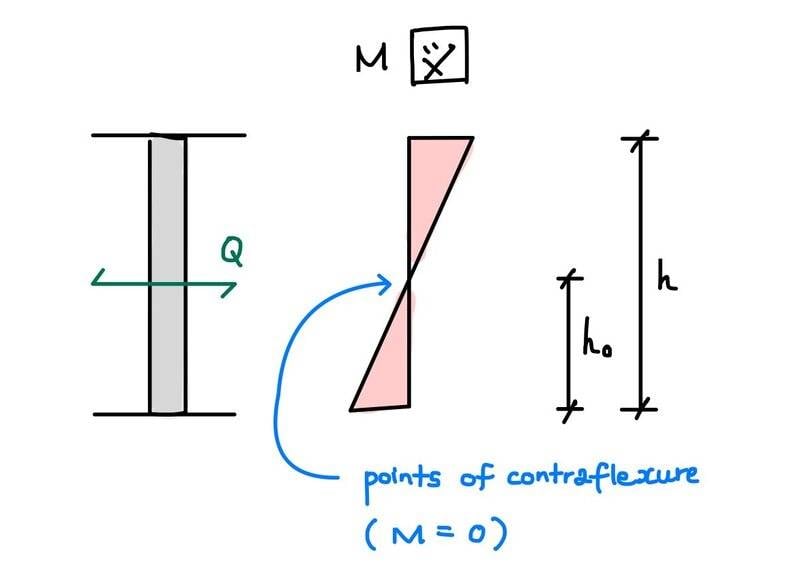

Good afternoon! From the course of hydraulics, which I studied 22 years ago, I remember for sure that the full pressure of the water acts on the dam at 2/3 of the depth. It seems to me that your model may have similarities to a dam. Perhaps it makes sense to study dam calculation methods in order to understand by analogy where the ratio of 2/3 height (depth) in the equations comes from. I also suggest that you use special engineering programs to calculate efforts, for example, SolidWorks.
Hi there, Ivan, thank you for your response.
I believe that for the case of the dam where the load from the water is in the form of a triangular UDL (as shown in your diagram), the centroid of the triangular loading acts at ## \frac{2}{3} ## the depth. In my problem its the point of contraflexure that acts ## \frac{2}{3} ## from the base (that is contraflexure, where the bending moments equals zero). See, the following diagram:
In the case of the bottom storey columns ## ho = \frac{2}{3} ##
I'm not sure if the shear rigidity of my rigid frame behaves the same as a dam. The dam I think would act a giant cantilever with a varying second moment of area.
