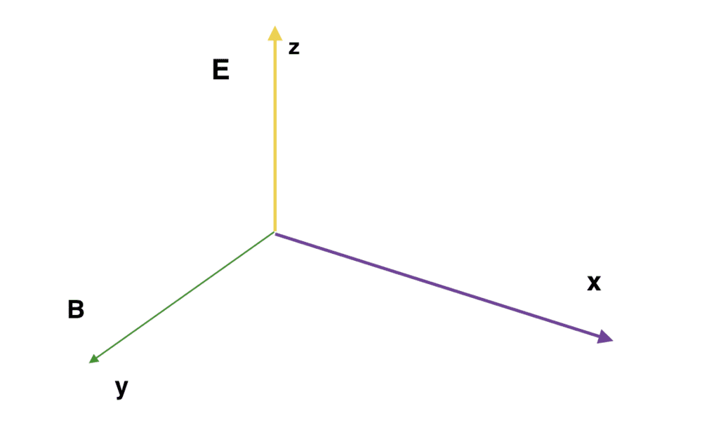

Imagine that we have an electromagnetic wave or light propagating in [itex]x[/itex] direction, and [itex]\mathbf{E}[/itex] is oscillating in [itex]z[/itex] direction and [itex] \mathbf{B}[/itex] in [itex]y[/itex] direction. The picture looks something like this
Now, if there exists a charged particle [itex] q [/itex] on the xx axis at rest, then our B field can't do anything, but the electric field E will pull it upwards and as soon as it starts moving the magnetic field B comes into action and it goes like this $$ \mathbf{F_{mag}} = q (\mathbf{v} \times \mathbf{B}) $$ Since, E is going to cause a velocity in [itex] z [/itex] direction i.e. perpendicular to magnetic field B , therefore $$ F_{mag} = q~v~B$$
$$ F_{mag} = q~v~\frac{E}{c}$$
$$F_{mag} = v~\frac{(qE)}{c}$$
$$ F_{mag} = \frac{F_{electric}~v}{c}$$
$$ F_{mag} = \frac{dW_{electric}/dt}{c}$$ and after doing this he writes
That light carries energy we already know. We now understand that it also carries momentum, and further, that the momentum carried is always 1/c times the energy
After considering this line, I thought the last equation could be written as $$ \frac{dp}{dt} = \frac{1}{c} ~ \frac{dW}{dt}$$
$$ dp = \frac{dW}{c} $$
$$ p= \frac{E}{c}$$
But I find this thing sloppy because when I wrote [itex]F_{mag} = \frac{dp}{dt}[/itex] it was for the particle, that is force applied on the particle was equated with the rate of change of particle's momentum and not the light's momentum and similarly [itex]dW[/itex] is the energy imparted to the particle and not the energy of light itself.
So, these are my problems. I earnestly request you to please help me over here.

Use conservation of momentum. The momentum the particle gets must come from the radiation. Same for the energy.
It is not completely free of hand-waving, because you can also ask if the motion of the particle will emit new radiation on its own, but that is a smaller effect.
But that should involve complete absorption of light then only we can call the charged particle’s momentum and energy to be equal to that of light, isn’t ?

It doesn't matter how much energy transferred, as long as energy and momentum are transferred at a rate of pc=E. The remaining light will have the same energy-momentum relation as before, that is only possible if pc=E applies to the overall light as well.
