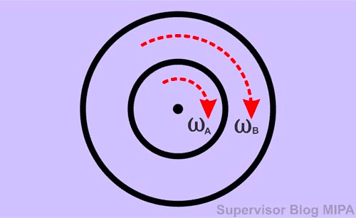

  1. Two wheels at the same axle
  2. Two wheels intersected in parallel (meshed)
  3. Two wheels connected by a belt
We will examine each cases above on smooth (non-teethed) wheels first.
1. At the same axle
Figure 1 (source: fisikabc.com) shows two wheels connected to the same axle. Since both ##A## and ##B## are on same center, they have same angular accelleration:
$$\begin{align}
\omega_A & = \omega_B \nonumber \\
\frac {v_A} {r_A} & = \frac {v_B} {r_B} ~ (1)\nonumber
\end{align}$$

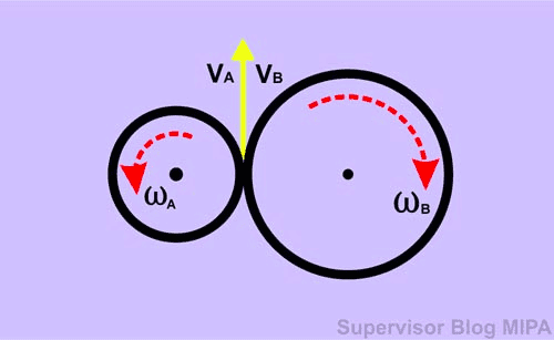

2. Intersected in Parallel
Figure 2 (source: fisikabc.com) show two wheels intersected each other in parallel. When wheel ##A## rotated counter-clockwise, wheel ##B## rotated clockwise, and vice versa. At the intersection point between two wheels, linear velocity of both wheels directed at the same direction, so:
$$\begin{align}
v_A & = v_B \nonumber \\
\omega_A \cdot r_A &= \omega_B \cdot r_B ~ (2)\nonumber
\end{align}$$

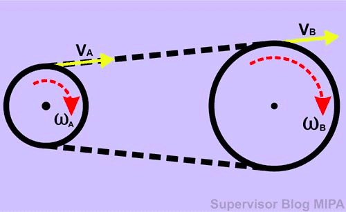

3. Connected by Belt
Figure 3 (source: fisikabc.com) shows two wheels connected by a belt. As wheel ##B## rotated, the belt rotated wheel ##A## at the same linear velocity direction as wheel ##B##. Thus the formula is same as when both wheels intersected directly (2).

When you say ##\dfrac{2\pi r_A}{t}=\dfrac{2\pi r_B}{t}##, you are assuming that the two geared wheels have the same radius. This means that ##N_A=N_B## and ##\omega_A=\omega_B##. Not an interesting case. What you want to say is that the number of teeth per unit length in A must be the same as in B otherwise the teeth will not mesh.
Likes sophiecentaur
What I mean was cancelling ##\frac {2\pi} {t}## from both sides, so ##r_A## is not necessarily same as ##r_B##.
Since I can't edit my first post here, let me update derivation of (3).
From equation (2), we divide each sides by number of teeth of each wheels:
$$\begin{align}
\omega_A \cdot r_A &= \omega_B \cdot r_B \nonumber \\
\frac {\omega_A \cdot r_A} {N_A} &= \frac {\omega_B \cdot r_B} {N_B} \nonumber \\
\dfrac {\dfrac {2 \cdot \pi \cdot r_A} {t}} {N_A} &= \dfrac {\dfrac {2 \cdot \pi \cdot r_B} {t}} {N_B} \nonumber \\
\frac {r_A} {N_A} &= \frac {r_B} {n_B} ~(\text {cancel} ~ \dfrac {2 \cdot \pi} {t} ~ \text {on both sides}) \nonumber \\
r_A \cdot N_B &= r_B \cdot N_A \nonumber \\
\frac {r_A} {r_B} &= \frac {N_A} {N_B} ~ (3) \nonumber \\
\end{align}$$

Not better. Look at the second equation. You get it from the first by dividing the left side by ##N_A## and the right side by ##N_B##. That's OK as long as ##N_A=N_B## which means that equation (3) says ##\dfrac{r_A}{r_B}=1##. You have all the pieces but you are not sure how to put them together and you are going around in circles. You did not pay attention to what I suggested in post #2: What you want to say is that the number of teeth per unit length in A must be the same as in B otherwise the teeth will not mesh. Start from there.
